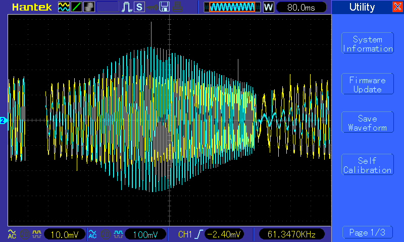

This report looks at the output and phase (by eye) of the piezo (now with elegant seismic mass added) and compares it to a NEW reference point - the output (pin 1) of op amp IC104 (1/2) - which I see as going into the mixer op amp. The 'top' leg of the mixer would be this signal (IC104 pin 1 output), the bottom leg of the input to the mixer is where I would bring in the piezo output.
You know those braided wires in a cheap pair of headphones? - very tiny - I took an individual wire from that strand, pretty close to the diameter of a hair and soldered it to the output (pin 1) of op amp IC104 (1/2) so I could get a probe on it and look at output as a function of frequency (20-120 hz). I compare this to the output of a piezo signal conditioned by a summing / buffering amp to an integrator / bass boost circuit (same noisy breadboard circuit one I have been using and similar to one shown above in Steph_tsf's schematic - except I have a 33k resistor between 1st and second op amp.
I was going to just take voltage readings for both as a function of frequency but that was too time consuming / tedious so I tried to capture a sweep - I captured the essence -
Here are my observations -
1. the output from IC104 (YELLOW trace) rises a bit from 20-45, then back down..not too much maybe 30%.
2.the phase of the piezo (through the circuit) is in phase with IC104 from about 20-30 Hz, the slowly shifting, being about 180 degrees out of phase around 110 Hz.
3. The amplitude of the piezo output, as predicted rises from 20-about 60Hz, then tapers back down.
4. I dont see what the integrator / bass boost op am circuit is gaining me other than shifting the phase and adding noise.
See attached simultaneous sweep - look close you can see in phase waves at the beginning of sweep (20 Hz) and change in amplitude (mostly of piezo (BLUE trace) and phase with higher frequencies.
Hombre, this sort of sweep looks pretty, but is completely missing the phase information we need. It's also missing all the higher frequency data - the stock low-pass in the Sony electronics is preventing you from measuring all the way up to 5 kHz or so, which is where all the bad stuff (cone breakup, piezo sensor resonances, etc) hides.

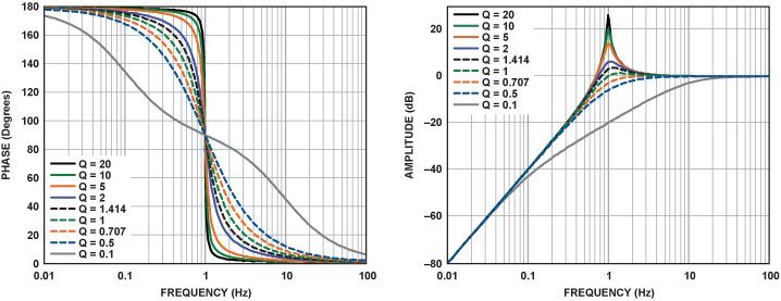

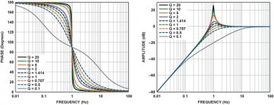

Let me start by attaching an image that will show you what it is you/we actually need from your woofer-piezo measurement. I grabbed this image off the 'Net; it shows gain and phase plots for a generic second-order high pass filter of varying Q. When you get a proper gain/phase plot of your woofer/piezo system, it will look a lot like one of the low-Q plots in this image.
-Gnobuddy

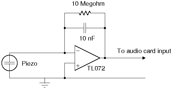

As seen in the previous diagram, you must have a proper piezo amplifier to get any kind of usable data. I quickly designed one for you, and here's the schematic.
I'm not sure what the capacitance of the piezo you are actually using is - so I designed this charge amplifier to work with any of them, even the 2nF one. It won't be the ideal design, but at least you can get some usable data with it.
The opamp must be JFET or MOSFET input; a good old TL072 (or rather, half of one!) is perfect for the job. I haven't shown power connections - you'll need the usual +/- 15 volts DC or so, and the usual filter and stability caps near the opamp power pins.

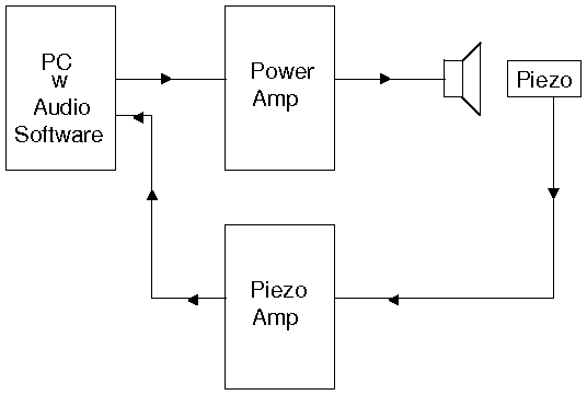

Now, here's a block diagram showing how you can get proper gain/phase sweep data.
For the sake of completeness, your diagram needs to represent the two audio input along with the audio output, and also the loop-back cable that is required inside the "PC with audio software". Otherwise, you can't truly measure the phase.

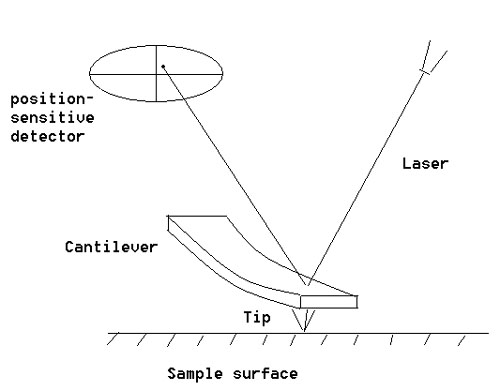

Here is my back up to my back up MFB plan - based on the atomic force microscope (AFM). AFMs can measure the vertical and lateral deflections of the cantilever moving over a surface by using the optical lever. The optical lever operates by reflecting a laser beam off the cantilever. The reflected laser beam strikes a position-sensitive photo-detector. The differences between the segments of photo-detector of signals indicate the position of the laser spot on the detector and thus the angular deflections of the cantilever.
I figure these must be similar technologies now available for measuring larger movements / displacements etc. so I searched and found this. I figure if a person really got desperate, this could work very well for measuring woofer displacement / velocity / acceleration, and obviate some piezo problems...seems the specs are conducive to measuring woofer motion...Only about $1100 each. :(

..the piezo amplifier you are recommending is a "charge-amplifier".
Yes, I know, I designed it! :)
Put your finger on the piezo sensor, or on the 10 meg ohm feedback resistor, and you will see brutal parasitic waveforms,
And if you beat it with a hammer, then the circuit will break and fall apart. :eek:
The solution is quite simple, don't beat it with a hammer, and don't poke it with your finger, either! :D
The reality is that a charge-mode amplifier like this has virtually zero input impedance, making it much less sensitive to noise, hum, and interference pick up. The high-Z approach you suggest, on the other hand, has severe problems in this area.
I speak from my personal experience - I tried both high-Z and charge-mode piezo preamps, and the charge-mode one gave me much better results.
In fact, the high-Z one would produce lots of hum and buzz if I merely moved my hand near the piezo. The charge-mode one was dead-quiet in the same circumstances.
If you happen to be using a piezo with rather high capacitance, the high-Z approach becomes more practical, as you don't need such an extremely high Z to make it work over the necessary bandwidth.
Your proposed "charge-amplifier" piezo preamplifier is more ambitious, as it parallels a 10 meg resistor on a 10 nF capacitor as local feedback.

By the way, the "charge-amplifier" piezo preamplifier is of inverting nature. Please re-orient or re-wire the sensor polarity accordingly.
For piezo discs of the sort I used, I found it best to keep the big brass disc grounded, for minimum hum and noise pickup. That fixes your piezo polarity once and for all.
However, it is trivially easy to reverse the wires from the amp to the woofer! :)

The piezo I was using is 18nF, but I have several piezos with a range of capacitance up to 48 nF I could use.
That makes the charge-mode preamp a little less extreme, you can replace the 10 nF cap with a capacitor roughly the same size as your piezo capacitance. For example, 22nF with your 18 nF piezo, or 47 nF with your 48 nF piezo.
If you do this, you can also reduce the 10M resistor proportionally. For example, if you replaced the 10 nF cap with a 47 nF one, you've just increased the capacitance five-fold, so you can decrease the 10M resistor by the same factor; 2.2M will be close enough.
