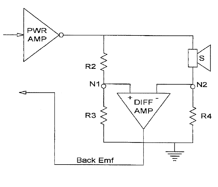

Here we go, using 2.2 Ohm resistor connected to a 15-inch, 8 Ohm driver in a 6 cu ft sealed box.BTW, in 5 minutes, anybody can eyeball their speaker error - no mic needed. Just connect a small resistor (.5 or 1 Ohm) to your speaker ground-side terminal and do an REW sweep of the electric signal. It will also reveal distortion and your speaker resonances will be obvious. And you may even see the VC inductance show up at higher frequencies.
Simple as that. You are looking at your rudimentary VC MFB signal
The first chart shows the signal to the speaker. Pretty flat considering it is a quite low voltage signal after passing through a gazillion junctions, a Behringer DSP, a 1975 JVC receiver I bought at the Salvation Army for $20 and other digital boxes between John Mulcahy's house and this picture*. Distortion, noise, and hum with my long alligator clips and going back over those gazillion junctions clocks in around 55 dB, as shown by the THD black trace. The other traces are 2nd and 4rd harmonic.
The second chart shows the signal at the top end of the 2.2 Ohm series resistor. Since the driver is adding its own personality and fluctuating back-EMF (fluctuating due to distortion), that is reflected in the voltage across the resistor. THD is a lot more, maybe like -30dB, but I don't know what that really means quantitatively or in terms of what could be accomplished with MF.
The third chart compares the two runs and shows where MF would be applied if you used this crude method. Where the resistor signal is low (because the excessive/distorted moving driver grabs more voltage to itself), you would be cutting the signal to the speaker. For example, at 50 Hz where the speaker resonance is too loud. Where the driver is balking (like the band below resonance), you'd add more power (without MF, you'd be fooling with EQ, a very blunt tool in real-world rooms).
At the right end, you can see the driver's inductance is adding to its impedance and so the voltage across the resistor is lower. You wouldn't be compensating for that in any simple way, but I'm just illustrating the point for readers.
Yup, simple as that.
Using a Wheatstone Bridge instead of a simple series resistor would magnify the sensitivity of the sensor but then you'd have circuit grounding issues to fuss with and still have various-sized shortcomings of VC MF.
Ben

Ben,Here we go, using 2.2 Ohm resistor connected to a 15-inch, 8 Ohm driver in a 6 cu ft sealed box.
The first chart shows the signal to the speaker. Pretty flat considering it is a quite low voltage signal after passing through a gazillion junctions...Distortion, noise, and hum with my long alligator clips and going back over those gazillion junctions clocks in around 55 dB, as shown by the THD black trace. The other traces are 2nd and 4rd harmonic.

The purpose for posting the charts was to encourage other people to discover the errors and the error signals lurking in their speakers. For basic series resistor or Wheatstone Bridge VC feedback, you'd likely not want more than .5 Ohm sitting there.Ben,

A great difficulty is the presence of a not-EMF signal from the extracted voltage, that is what is due to the part of the impedance of the driver which is not related to the movement of the voice coil in the gap. It needs compensation which can only be very approximative because the voice coil presents :
- a value of inductance which is variable with the frequency and with its position in the gap
- a value of resistance which is variable with frequency, increasing at high frequencies.
These facts seems to have limited the amount of feedback which can be applied to the Wheatstone based servo-systems to 12 dB.
