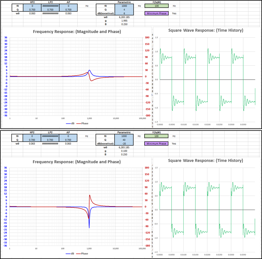

We're talking about MF woofers... so a very limited bandwidth.Ability to play square waves
Square - waves or something close will never be fed into those speakers in reality. The HF components in such a signal are also absolutely irrelevant. Besides, phase relations and rise times, in my opinion are better established with alternative measuring methods.
Squarewaves are nice for rise time fetishists building amplifiers.

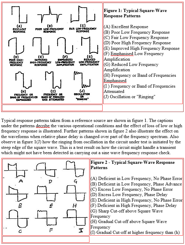

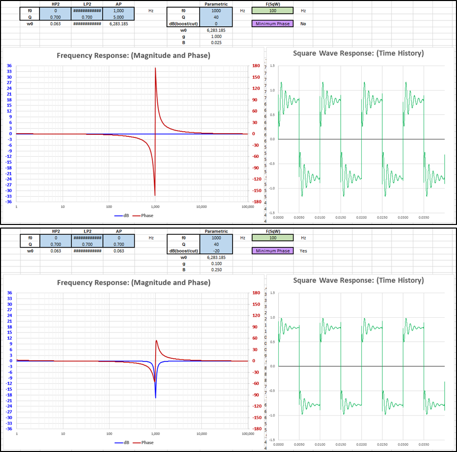

No particular relevance other than to illustrate the effect of phase on a simple waveform. The OP had stated that MFB would lead to perfect waveform reproduction. The plots were simply to illustrate this is not the case, and that linear phase is required if that is a goal. Some people who have experimented with linear phase say that it improves the impact and perception of bass transients. There are several threads on this topic in the Multi-Way forum.What's the relevance of squarewaves in relation to musical reproduction?
Exactly, this was the point of the second attachment. Send a square wave through a bandwidth limited device like a subwoofer and you get mostly the fundamental tone sine wave.We're talking about MF woofers... so a very limited bandwidth.
Ok. I'll get a cleaned up version posted later this week.i'd like the spreadsheet Please, it sounds very handy
Considering discussions here, maybe I'll add a plot of group delay as well.
