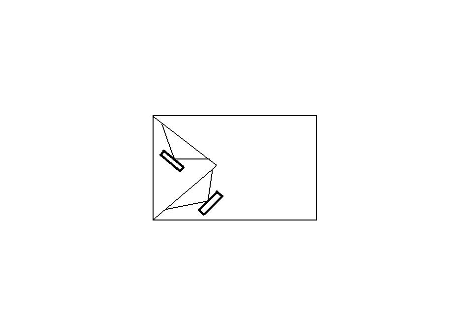

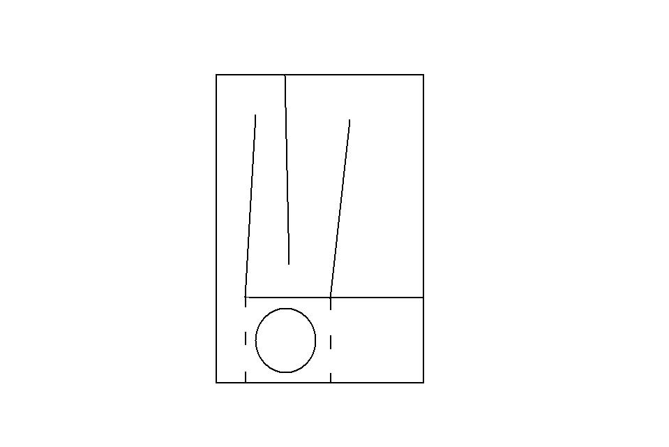

Anyway, in my free time when I'm not harrassing JLH I'm doing some modelling with HR to try to figure out what I'm doing without having to make random changes and see what happens. My inspiration is the dts-20. I tried to copy that thing years ago with no software and it was bad. It's still my tapped horn reference, so I'm still hoping to understand it better.
DTS-20 characteristics (IIRC, I lost the internal pics and can't find them) -
- very high throat:mouth ratio, probably more than 1:10
- very long path length, maybe 5.5m or so
- driver taps into the line at the very beginning, and the other (backside) tap is buried quite a way from the mouth - those tap locations seem to be common and key to all the danley designs I've seen inside
- gently rising response, due to tuning the horn about 1 octave below driver fs
So I tried to design something based on my driver that incorporates all those characteristics and hopefully not need extra inductance. The following design is not optomized, this one is a bit trickier to optomize than all of the previous examples I posted.
very low tuned tapped horn, 110L, 43w
I was able to get the slightly rising smooth(ish) response without extra inductance but at 110L size is becoming a really big issue here. Also remember all my models are done in 1/8 space (corner loaded) so to get decent max spl about 8 of these would be needed. At only 43w to reach xmax, thermal compression is definitely no longer an issue.
I probably won't actually build anything this large, but it's a good excercise. It could be optomized further, and if an extra coil is used it could probably be made smaller. I could probably squeeze 1 or 2 db more out of it too if I play with it. Besides the size issue, this really needs to be run through akabak (where I'm clueless) to determine the optimal size and location of the internal spike killing resonators. If optomized with resonators however, this design would be good from 14 hz almost all the way up to 100 hz.

I'm still hoping for some in depth criticism on any or all models I've posted. The previous couple of comments are appreciated, but I'm hoping to have any or all of these designs critiqued as brutally and honestly as I did with JLH's model. Most of you have way more experience than me with modelling tapped horns.
I'll be the first to admit that it doesn't look like the previous large tapped horn model has much max spl output, but just to put it in perspective it's good to compare with a ported box, same driver, same (similar at least) tuning.
This does put things in perspective, this looks bleak at best. With a tuning this low, the ports are getting larger than the actual box part. Shown with 130w to reach xmax.
The big tapped horn in the previous post doesn't look quite as bad as it did without a ported reference, but it's still 4x larger.

Ok guys, at this point I've posted several design ideas for the tang band w6-1139 in the last couple of pages and asked several times for some concrete feedback. I'd really like to have an in depth technical conversation about possible tapped horns for this driver.
There's several things to consider when trying to pick a design obviously. Max spl vs frequency response vs bandwidth vs power required to reach xmax, and all those type of things. Pros and cons of using an extra coil. How important is it to have the driver feed the line right at the beginning? (As in all Danley designs I've seen and clearly depicted in the patent) Taper ratio vs cone destruction (if you increase the ratio but spl remains the same, is there any added risk?) And there's questions I haven't brought up yet, for example, where exactly do you place the spike absorbing resonators within the line? (See rubens tube explained in the following links - http://en.wikipedia.org/wiki/Rubens'_Tube or this http://www.physics.isu.edu/physdemos/waves/flamtube.htm or this www.youtube.com/watch?v=HpovwbPGEoo or this www.youtube.com/watch?v=VEiEBEadZFI for a very visual explanation of why the resonators have to be placed in exactly the right spot - and note that as with everything else, I could be very wrong about this notion)
On my own I can't answer some of these questions, and in particular, the placement of the resonators is going to require akabak, unless hornresp suddenly is able to calculate a resonator type offshoot from the main line, which I'm not expecting anytime soon or ever.
In other words, without help I'm stuck with limited bandwidth no matter what design I choose, so Volvotreter's horn is the best bet, until I learn akabak, which I never really wanted to do, and which will probably take a long time and make me very grumpy.
So this is the last time I'll ask, as I don't want to seem any more annoying than I already am. Does anyone want to discuss any of my designs or any of the questions I've asked above? Either here or privately, I don't care, pm me if you want. I can build and measure the results, so this conversation would not be a total waste of time on anyone's part. I'll probably end up building more than one design as well, so there could be some good info gained from this.

just a guy said:
I don't think you need to worry about that. After all these years I'm still struggling to keep up...
BUT
I really don't need ~14hz tuning and I also don't really want 8 110L subs in my small/medium size room.
These models of mine just keep getting bigger and bigger, and Volvotreter's tapped horn (without an extra inductor) is starting to look better and better all the time. It's not exactly smooth response, but the size vs spl ratio beats everything I've come up with by no small margin.
Some where on this thread I posted some stuff on my attempt at getting close to the DTS-20. And I did Ok all things considered.
Somehow I doubt that the DTS 20 has a compression ratio anywhere close to 10:1.
I shot for 3:1
