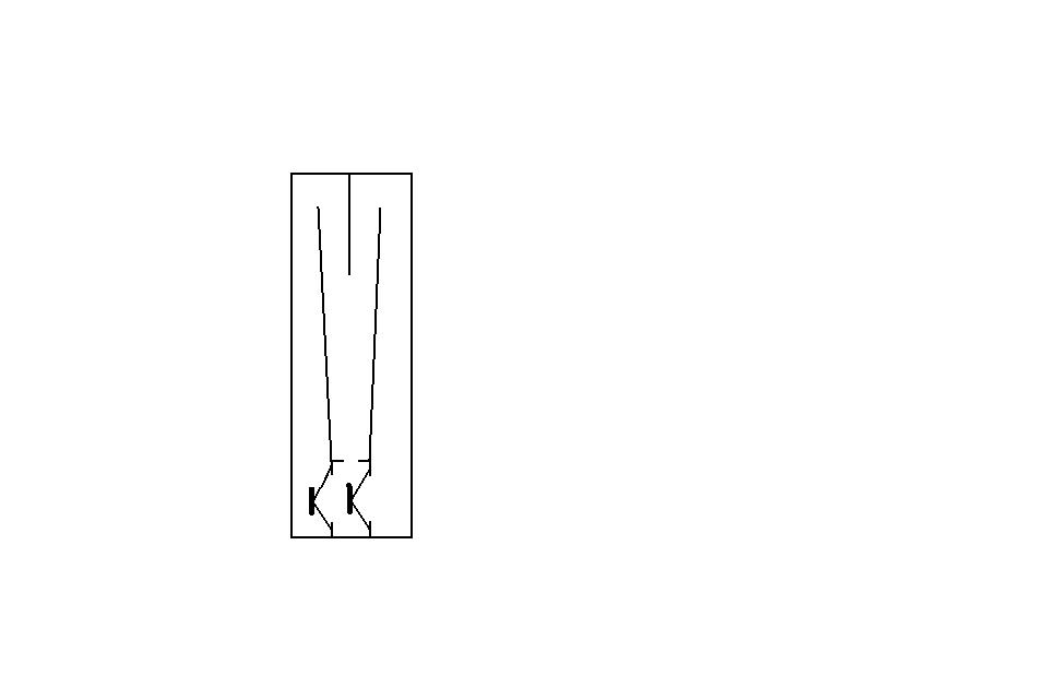

JLH, I took the numbers you posted on page 95 and ran them through hornresp. I am still using version 17.something of hornresp, it won't let me model more than a single driver so I just halved everything except length. Impressive physical size vs spl output ratio, but I noticed that you should be hitting xmax with about 100 watts per driver (200w combined) so I'm not sure how you're able to hit em with 600w (which is also way more than rated Pe).

The 600W input was on the 8PS21 dual tapped horn I built. I never released the details of the 8PS21 dual tapped horn to the forum. I think you are confusing the 8PS21 one with the W8-740 one.
When I tested the 600W into the 8PS21 tapped horn it was with music program. The 600W input probably occurred somewhere around 50Hz to 65Hz range. I knew the highest reading on my meter read 48.2Vrms into the 4 ohm load of the tapped horn. Therefore my testing was frequency independent. If I ever exceeded Xmax it was not audible. My educated guess is there was not enough low frequency content in the music program to exceed Xmax at 600W input.
The initial indications from my improved W8-740 dual tapped horn looks like it will be around 130L. I raised the tuning to 30Hz because I don’t need flat response to 20Hz due to room gain. Worst case for Xmax limited SPL should be around 117dB at any frequency in 2Pi space. What this means for me is 1 will be enough, but I’ll still end up with a stereo pair.
You are correct sir, I did not know you had more than one. Thanks for setting me straight.

JLH's TH does not have a compression chamber and is not a back loaded horn.
It is a dual driver TH with a high S1 value.
The slight difference is that he has reversed one of the drivers, physically and electrically, to make them work in push pull mode as he explained. This helping to reduce distortion, particularly at higher cone displacements.

JLH,
can you confirm that the mouth (exit) is at the left side of the drawing?
You sure about that? Go to the the previous page of this thread to see pics of JLH's tapped horn. It absolutely does have a compression chamber, and while names are largely semantics, it models the same as a blh.
Those drawings are difficult and tricky
But your question is interesting...making me think whether it would be good to have the mouth openings at both sides...to me it looks like it a natural option
Yep, a driver-in-mouth folded horn after Olson. For the typical simple end loaded TH I calc a variation of the BIB (AKA expanding TL).
GM
Those drivers might measureably be 30 or so cm from the mouth, but they are not 30 cm from the end of the line length, so whatever. I'm not sure the hornresp inputs accurately reflect the drawing, that's all.
