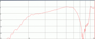

Peerless– on the 5th graph at www.diy.cowanaudio.com/th.html you got more deep bass with the 830515 than the 830500 - -did you prefer the ‘top end’ of the 830500?
Is the left hand vertical line on those graphs, 10 or 20 Hz?
G'day Rick
I didn't notice this until now, but those graphs are labeled incorrectly. The red trace is the 830500. Many people must have thought I was crazy preferring the brown trace! The red 830500 trace is very easy to eq flat, with only one channel of PEQ. I will change the page ASAP. That plot is 20-200Hz.

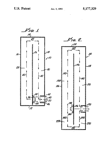

I tried to look up Klayman’s 1962 patent
http://patimg2.uspto.gov/.piw?Docid...&SectionNum=&idkey=NONE&Input=View+first+page
but it doesn’t allow access or display for me.
Hi Moray
Would the extra half octave be at the top or boo tom end? Can you post the drawing?

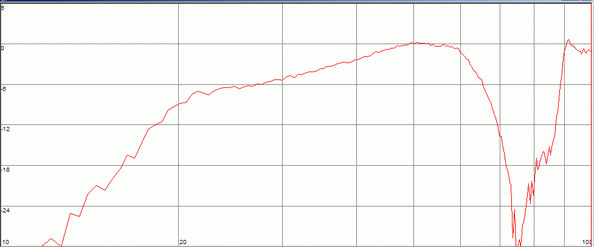

The plot is 10 to 100Hz.

Here is a simulation:
Yes, it looks bad for the tapped horn, but hornresp is not simulating the full story. A tapped horn such as this is a 1/4 wave horn at 18 Hz which is what hornresp shows, but at the same time it is a 1/2 wave horn at 36 Hz. This is what hornresp doesn't show. With the correct driver, the result is that the response is flat and the dips are filled in.
The tapped horn has only one driver while the other horn has two. Note that the voltage input is the same for both at 30V.
How can it be both a 1/4 and 1/2 wave horn? The front of the driver loading into the throat gives the 1/4 wave output, while the rear of the driver located in the mouth actually sends its output towards the throat and then back again.
I'm far from understanding it fully, hence this project to try out different drivers and see how what we can measure is different from the simulation.
