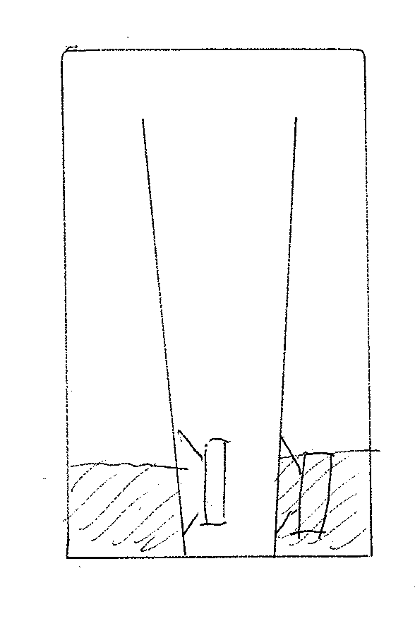

When I mentioned the more complicated push pull I meant a clamshell labhorn type mounting, except with one driver inverted, hence as you know, reduced distortion and vibration. As you can imagine, much more complex to build. If I go beyond prototype then I'll see if I can come up with something along those lines.

G'day again
One path up, two back or the other way around will give you an easy to build clam shell.
#2 Umm...See below
#3 Yep, Hornresponse will show the changes I saw.
#4 Yep, for testing at least. (The pressure didn't rip any boxes apart, and the panels did not vibrate too much)
Could you elaborate, I don't quite follow!
Ahhhhh, I get it now. Yours is perhaps a little simpler than my idea of how to do it:
I think I like your version better.
Paul
Your drawing is better.
Since this is a new idea, perhaps I should patent it!?$
My design just requires one more internal baffle, which adds bracing. External size is only increased by the thickness of that baffle (25mm). A horizontal brace between the two drivers would probably help.

New version:
Part of mouth would have to be covered (too big) but as shown it will accomodate the 15" drivers and a 430 x 430 mounting plate to be slid in to one side.
Mounting plate shown hatched.

Top drawing is 2250 x 515 and bottom drawing is 2250 x 436. Mounting plate shown hatched is 430mm square and the opening in which it fits is 450 x 450 - enough to fit any 15" driver. Hatched blue circle shows the cutout required for the PHL driver, hence the baffle hole shown there will be cut for this or for the biggest 15" that anyone is bringing. So in short, any 15" driver should fit.
I'm going to have to build this thing out of 3 sheets, no way around it. I had hoped for 2, but it's obviously not going to happen.
