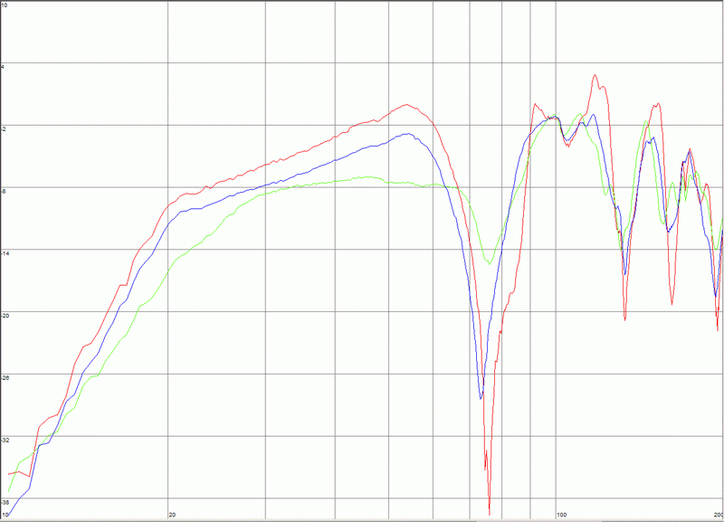

G'day Freddi and Rick
Firstly, the quality of bass from a correctly implemented tapped horn is excellent. This is also the case for low Q sealed, dipole and well designed bass horns. The design itself is not floored.
The big dip in the top end cannot be removed. We tried some damping strategies (Which partly worked but cost us sensitivity) and we also tried spacing two drivers along the horn, again which only partly worked. If you think about the four acoustic paths in a tapped horn, it's quite easy to see where the cancellation related dip comes from. The reflection off the throat of the horn from the mouth side of the driver is nearly perfect. We were getting nulls in the order of 20 to 30dB. Essentially the entire signal is being reflected back to the mouth and destructively interfering with the direct output. Tom's horns are essentially two octave devices as well. (Give or take a bit for driver choice and horn layout.)

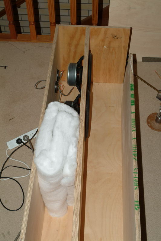

Damping a tapped horn
G'day again rick
This plot gives you an idea of what some acoustically absorbant material will do at the velocity maxima at 75Hz. Red is undamped. You reduce the dip to just 8dB, but lose 6dB of sensitivity in the process. My conclusion was that it is not worth doing.
G'day again rick

Thanks William, very helpful
Wonder if locating the polyester in a different location might give a less unfavourable trade-off?
If we get time at Paul's, we could try, meantime anyone (with TL experience?) have an opinion?
Cheers

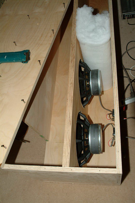

I hate to do this, but I think we'll have to go back to the first design. If the second needs to be twice as big, then I'll stick with the first. Or if I do build the 2nd design, probably end up just using one driver in it. Any bigger will probably be too big.
Richard, as it stands I think you have two good placement options if actually used permanently. Standing in a corner, or sitting along a wall on it's side. With the latter, you could put a TV on top and make it look just like an entertainment unit.
Hi Paul
"I think we'll have to go back to the first design."
The bolt holes, outside to outside on the 15s are 374, 385 & 394 mm, allow a little for the bolt heads. Will all three fit?
If you look closely at the dimensions for the PHL, there is more room than you think. The hexagonal shape means it will have around 10mm clearance. The JBL may be another matter.
