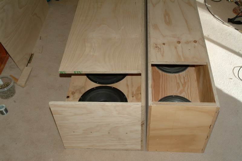

One thing I've noticed is that the midbass dip actually moves higher as you reduce the length. One possibility would be to make two tapped horns of different tunings and attempt to get them to further balance out the other dips. I wonder if this could work.
Another idea - what if a second driver was used and placed higher up - it would be like a second tapped horn tuned higher.
William did you try anything like this and do you think it could prove an answer?
We tried this with two drivers in the 30 Hz horn, and it didn't help. Here's a picture of one of the spaced driver test boxes, in the other the top driver was 1/2 way up the line. I'll have to look for the plots. They were nothing special.

Oops, here's the pic properly linked:

Damn, it didn't work!!!!! 🙁
Ok but could that be because of two drivers in one box creating other problems? I'm curious what would happen if you were driving the offset driver with the bigger tapped horn both measured at the same time. My chart does suggest that if the tuning is different enough that the other peaks and dips should cancel.
