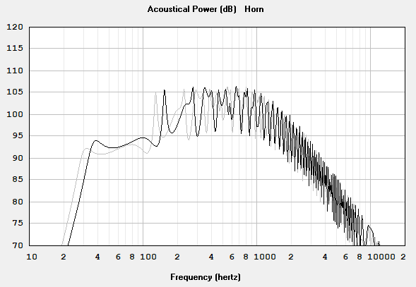

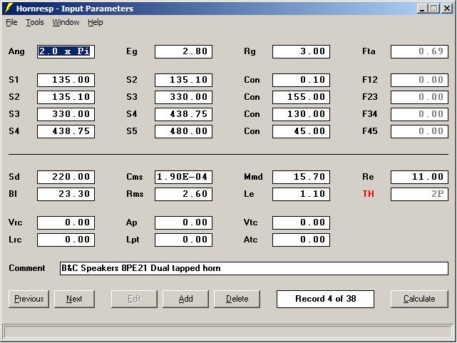

OK, FYI/FWIW, a comparison of JLH's specs (solid) Vs published (shadow) and in each sim the conical flare was changed to parabolic for correctness, though of course barely any visible deviation/measurable/audible differences.

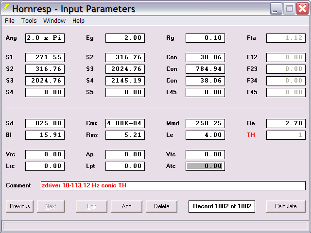

No, the shadow if the published specs are most correct. That said, it just 'dawned' on me (the caffeine finally 'kicked' in) that back then HR apparently wasn't programmed to sum driver specs, so he modded them to get the most correct response, i.e. don't use his specs under the assumption that they are measured.
Attached 'updated'/'corrected' sim; note the 3 ohm series resistance and power based on a 16 ohm load, making me wonder if it was tube driven..............

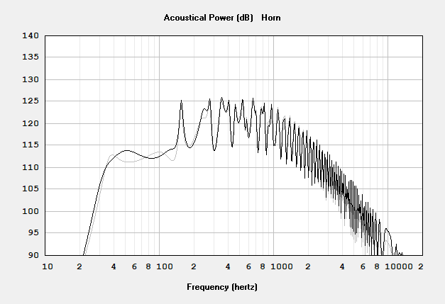

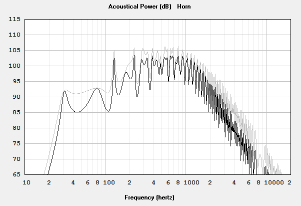

That dual 8PE21 horn is really a nice design - pretty small for what it can do. I shortened it to 0.8 of original length and got this (black, grey is the original):
The motivation is that I was after 35 - 40 Hz at the low end in a compact box. With the smaller one I get almost 112 dB/m at 35 V still below XVar.
The net volume is 90 l, but I yet have to figure out how to place the drivers and how to fold it. The instructions mentioned in the thread say they are placed like in the SPUD (i.e. one reversed if I understand it correctly) and the folding should be like Volvotreters W6 horn - I checked the plans but cannot imagine fitting a reversed driver there.
My modified HR record is also attached.
I was however surprised by one thing. There is a difference between serial and parallel wiring for the two drivers - grey is series, black is parallel. Until now I thought this would not matter if connected series or parallel.

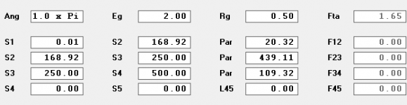

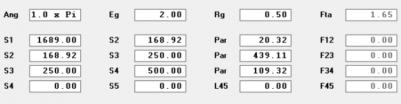

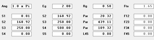

Hmm, ATM my understanding is that we can't mount them as simmed, but if true, then at this late date I'm guessing we couldn't sim it correctly with HR's original TH designer, so FWIW, etc., here's an example of my way for expanding, contracting termination (low pass filter):
