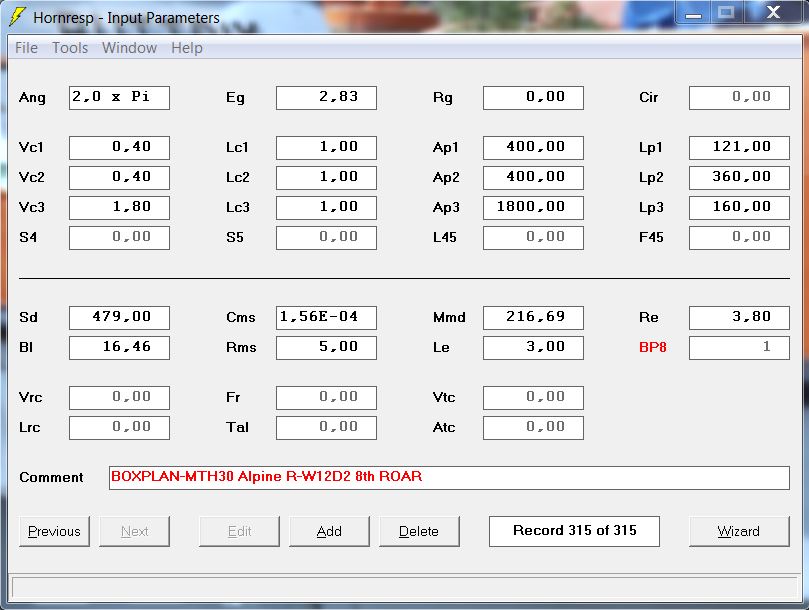

I think this would more accurately be modeled as a compound horn(CH) instead of tapped. The summation is going to make it deviate from the model though.
I do not see why simming it as a CH is any better. Hornresp do not really care about the exact definition of "tapped" : It just indicates that both pipes share the same "node" (in akabak terms ) at their end. The fact is that both resonators share the same mouth, it does have an effect on the fr ( making it less damped ). Simming it as a CH accounts for LESS and would be in that case worse. You can check that by using akabak ( I cannot seem to get it working right now ).

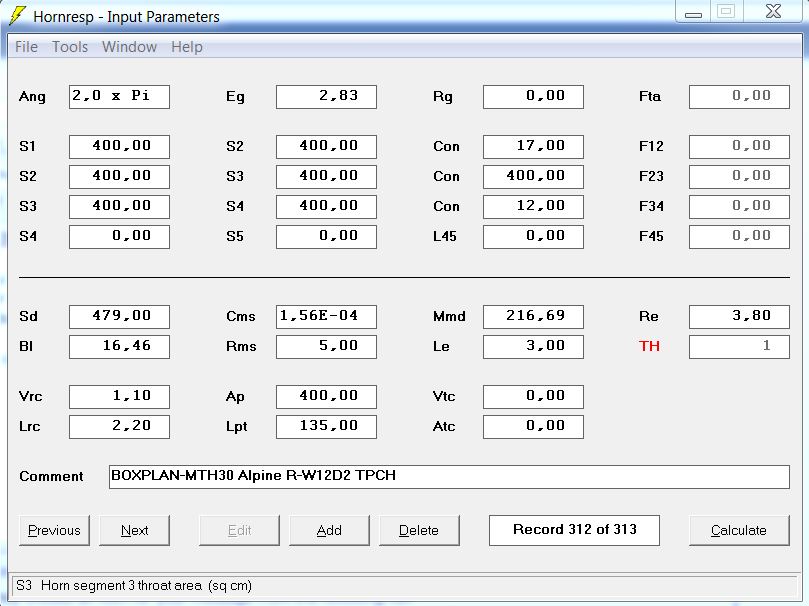

😱 what is this sacrilege? This is not tapped, it's a TL on both sides.
Looks like a tapped pipe to me. A compound horn is a parallel tuned BP6. A tapped horn (positive, straight, or negative flare) is a series tuned BP6.
As is it the Hornresp TH model cannot be manipulated to accurately depict this physical configuration.

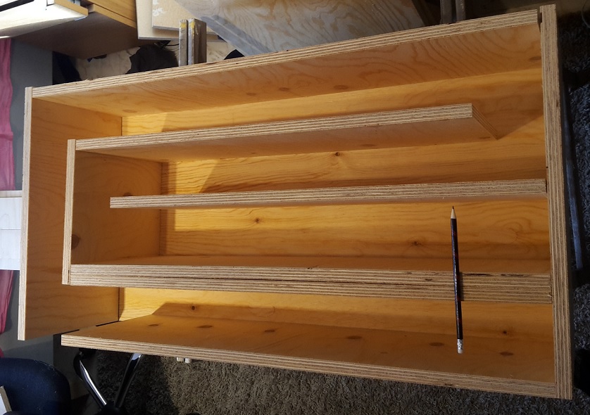

The driver should be under the pencil in the picture.
This is just an example to show a simple to build layout.
Do you plan on installing that last segment like that or are you just trolling us?
S1-S4 = 400cm2 pipe cross section.
Ap = 400cm2 port cross section.
L23 = 400cm / 3 section fold = 133cm.
Lpt = 135cm = 4th section fold.
Based on 1.905cm(0.75") wood.
17cm +400cm +12cm +135cm +(1.905cm × 4 sections) = 571.62cm internally.
571.62cm / 4 sections = 142.905cm wide internally based on the current picture.
17cm x 2 speaker halves = 34cm speaker outer diameter and possible enclosure internal depth.
400cm2 cross section / 34cm depth = 11.76cm height.
11.76cm height x 4 sections + (1.905cm x 3 internal panels) = 52.77cm enclosure internal height.
External width = 142.905cm + (1.905cm x 2 panels) = 146.715cm or 57.76".
External depth = 34cm + (1.905cm x 2 panels) = 37.81cm or 14.89".
External height = 52.77cm + (1.905cm x 2 panels) = 61.57cm or 24.24".

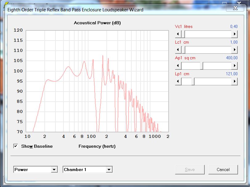

It is a CH feeding a large front resonator. It gets quite large, but I do like the efficiency and large bandwidth.
I consider this to be a tapped horn, since both CH resonators couple together in the large front resonator, but I would agree that this might start to push the boundaries of the definition of a "tapped horn".
That won't work, the driver has 162mm mounting depth.400cm2 cross section / 34cm depth = 11.76cm height.
11.76+3.81= 15.57
400cm²/32cm= 12.5
12.5+3.81= 16.31 depth, this a bit tight, the probability of extra crispy voice coil goes up 200% 😀
This is only a dry-mount of the parts. My son built that box last year.
It was built with a Alpine SWR8D2, so this box is a lot smaller then the simulation I posted previous in this thread.
TPCH with an Alpine SWR8D2
No trolling. It works perfectly. We hit 134,9 dB in our Hyundai Getz in a dB comp, but we built it for the sound quality.
