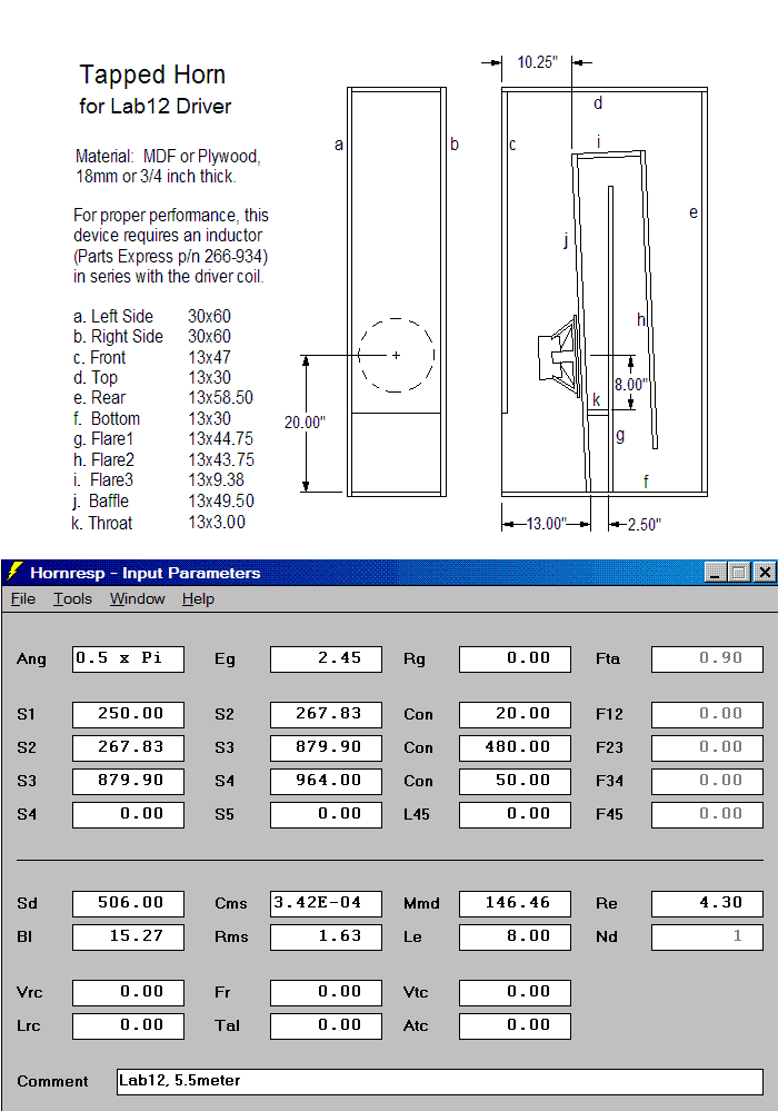

Lab12 Snyder horn with Alpine 12's

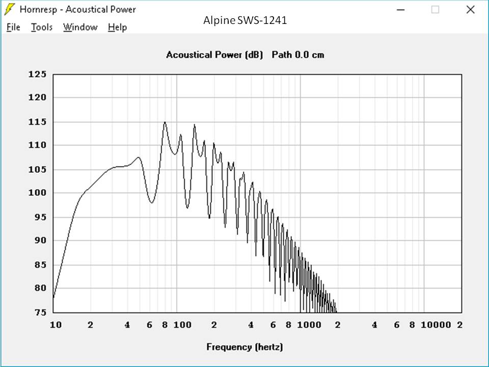

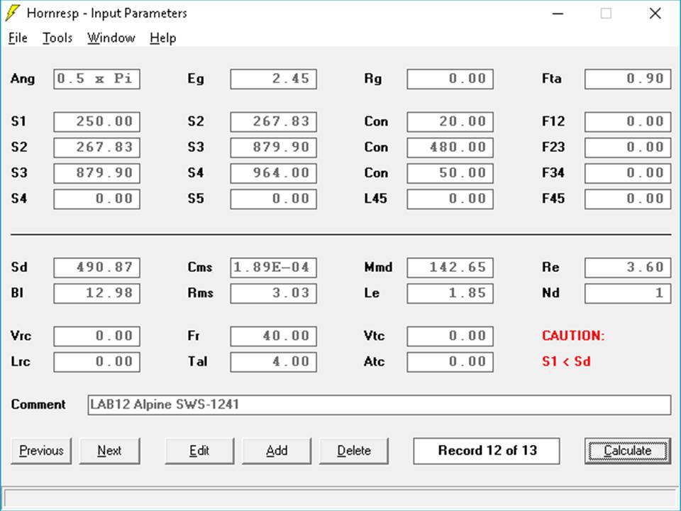

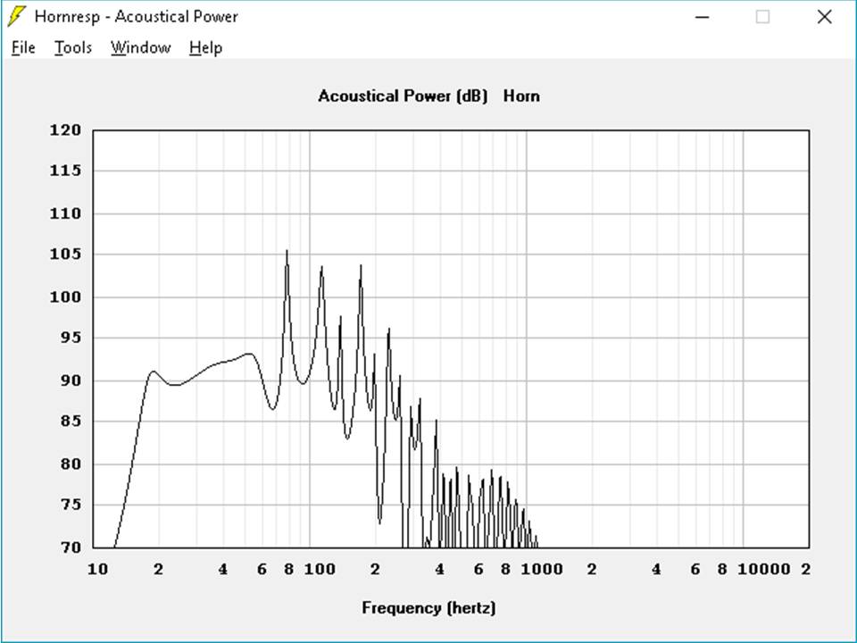

I have modeled the Alpine SWS-1241....
attachment.php
attachment.php

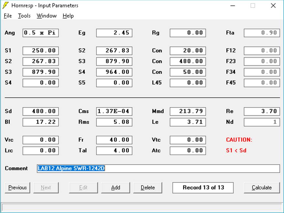

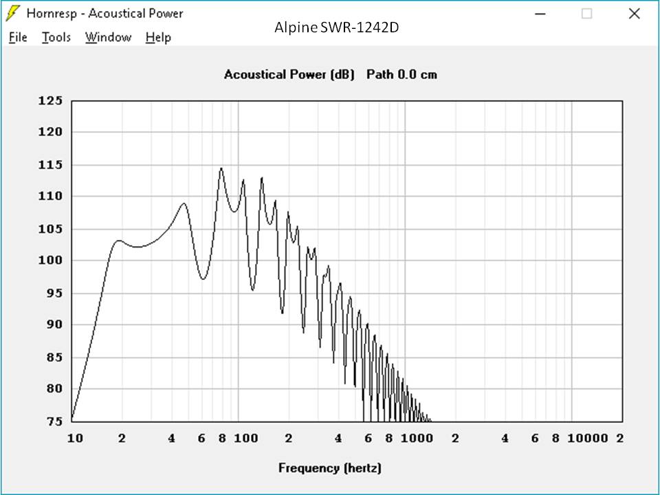

and Alpine SWR-1242D....
attachment.php
attachment.php

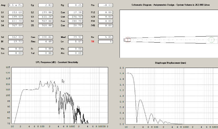

I used this as the basic model.....
attachment.php
To me these Alpine look AWAZING - I mean over 100DB @ 1 watt right?
Please tell me I'm wrong? I so want to build a pair of these!
Any help appreciated.

You simulated in 0,5 Space, which means this response is what you get when you put the Sub in a corner. Try double clicking on the "ang" input section to see the differences. Subwoofers usualy are simluated in half space (=2), which corresponds to them standing on the ground. Of course, If you are to put it in a corner, this is right - but watch for the SPL and lower frequencies - how they change while altering ANG.
You get quite a lot of SPL and low end out of a tapped horn compared to a ported Box much smaller comparing the same drivers.
Ah yes, I see that drops the low output almost 10DB. Thanks.
Notwithstanding I take it then that I have used the software correctly and my modeling is valid?
And perhaps more importantly this system will sound great, right?
A few things:
1. Segments in a TH folded into a rectangular box (like your example) should be modelled as Parabolic (Par) not Conical (Con) segments.
2. For those two drivers you mentioned, you should definitely use the "semi-inductance" option to model them, as their varying inductance is definitely going to have an impact on the response (for more on this, see the "semi-inductance" page on my website). Unfortunately this means that you'll need the extra parameters required for modelling the impact of semi-inductance, and those are not usually quoted. Using the "lossy Le" option is an alternative, but it won't be as accurate.
3. Use Vtc and Atc to include the volume of air in front of the driver's cone in your simulations.

I went back and changed the model from Con to Par. I didn't seem to see any change, but I admit I did not overlay the graphs.

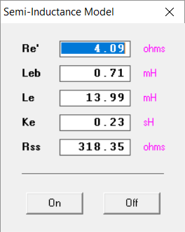

Your semi-inductance write up is very interesting and well constructed. I'd be using the SWR Alpine which has shorting rings and therefore has low and well controlled Le, as I understand it. Therefore, as you've noted in your very helpful write up, should I expect that for the SWR it will have a minimal impact on the modelled response?
I didn't have time to add in the volume of air in front of the driver's cone to the model yet, but happily Alpine includes this in its spec sheets so I'll also do this tonight and look at the change this makes.
Nope, the Alpine driver's semi-inductance parameters definitely need to be considered, based on my experience with the type R 12D2. Sealed alignment, or maybe a re-tuned 4th order BP might work best with them. I'd stay away from higher-order alignments using those drivers.
Thanks again Brian.
May I assume that the numbers in the thumbnail image are the semi-inductance for the SWR-1242D please? If so, thanks for sharing. I'll plug these in and see how this affects the modelled response.

Semi Inductance

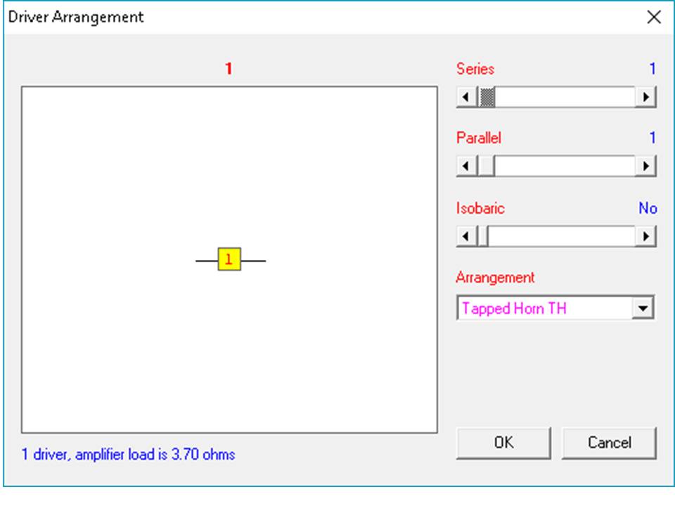

The design should be modelled as a tapped horn, not as a back-load horn. See the Hornresp Help file for details.
Thank you David. Amazing to get your help here, thanks! I'll read up and re-model.

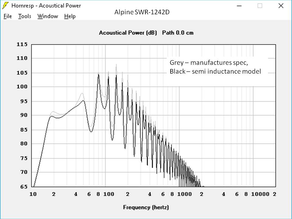

Regarding the semi-inductance model information, here is what I get....
attachment.php
Looks smoother in the pass band, yes? 🙂
