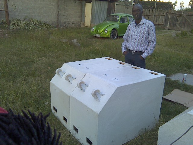

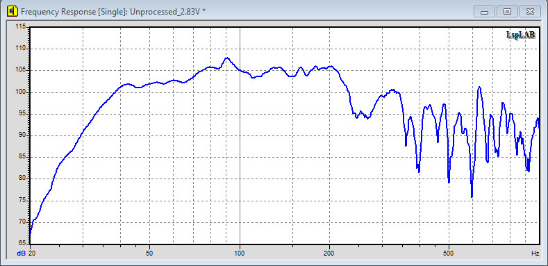

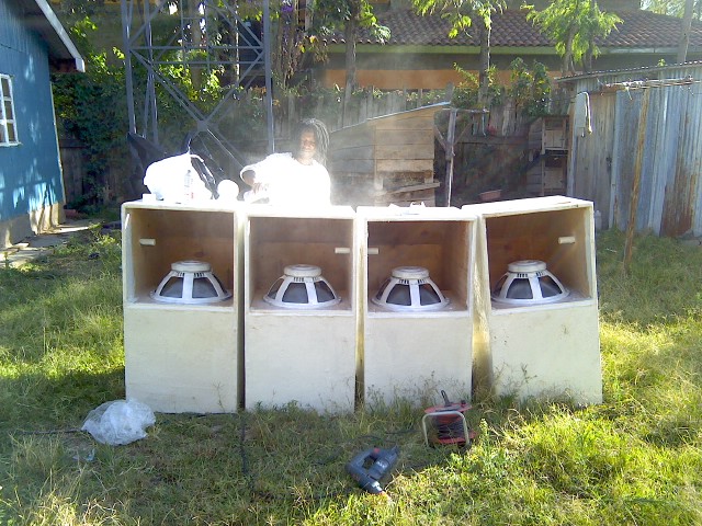

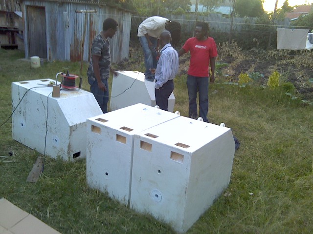

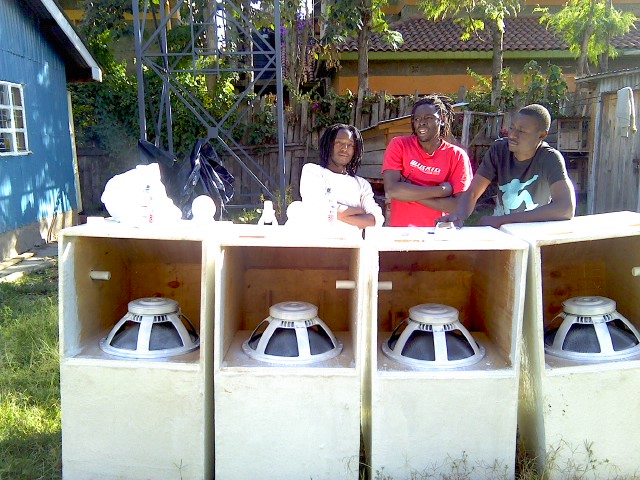

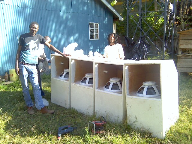

my project th118

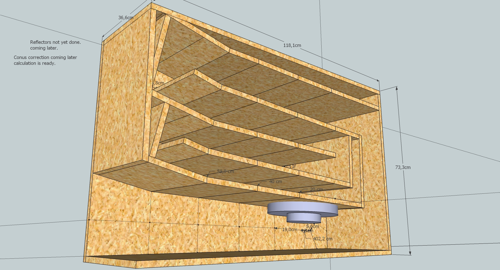

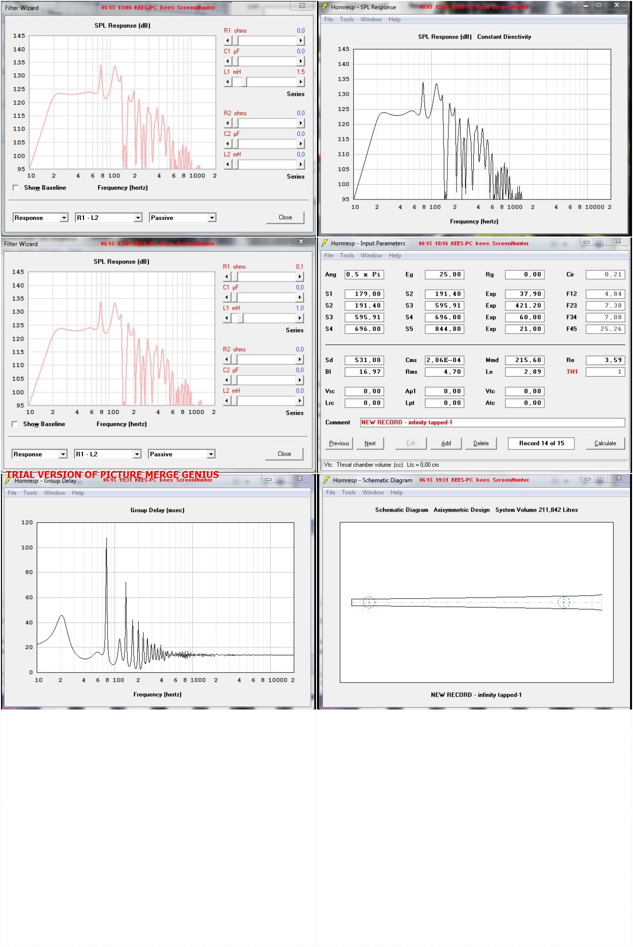

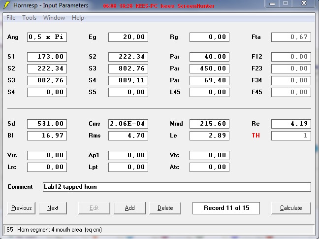

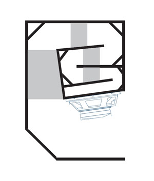

I have remake the tapped horn, now it can be used without coil but a small one do
give still a better sim, but like Djim told me it is not important because in low frequenties there are mountains.
Further it is most of the time better in real world. conus correction is done but not drawn same for reflectors in corners.
spec is within plus and min 3 dB without coil, S2 is bigger then the first one.
regards
kees

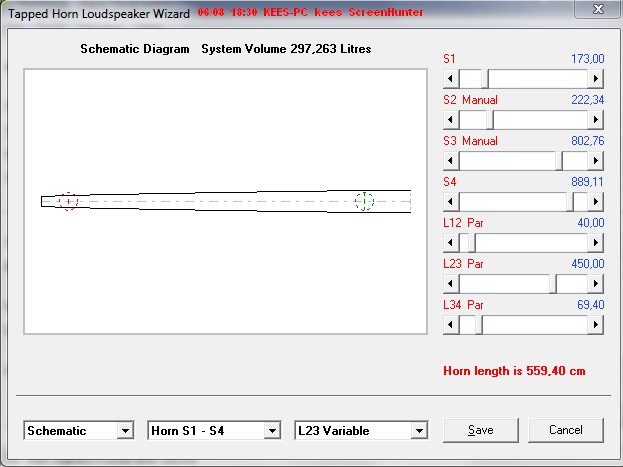

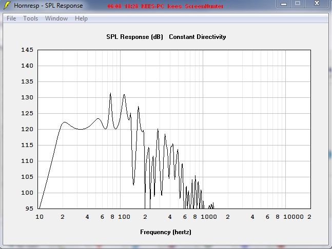

Hi All
I have done a exp flare tapped horn ready for test,, it has nice delay and is 211 liters big (it is some bigger because of unused space), so smaller then a uni flare as far as I now.
The box has build up with parts in flare, I go look later to minimize that and the corners get reflectors also, without getting duct in corner smaller afcourse.
And if errors, please let me now.
regards
kees

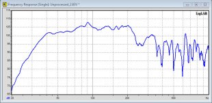

Next question is on a TH that I have come up with, s2 is 800cm2 as is s3 so no expansion, with negative expansion from s3 - 34, yet response looking not bad ? -3db @ 20hz and just about plays up to 80hz which is ideal to cross over into my JBL's. Is this correct though ? Is reason why this wouldn't work ?
http://i1359.photobucket.com/albums/q791/Myles_Lewis/THSLS-P830669_zps51babdea.png

Thanks for the reply GM.....Is reason why this wouldn't work ?
You're welcome! None I can think of ATM, I mean it's a tapped, mass loaded pipe [T-MLTL], so if it meets your performance requirements at a 100 w limit.........
To better see its Xmax limits though, I recommend setting Eg = 2.83V and use the max SPL tool in the acoustic power window.
Note too that technically, L12, L23, L34 [L45] should be a parabolic expansion for typical box construction, though in your alignment the difference between the sim and reality is moot due to either being a short length or is a constant [no taper] expansion.
GM
Thanks, will have a look later at the max Xmax feature later. May tweak it a little, had it ruler flat but hit 10mm Xmax so will check max Xmax feature and tweak design. Will post results.
