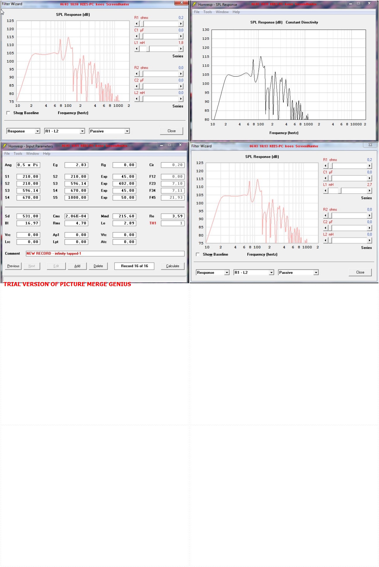

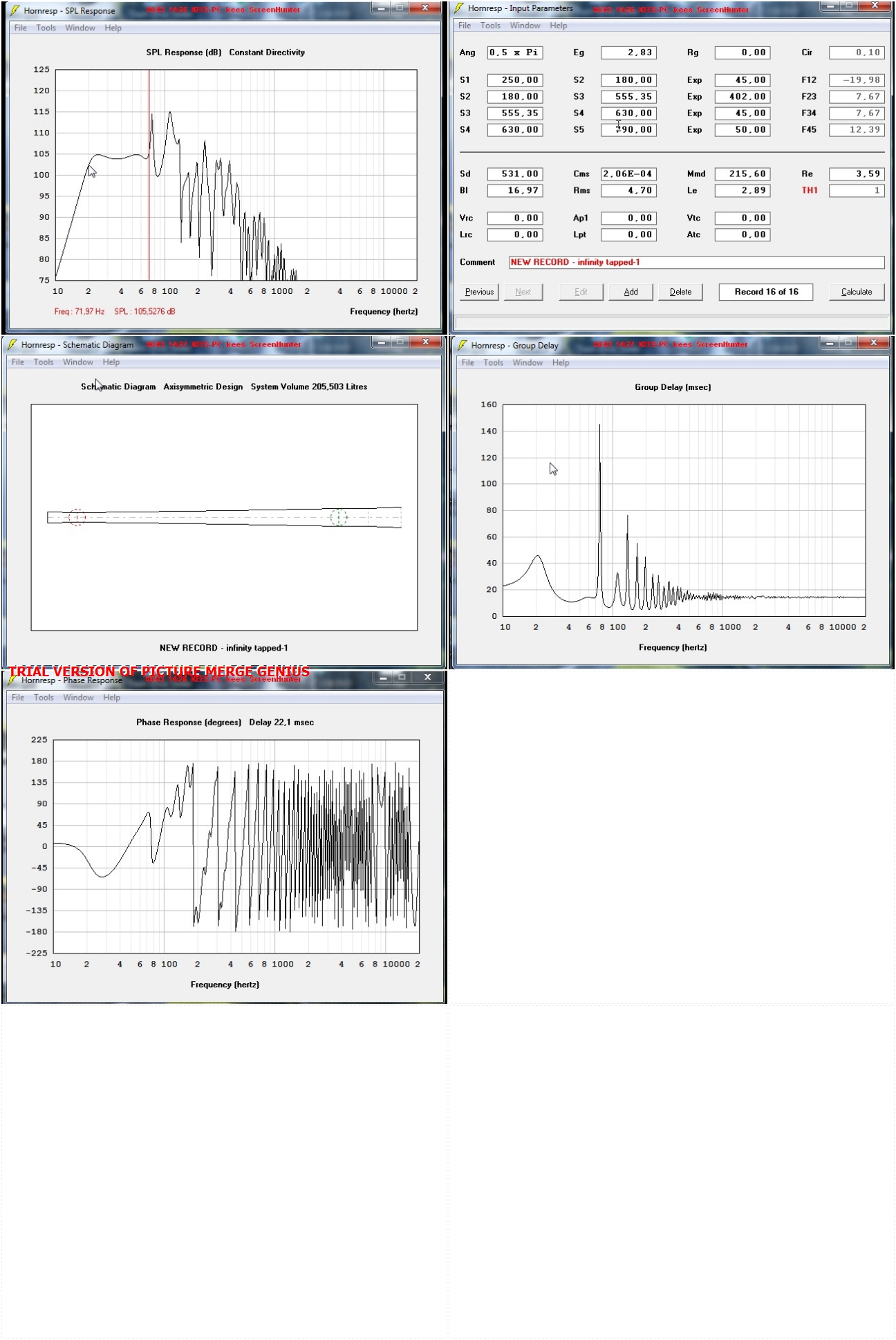

Oke, I have follow the advise of Djim, I have removed the coil in hornresp and do use S4 and S5 also, now I have some less low end, but still the lowest note is there when needed, I do not punisch this sub it is for home theater use and music together with a little wideband horn. Tapped horn is now sensible for coils in it,s pad, so a big amp is needed, I do use one tapped horn and two (cheaper then fostex) Dayton PS180 horns (I need to simulate this BL horn for this speaker to see what combine does.).
I am not sticked on 70 hz perse, I can also use 50 or 60 hz, but the lows end now is also enough, now I have a box as a T-TQWT the same delay, 205 liters big, original was 289 liters. The infinity is very strong, has very stiff cone and heavy surround.
I get with al this testing afcourse more knowledge about speakers boxes, however I was good with TL and open baffles with martin sheets, but these are more predictable as a tapped horn or a T-TQWT.
Let me now what you think of these pictures, for me it looks good.
regards

Hi kees52,
That one looks good, but you can improve on it by making it a bit larger. Especially at high power I think it would be better slightly larger. I'll attach a version that's a little larger, and I added a 3mH inductor back in series with Le. Just import the file into Hornresp.

Oke I have done also some with coil in speaker pad but then trough filter wizzard, and looks better, fall off of yours I don,t like, but we get better and better with a not so easy speaker.
Tb this new one give also more low and high end so to speak.

Hi Djim,
Because it smoothens out the response in this case. As long as the value does not get too large. kees52 has described a method for building his own.
I find it easier to include an inductor in Le and to then use the Hornresp Wizard to arrive at the box dimensions.
In practice all this does probably not make any difference, somewhere along the line one has to build and measure.

Hi Kees and Oliver,
Kees, I'm not sure if those are my exact words ;-) but indeed, the less than 1dB improvement is probably even less in reality where peaks and dips are halved anyway. Simming the exact outcome of inductors is a little tricky since these simming-inductors are perfect in simulation and everything but perfect in reality. For that reason I mentioned to you to test it afterwards instead of designing with it.
Also, Oliver has covered the Re of the inductor within the Re of the driver which should give similar results like the wizzard.

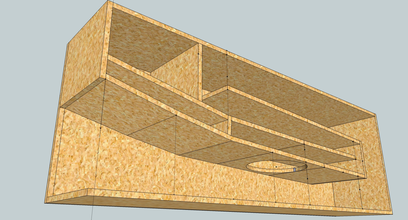

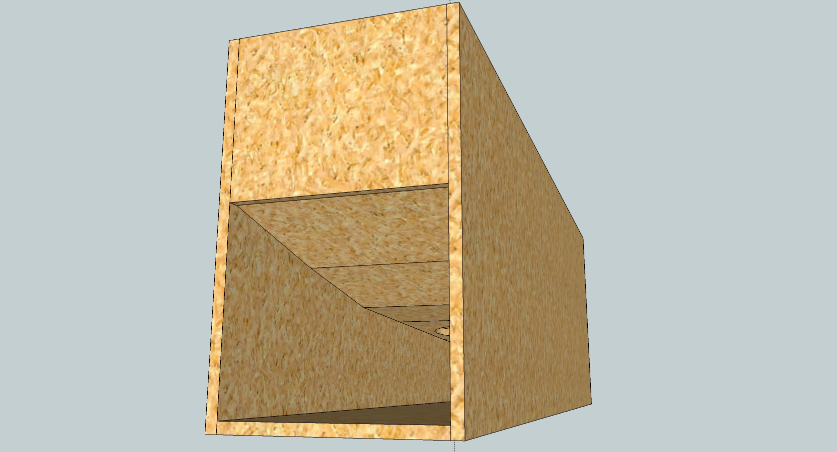

In picture you see a folding it is a test afcourse to get folding in my head (try also autocad lite), But soon I go start build the tapped horn and the T-TQWT after that, I need some speakers for eventually on a meeting with my hybrid amps.
