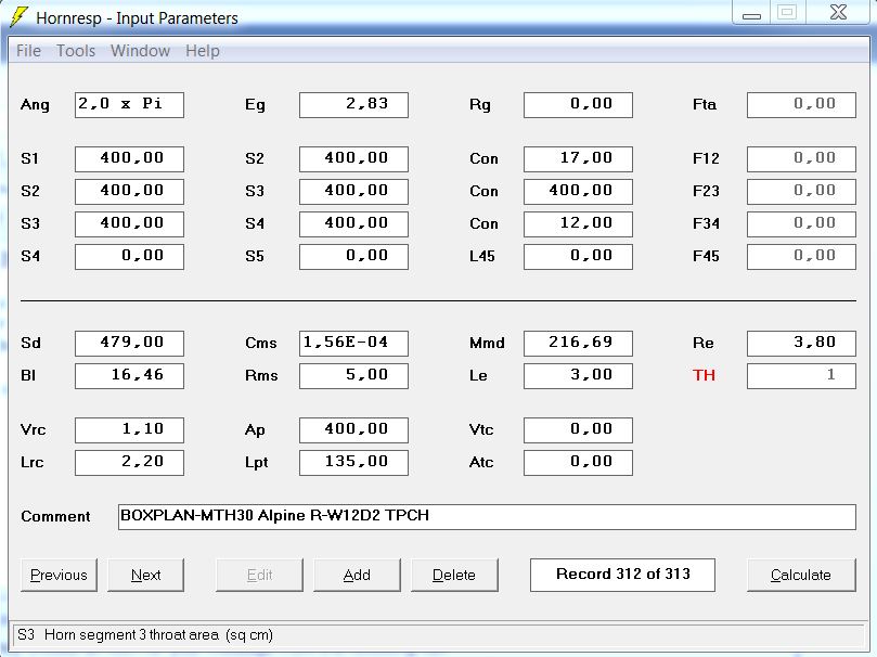

Hi Brian,
So I did some home work and came up with some input parameters for Hornresp exported from your magnificent MTH30.
Using the MTH30 workbook I entered external dimensions equivalent to the Lab12 Snyder and let the Optimise routine do its work.
I imported this into Hornresp and got the following input screen......
attachment.php

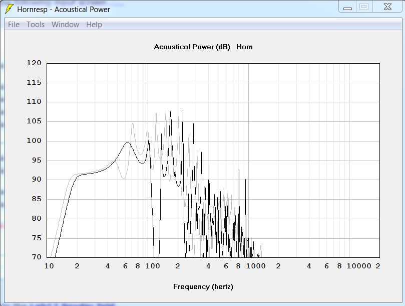

Here is how this MTH30 fold compares to the Lab12 Snyder fold.....
attachment.php
I think I like the MTH30 fold better. It goes just as low and looks smoother overall. That first big suckout around 60 hz is 5db less severe as are the rest up to approximately 100hz.
Am I missing anything here?
Thanks again! :wave:

I've built and measured both a TP with a deep notch and a TH with a somewhat deep notch, both just above the passband. I prefer how they sound with the notch addressed, either through stuffing (in the case of the TH), or a precisely-located constriction (in the case of the TH)
@Brian Steele:
You did not seem to like the deep notch a few years back when I mention the same distortion lowering effect of a deep suckout above the passband.
