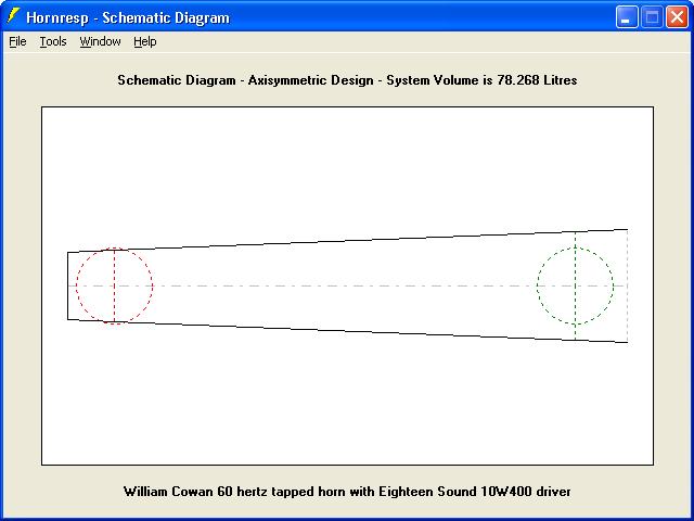

just a guy said:Are you watching Mr McBean? Can L23 and L34 overlap?
JLH said:I too would like to get David McBean's opinion whether L23 and L34 can overlap.
Hi just a guy and JLH,
The Hornresp tapped horn simulation model assumes that L23 and L34 do not overlap, as shown in the schematic diagram.
Just a guy - if you are still using Version 17.nn of Hornresp then I strongly recommend that you upgrade to the latest release, Version 20.20. The Tapped Horn Wizard has been significantly enhanced since Version 17.nn.
Kind regards,
David

David,
Thank you for your reply. Now here is my question: While Hornresp performs calculations based on L23 and L34 not overlapping, doesn’t my construction method result in having them overlap? In other words, my Hornresp input data is correct for the construction method I used. If you haven’t been following this discussion between Just-A-Guy and me, please refer to the below posts for clarification.
This is the Hornresp input data and Google SketchUp renderings
http://www.diyaudio.com/forums/showthread.php?postid=1627597#post1627597
This is how I interpret L23 and L34 based on my construction method
http://www.diyaudio.com/forums/showthread.php?postid=1712919#post1712919
I rationalize this interpretation by saying the pressure wave must still cover the overlapping distances twice in my design. This is very much like pulling your car into a driveway. In order to get back to the street you must recover the length of the driveway to get back out.
Rgs, JLH
No.
No.
Just because your driveway "taps" into the street does not mean your driveway is adding length to the street. If you measure your street from one end to the other your driveway does not enter into the calculation of the loverall ength of the street in any way.
Study the hornresp schematic. It's pretty easy to see that L23 and L34 CANNOT overlap. Hornresp needs L23 to end before L34 can begin. Hornresp is worrying about pressure wave distances specifically so you don't have to. Forget about pressure centers.

Just because your driveway "taps" into the street does not mean your driveway is adding length to the street. If you measure your street from one end to the other your driveway does not enter into the calculation of the length of the street in any way.
Study the hornresp schematic. It's pretty easy to see that L23 and L34 CANNOT overlap. Hornresp is worrying about pressure wave distances specifically so you don't have to. Forget about pressure centers.
