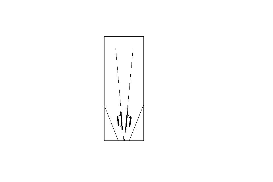

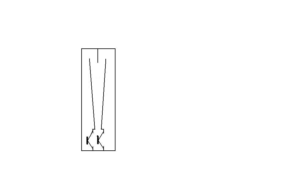

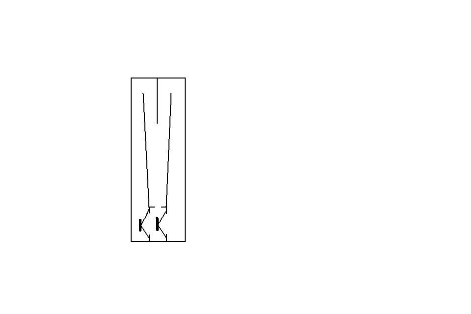

How about this one
I would like to call it "Tapped-ACE", inspired from the famous quaterwave, the "ACE-horn"
Its simple, but I thought there wouldnt be much else to it, as the ordinary tapped design is even simpler
But now it got me thinking that I may have forgotten something about the original ACE-horn
The two internal lines are not completely alike as the "V" is offset a bit to one side
I am not sure excactly what it means, but could it be of any use fore a tapped-horn somehow
But I could imagine that it may be difficult to simulate
Any thoughts would be appreciated, thanks
edit, oh yes, maybe one driver should be turned the other way round, to make it push-pull, if thats significant
And maybe one driver should be mounted slightly higher, making it asymmetrick
It have been said that the push-pull needs a compression "chamber" to work properly, while others say that such design has its own flaws, and that driver should be able to breathe freely, resulting in less ripple, as I understand it

cowanaudio said:G'day just a guy
There is nothing wrong or bad with a high throat to mouth ratio. It's the compression ratio or Sd to throat that you have to be careful with. If the compression ratio is too high, you will suffer mechanical driver failure if the box is pushed hard. Three to one is about the limit for a very stout driver, two to one would help a more average driver survive.
A large throat to mouth ratio makes the box bigger and increases output and smooths response.
Cheers
William Cowan
