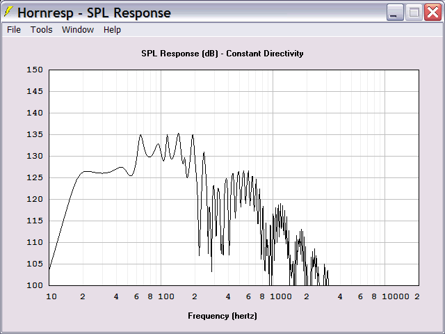

just a guy said:
The maw15 on the other hand is a driver I already own and if I find a tapped horn design better than the one it is currently in (regular tl) I will build it.
Other than being ~456 L net due to its relatively high Vas (an isobaric pair would reduce it considerably), I see nothing wrong with this corner loaded 250 W peak design and it could be loaded lower, though of course it would be bigger:
