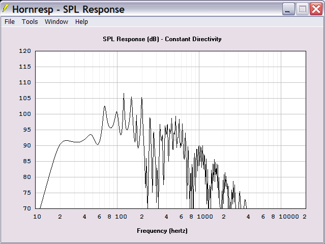

Dang! And I thought my sim ~mirrored the SPUD's measured response once TD's comments about smoothing was factored in: 2pi space, 1 W/4 ohms, ~364.5 L:
GM

that predicted frequency response shows peaks at 70Hz and 100Hz and >=120Hz.
The discussion has previously agreed that a folded TH will reduce the severity of these peaks.
What cut off frequency would we use in this example? 60Hz active 4pole or some higher frequency?
Do the first and/or second peaks need to be controlled either actively or passively or simply ignored.
Hmm, the bends will only quell the extreme HF where it doesn't matter in a TH since even the highest practical XO point will damp them below audibility. TD's comments alludes to there being other considerations that smooth them out considerably as proven by his measurements. Not having actually built/measured a TH I can only speculate what's doing it and how it might be designed in or at least increased over the norm, so at this point not sure whether or not to ignore the peaks. Simming WC's THs and comparing them to his measurements should help in deciding what can probably be ignored.
With today's digital EQ/adjustable XOs though, it seems to me that where the driver is near the ends that the XO can be as high as the driver's mass corner if 4th order and it's positioned to blend well to the mains once any time delay is accounted for, so in theory there's lots of tuning flexibility with a high mass corner driver.

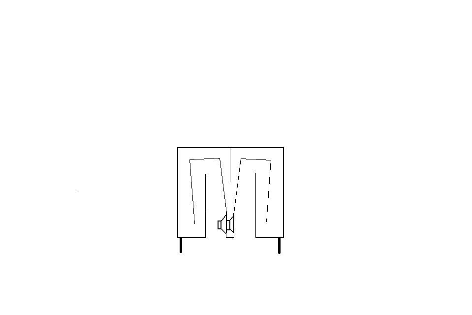

My seat of the pants measurements seem to indicate a throat of about 34 sq. in. and a 119 sq. in. mouth with a 227 in. length. It would appear that the drivers are mounted about 41 in. from the mouth, and 0 in. from the throat.
How accurate are the dimensions of the drawing floating about labeled "Couch Sub... (Drawn by TW)..." when compared to the final TH-SPUD? Anyone know? Feel free to chime in Tom, if the spirit moves you.

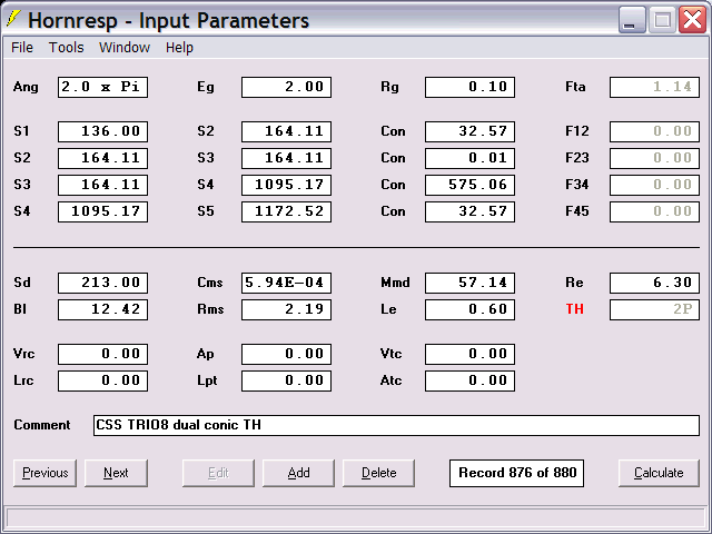

Your input parameters must be different than mine. I could not get is to look like yours even with some slight changes. What are your input parameters for the simulation?
Rgs, JLH

I used the linked published specs and just 'ran the numbers' on single and dual driver variants the same way I do for any TH sim I've posted to see if it was a potential TH woofer/sub driver, making no attempt to conform to the so-called SPUD drawing since I assumed it was only somebody's guess and noticed that the dual might be 'close enough' WRT the SPUD's measured response and small enough that it could probably be folded to fit into Paul's desired cab dims, though of course like any such sim it may be worthless if the specs are too far off.
I obviously disagree with your assertion that its published specs aren't suitable for a DIY HIFI/HT 'sub' TH, though making the dual a push-pull layout is more trouble than it's worth IMO for these apps, especially if you're going to sit on it, though it may need a bit more bracing around the drivers if (over) driven to meet DD/DTS/THX reference level down low with only a single sub in 2pi space. In this layout, best to use two (four drivers) as recommended for the SPUD.
My models suggest this is the real deal, or at least very close. You won't learn much by just copying a Turn-Key design. The biggest benefit of DIY is you get exactly what you want, not what some designer thought you wanted. And you learn some along the way.

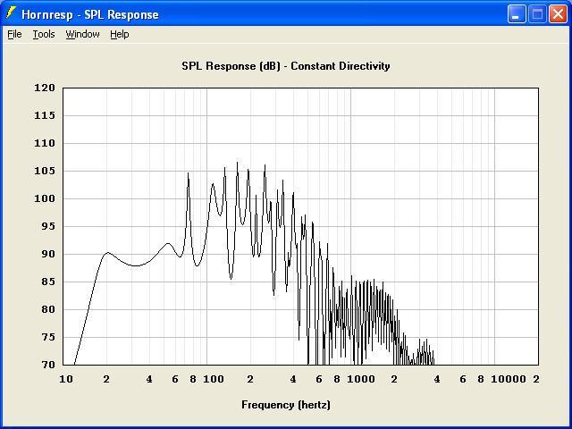

Below is an approximation based on the Couch Sub drawing with the Trio 8 plugged in. Efficiency seems a little light at 90 DB, but the rest looks decent I think. In looking at the nasty spikes starting at about 70hz, I believe that based on posts earlier in the thread, they should be tamed by a hemholtz type of action.
The varying length folds all appear to be in the 70-100 hz range at 1/4 wave length.
Anyone want to poke holes at the assumptions and results have at it. I will post the input parameters in the next post.

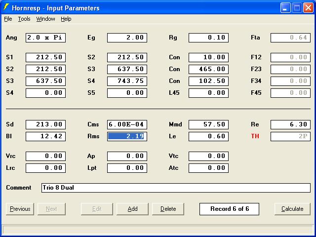

As promised here are the input parameters.
My assumption is that the exterior dimensions are 48" x 45" x 11" which should yield about an 8-1/2" height (width?) in the interior of the horn.
Has anyone else tried to measure the Couch Sub drawing? Are my numbers close?
Paul
