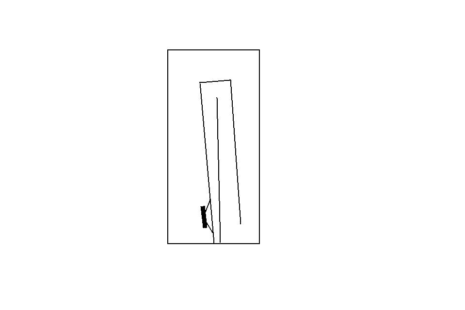

Heres another one 😀
btw, those graphs of pushpull looks very promising, but I suppose they are still simulation

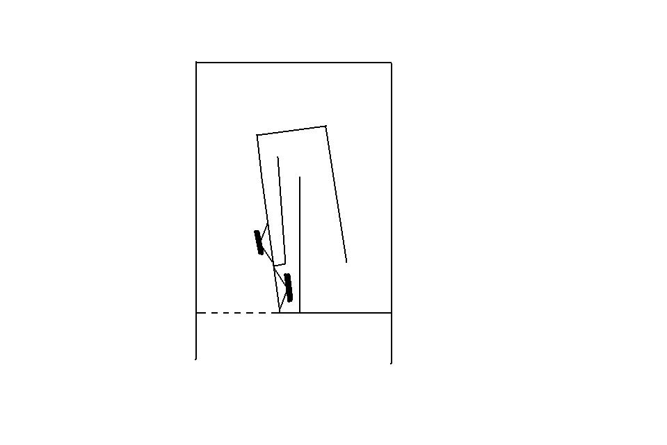

Heres another version 😀
Tinitus: can I ask you what you feel is the difference in having two drivers load a single section of line as in the Spud as opposed to your suggested loading scheme where the two drivers are seperated by a short length of line? Either way the two drivers couple to one another. The only difference that I can see is a slight tme delay one way Vs the other. I love your ideas and thinking in and out of the box so don't take this as a negative. I think that the closer and more intimately the drivers interact with one another the better to cancel out nonlinear distortion. Keep up the great posts. Regards Moray James.
Thank you James 🙂
To be honest I do have serious doubts about doing it the way I showed, with seperating drivers at throath
Thats why I hoped fore response like yours 😉
I was just interested in investigating whether there were any possible options, in case it showed to have any advantage
Anyway, all my suggestions could be done without the seperating baffle at throath, just leave it out if you like
I will hereby finally rest my case of having concerns about whether drivers are stressing each other under heavy load, with possible risk of ressonant distortion
Fore one, theres a huge advantage of each woofer doing half the work
If woofers have very powerfull "motor" there should be no problem
If amps have plenty of power to control the woofer there should be no problem
And pushpull theory/simulation may actually work as intended, in real life too

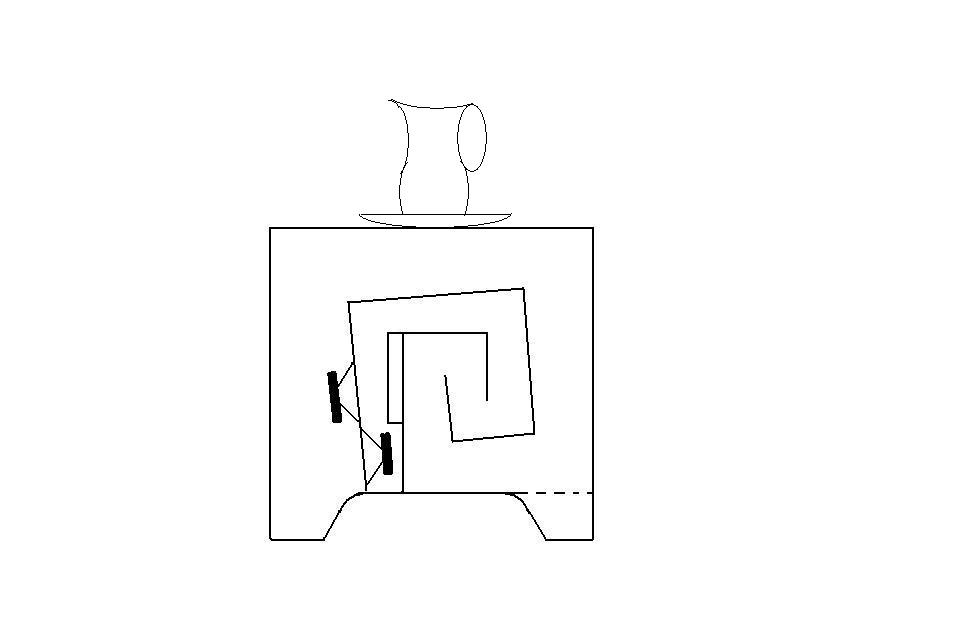

Pushpull with common loading
Features a spiral with mostly angular joints 😉
And with profiled lists to give the illusion of "doors" it would look like a piece of furniture...might make the lady happy :worship:

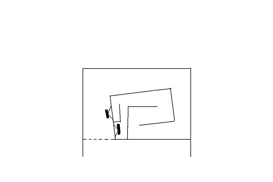

Me too...its funny, but its almost like its relaxing to look at this folding
in my files I have named it "Tapped Spiral Duo"
And heres the one I might do with a single SS XXLS 10"(alucone) ... I call it "Tapped Spiral Solo" 😀
High SPL is not my goal, so with a quality driver I see no need fore pushpull
In case you missed it ... the TRIO8 in PP doesnt seem to need any special arrangements fore its magnet to fit in the throath
