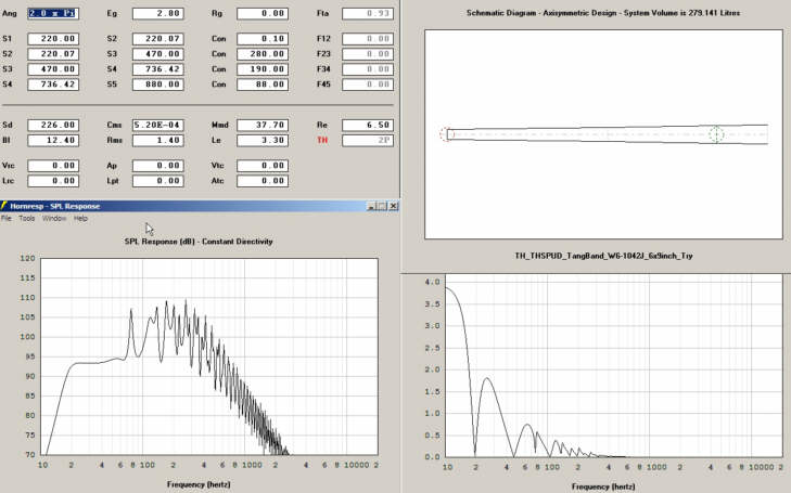

Any additional information pertaining to the use of the W8-740P in the THSPUD would be appreciated. When I model this driver in hornresp the SPL response is almost identical to the response using the MCM 55-2421, and both have quite a bit higher humps and bumps than the CSS TRIO-8 (again, modeled in the same box from Post #2821); and using mwmkravchenko's data (Post #2832) the SPL response looks even worse.
In the tapped horns for dummies thread (Post #208) Tom Danley showed a measured response, that does not correspond to my modeled hornresp response. This seems to have become a theme, anyway, a speaker that does have a SPL response in hornresp that is quite similar to Tom's measured response curve is the TangBand W6-1042J 6"x9" (modeled in a very similar box).
Anyhow, thanks for clarifying, and I agree sooner or later there has to be saw dust involved.
Oliver.

G'day Oliver
I did the same thing and was amazed that all the response features line up perfectly (At least below 200Hz where we have data). They are lower in Q than predicted, but all the peaks and dips fall at the same frequencies. That's why I believe the W8-740P in the Spud enclosure as drawn is right on the money, or at least very close. Damping in the line could be responsible for the reduction in Q of the response features as measured.

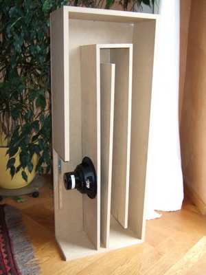

I'm moving along towards a finished th-spud style sub with Trio 8's. The drivers have arrived, most of the wood is cut, the layout has been drawn on three sides for nailing. I should have it ready for testing next weekend (lord willing & the creek don't rise)
Here's a question I should know the answer to but I'm not sure. When two 8 ohm drivers that have a rated power handling of 200 watts are hooked up in parallel the result is a 4 ohm load of course but what is the resultant power handling? 200 watts? 400 watts?
Also what is the current thoughts on the best way to attach the driver maintenance panel?
Paul

In Hornresp when using two drivers of the same type, what parameters need to be changed? I assume sd needs to be doubled and Re needs to be halved.
What about;
Mmd - Doubled?
Bl - Doubled?
Cms?
Rms?
Le?
Once I get all the parameters entered, how do I go about determining power handling?
