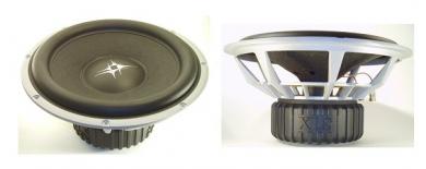

Not my kind of driver, but have the 94db Peerless XXLS 12" carsub been simmed...from statements about good TH specs, it could seem like a candidate fore TH 😕
http://www.tymphany.com/830877
Yeah, it's one of the first ones I simmed for a sub 20 Hz TH, it 'rocks' on paper, though fairly large at ~307 L net.
