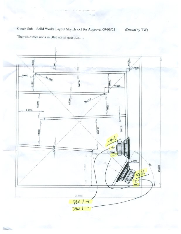

There are at least three benefits of using a compression chamber in a tapped horn design.
1.) When using push-pull woofers with a compression chamber second order distortion is cancelled. This effect is very audible. You must hear it to understand.
2.) The air volume in the compression chamber can help flatten the response without resorting to adding inductors. On my dual W8-740 tapped horn, the response was flatter with the compression chamber.
3.) The large air volume in the compression chamber acts as an air spring which can help protect the woofer’s cone from high throat compression ratios. I’ve blown up my fair share of woofers. I’ve trashed some B&C 8PS21 woofers in a conventional single woofer tapped horn; blew a hole right through the cone. However, in another push-pull tapped horn using the same woofers I’ve had no problems and it has a higher compression ratio!
True. But none of the designs I posted are for dual drivers. They could be changed to dual driver designs easy enough but then there would be less total subwoofers for distribution throughout the room, which I'm told is also an audible improvement.
Not in my experience. In fact I've found the opposite to be true but my tapped horn modelling experience is limited and this was the first time I tried to model with a chamber.
Are you sure about that? I'm not nearly smart enough to confirm or deny this. Your examples don't include enough info to conclusively blame the problem on any single issue, it sounds like you doubled the amount of drivers, added a chamber and may or not have made significant changes to the actual horn and you never mention how much power was applied to each design.
Anyway, you obviously have way more experience than me, so you are probably right.

Just A Guy,
I’m all about quality and not quantity. I personally prefer two extraordinarily performing subs over four or more mediocre performing ones. I’ve never considered multiple subs because I’ve been able to achieve my desired results with a stereo set of properly designed tapped horns.
Whether the air chamber smoothes or ripples the response is very dependant on the tapped horn’s design and the woofer used. I have seen it go both ways. I just depends on your design.
I am very certain about the air chamber serving to protect the woofers. With less than 260W into one of my 8PS21 tapped horns I blew a hole through the cone. I then redesigned for a dual woofer setup. I started the redesign by keeping all the path lengths the same, but doubling the areas. I then arranged the woofers in push-pull with an air chamber. After much simulating, I actually had to reduce the throat area to get the smoothest response. Therefore, my throat compression ratio went up. Once I built it I was able to put about 600W into the push-pull tapped horn before I had to stop due to high SPLs. After inspection there was no damage to the woofers. I don’t know of any other way to be more convincing then that.

MaVo,
Take a look at the below Dumax Report on the Dayton Titanic Mk III subwoofer.
http://www.parts-express.com/pdf/295-404dumax.pdf
Of course this is not the woofer I used, but the asymmetry seen in this report is very illustrative of most woofers on the market. Even the best pro sound woofers have a degree of asymmetry. Since the motor’s ability to control the cone is not symmetrical, this leads to even order distortion. However, when you use woofers in push-pull with a common chamber; the chamber acts as an acoustical summation device. The suspension non-linearity and the asymmetrical drive get canceled. Where the two woofer’s motor strength differs, the net result is an average of the strengths (Green line). See below graphics.
From original report
Superimposed and flipped to show non-linearity – Green line shows result of summation
Notice how the Bl non-linearity begins at only 3mm of cone travel. Notice how Kms non-linearity begins at only 7mm of cone travel.
This is the best I can explain this from a technical stand. If you guys still don’t understand, I can’t help you. Subjectively, I would not consider using anything but push-pull for “subwoofer” applications. However, I am willing to use single woofers for mid-bass and higher frequencies where dual woofers are not practical. It all depends on your application. Everyone’s situation is different.
Rgs, JLH

It applies directly to the SPUD. Looking at MaVo's post #2665 you can see how it works. We need to assume a positive voltage applied to the "+" terminal of the woofers causes the cone to travel toward the magnet. Since the woofers are reverse mounted and wired in opposite polarity they both force a low pressure in the horn throat when a positive voltage is applied to the box's "+" terminal. This is because both cones will be moving toward the mouth of the horn and away from the throat.
What Hornresp data are you looking for? I've posted my dual Tang Bang W8-740 horn in here before. It can be used as a guide for your own design.
Rgs, JLH

They can be mounted like the SPUD in MaVo's post #2665 or you can create a defined chamber like I did with my dual W8-740 tapped horn. The chamber feeds the throat of the horn. One woofer’s magnet sticks out in the mouth of the horn, and the other woofer’s cone faces the mouth. A clam shell does not work. You want the cones traveling in opposite directions in relation to their magnets. A clam shell only doubles volume displacement. Only reverse mounting and reverse polarity provides both 2X displacement volume and distortion cancellation. See graphic below
Rgs, JLH
Rgs, JLH
Are this called reversed mounting...and how can you reverse the polarity when mounted like you show

JHL, man Im sorry, im a fool
I see your neat trick now...seems I didnt understand your design at all, with the inside of the "driver-box" loading the line
I didnt understand how you would get 2xdisplacement either, but now it makes perfectly sense
Its beautiful intelligent design, I want it 😎
