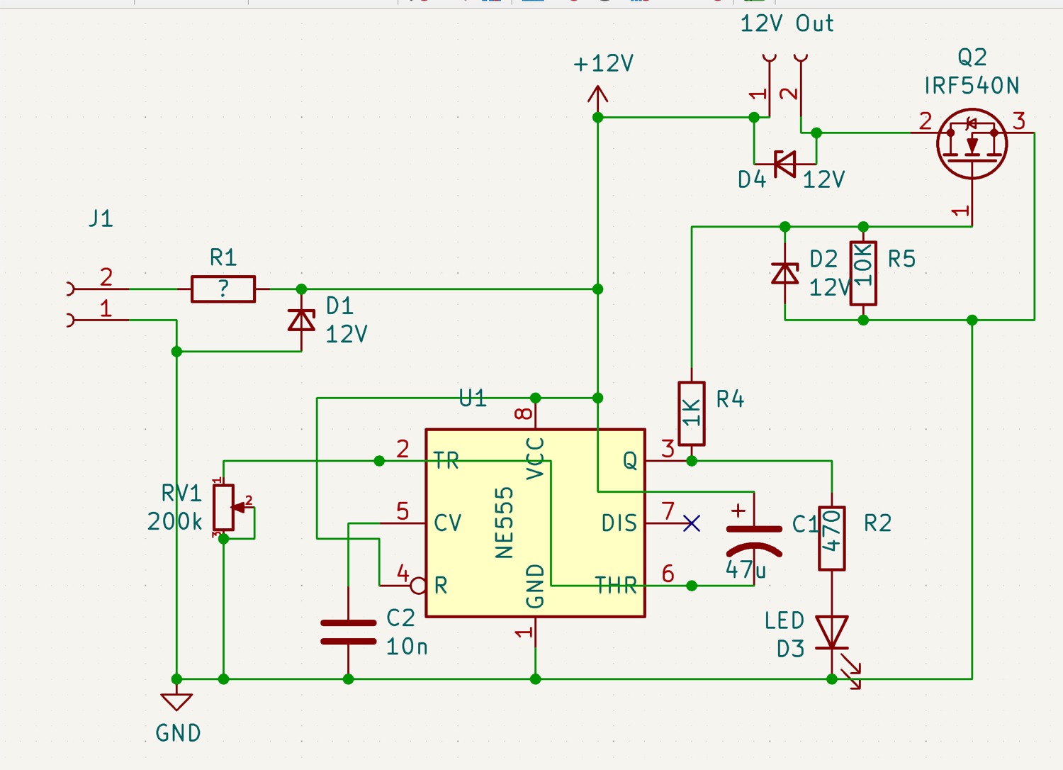

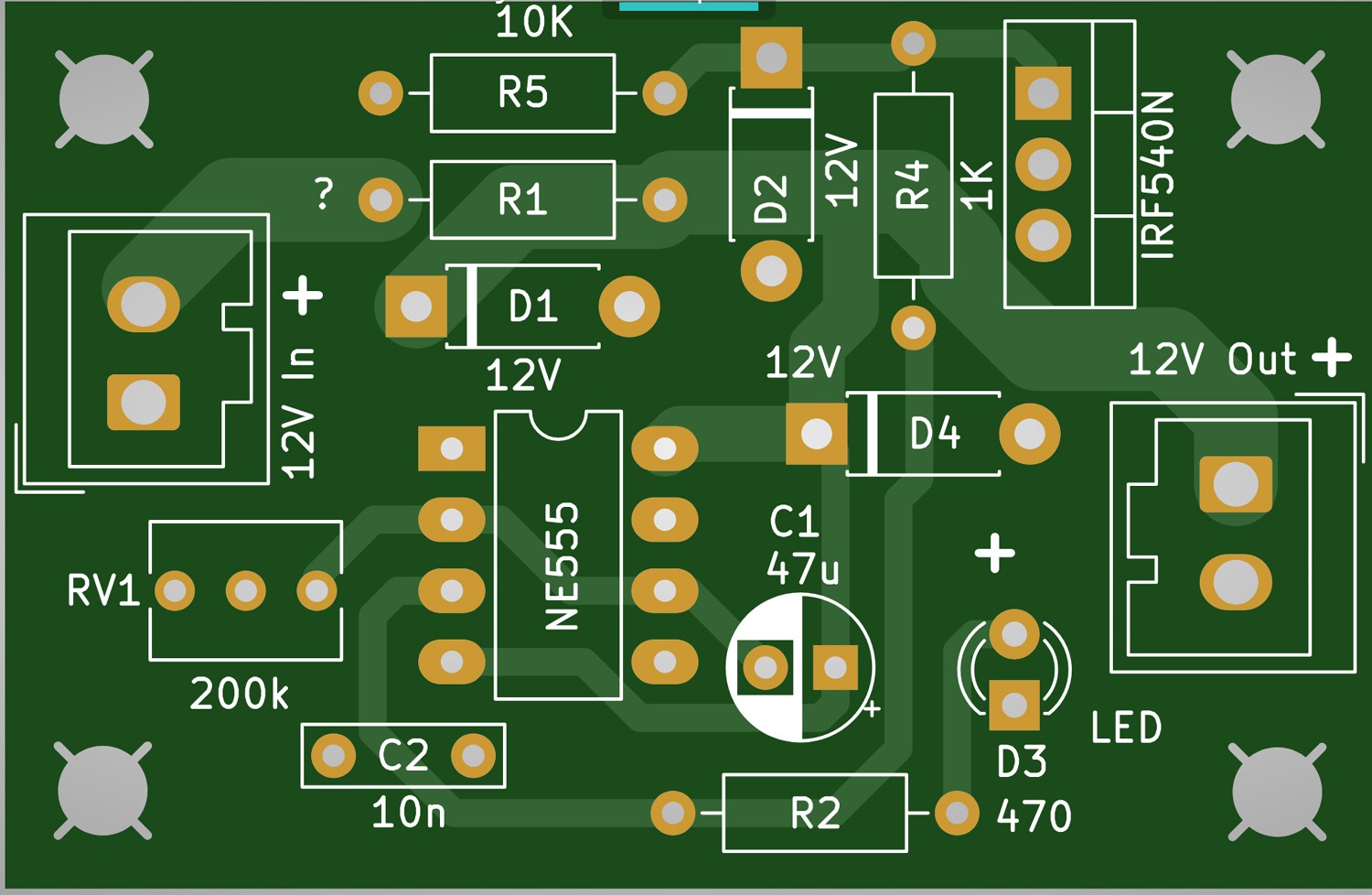

The time delay has one resistor R1 and D1 as a zener diode. If you use 12 volts it is not needed and you must short R1 with a bridge. Because the NE555 can deliver 200 mA, i put a Mosfet for more power to the output. Simple little circuit...

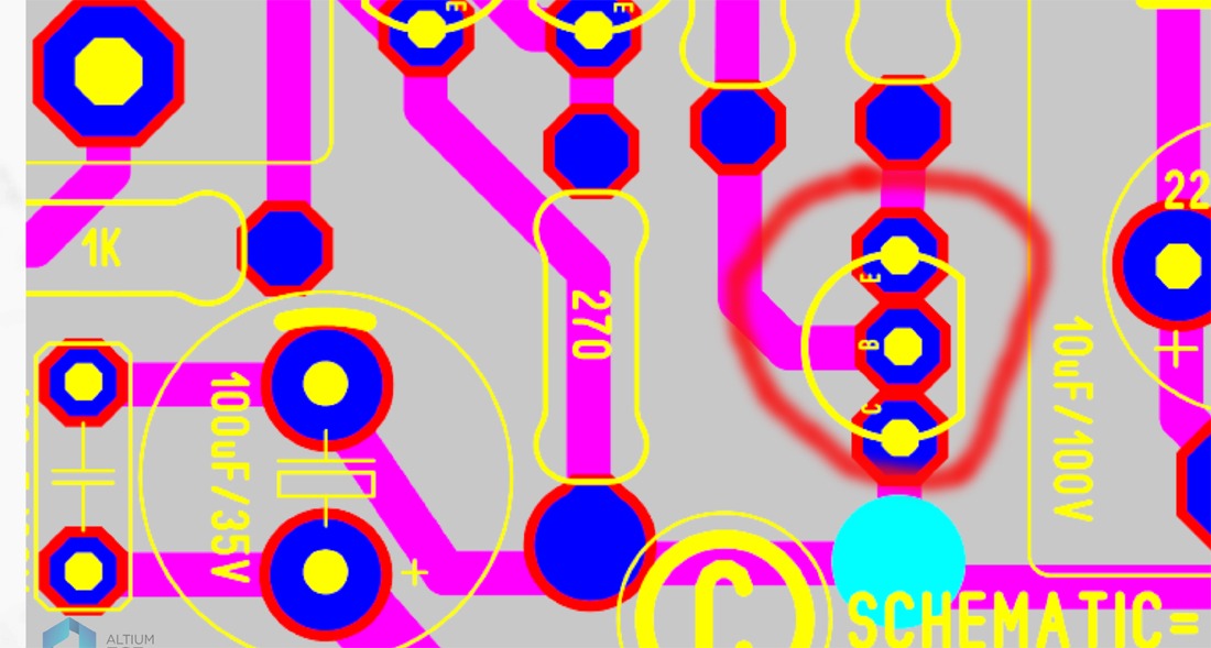

The Board has one missing value for one BC560 at the input

  • NE555 Zeitverz-Gerber.zip

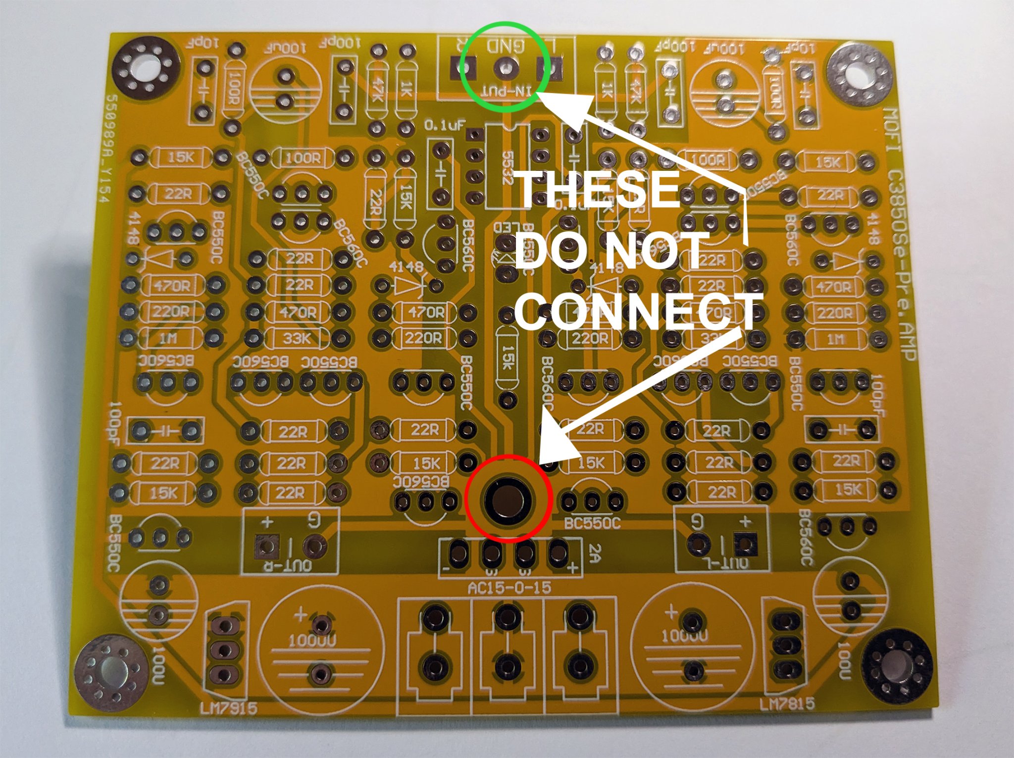

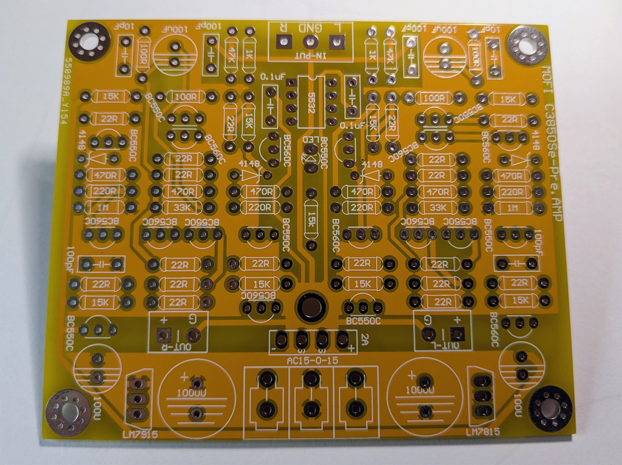

Please STOXX, check the vias of GND with DMM - should be good contact.
because at the dartzeel amp (NHB-108) they have troubles with the PCB
Hmmm, did they think that hole in the middle of the board was on the ground plane?
Is is not connected to anything but it looks like the center point or star of ground connection.
Perhaps this oddity tricked other users?
The board is nice. Ground is good. Yes it has a non-connected hole in the middle of star ground, which is not a star ground.
Yes that is a bit odd.🤔

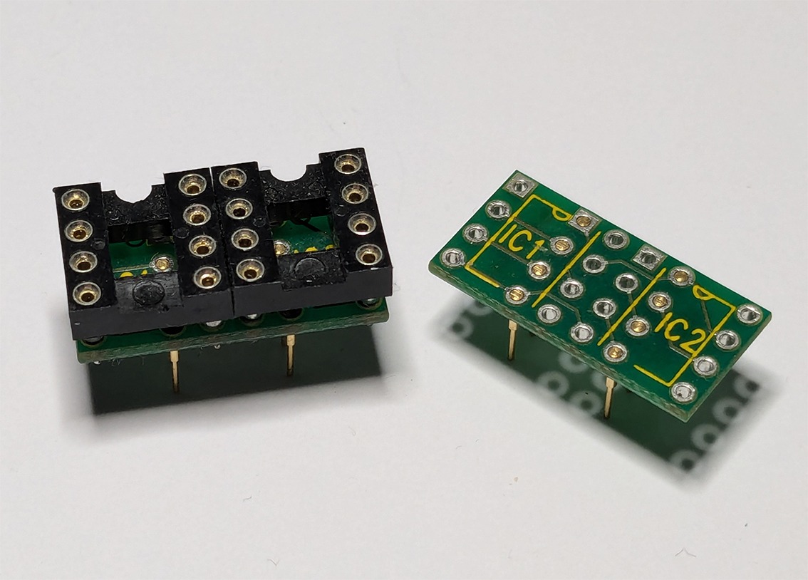

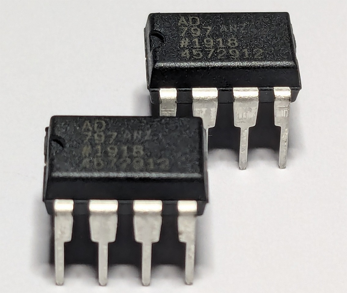

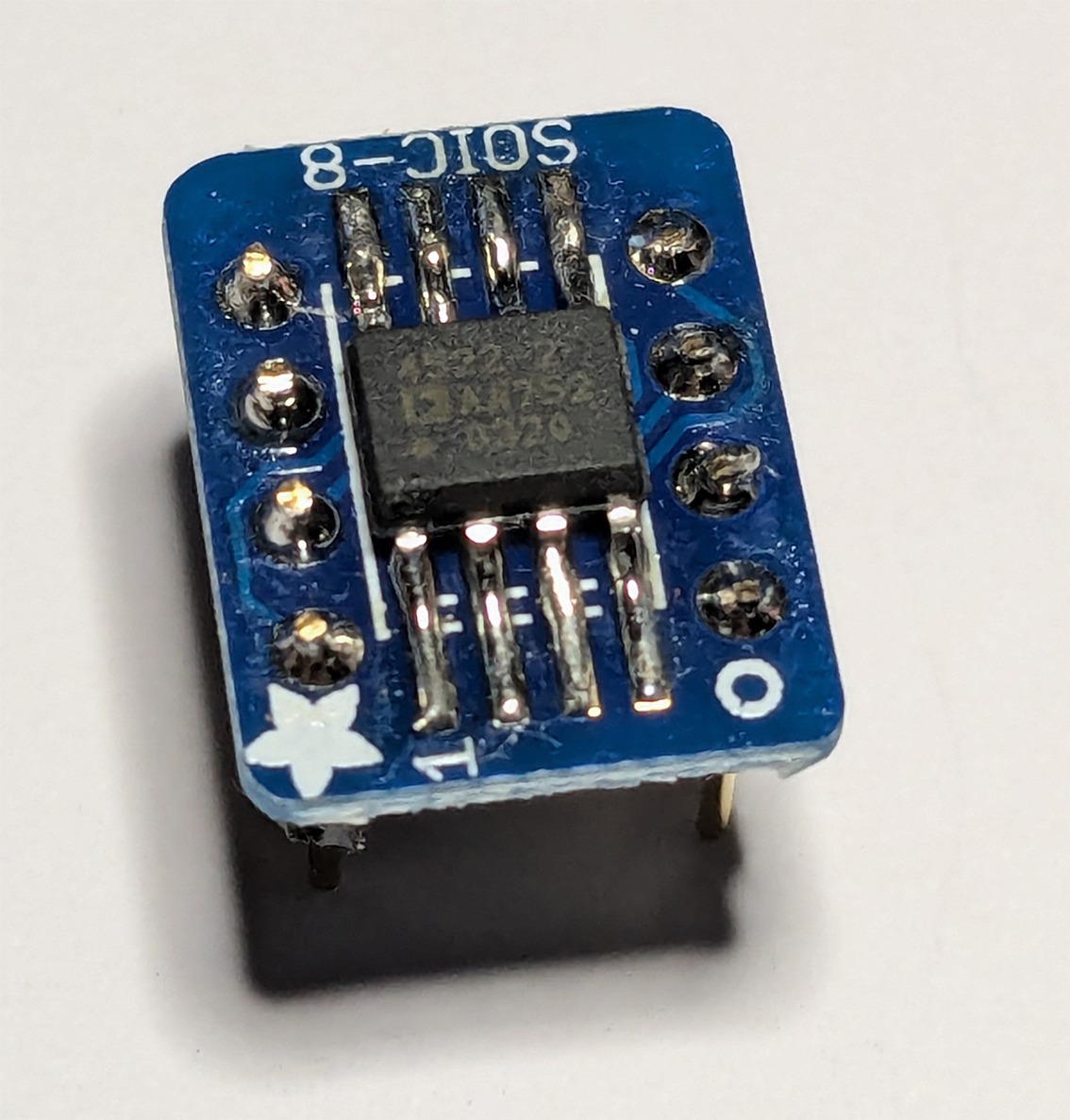

I hope these little dual opamp to single opamp adapters work. I have a wide assortment of opamps but most of them are single but not all....
Hi stoxx
yes the middle looks like that but it is "just" a mounting hole...me too.
chris
