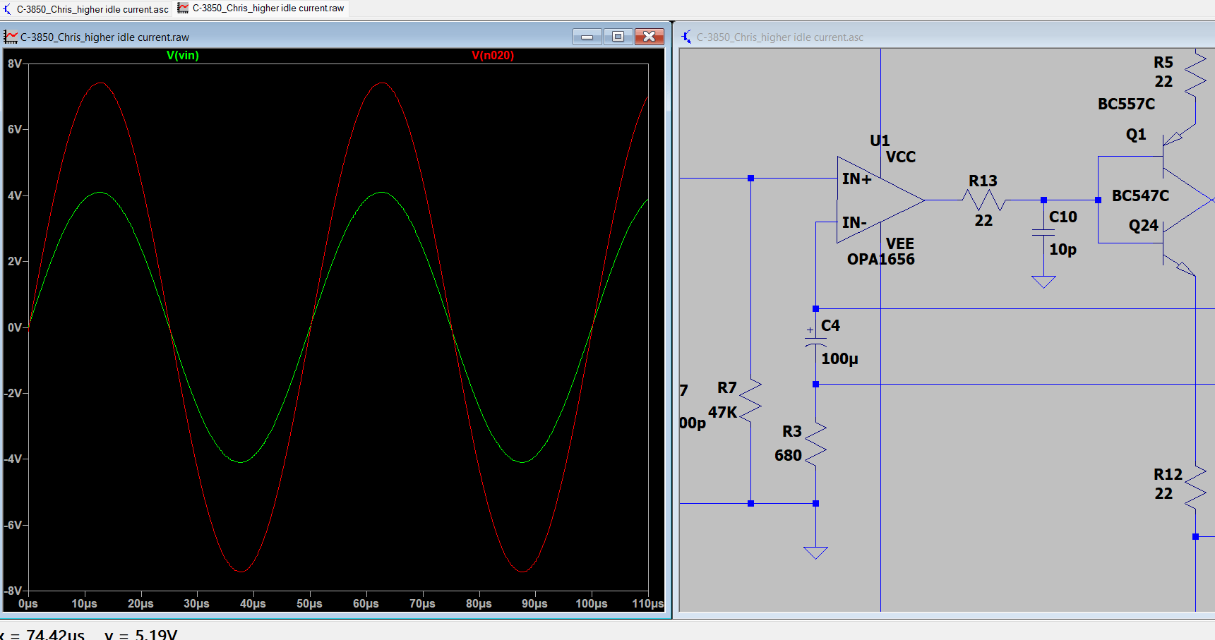

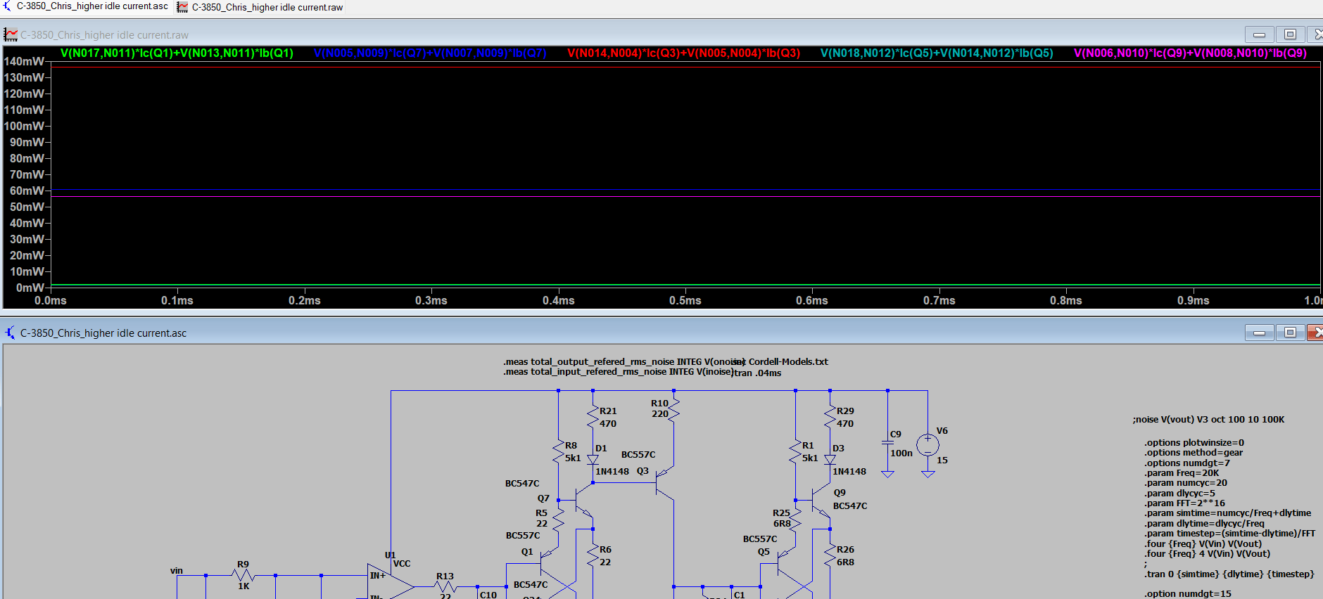

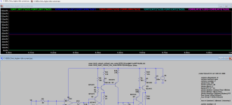

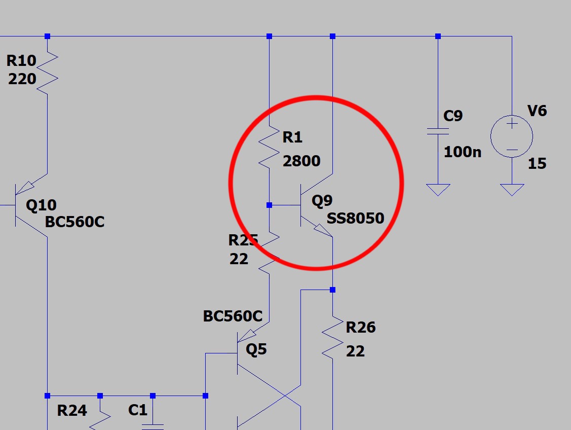

now the LT spice file with higher idle current as here recommended: post 268
Change the 8 x15 k to 5,1k, 4x 22 to 6,8R and the OPA output resistor from 100 to 22R. Instead of 5,1k resistors it is possible to set CRD 3,5 mA diodes.
at all upper resistors
I check
I R8= 2,81mA
I R21= 5,11mA
I R10= 10,84mA
I R1= 2,81mA
I R29= 4,65mA
Summary: 26,22mA each rail

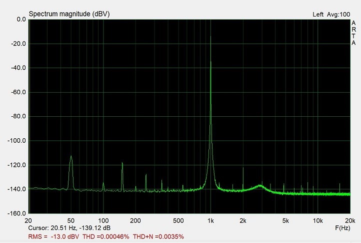

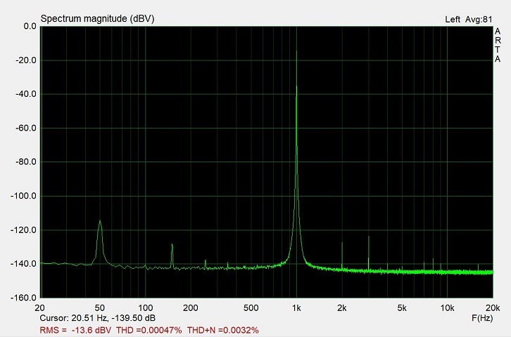

Meanwhile, I have got my brand new toy: Focusrite Scarlett Solo 4Gen.
Here are my recent results. Below, I have shown measurement results of practically unchanged preamp. I have replaced R100 with R300 to reduce gain.
On the first snapshot I have presented measurements of Scarlett Solo 4Gen loopback and in the 2nd snapshot there is measurement of C-3850 at 1.858V p-p output.
Contribution of C-3850 to overall distortion is indeed negligible. Practically almost none. This is really excellent preamp.
PS: Please note that the results presented in post #39 were obtained with somewhat inferior sound card (Xonar U7 MkII). Now, we have much better results.

That's the none modified version right?
Any idea what may cause the small bump around 3k?
Yes. I have used all components from the kit, assuming that there are no "Wunderwaffe" (Ger: Wonder veapon) components that would improve the sound. Results prove that assumption.That's the none modified version right?
Regarding the sound quality I absolutely concur with you. The entire audio chain must be as close as possible to the ideal "amplifier wire". Then we may listen to the original recording. Adding sound to the original just obfuscates technical problems that exist elsewhere: bad recording, inadequate mastering, low quality DAC etc. Then, one assumes that addition of distortion solves the existing problem. In fact, this just makes it bearable.

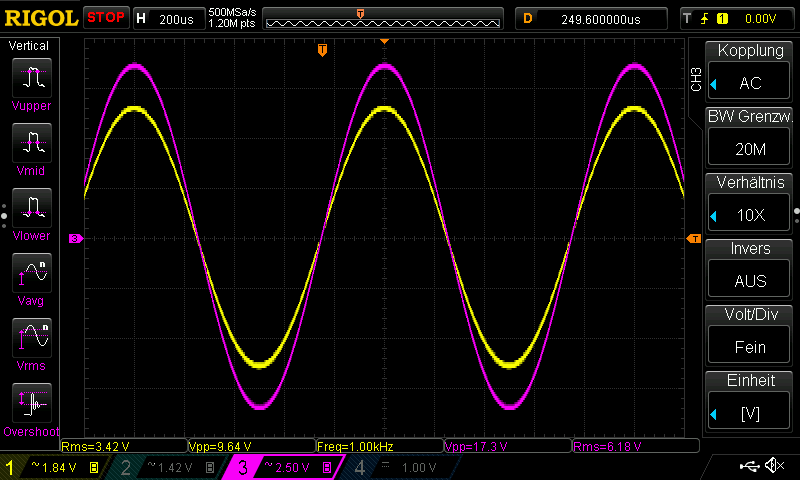

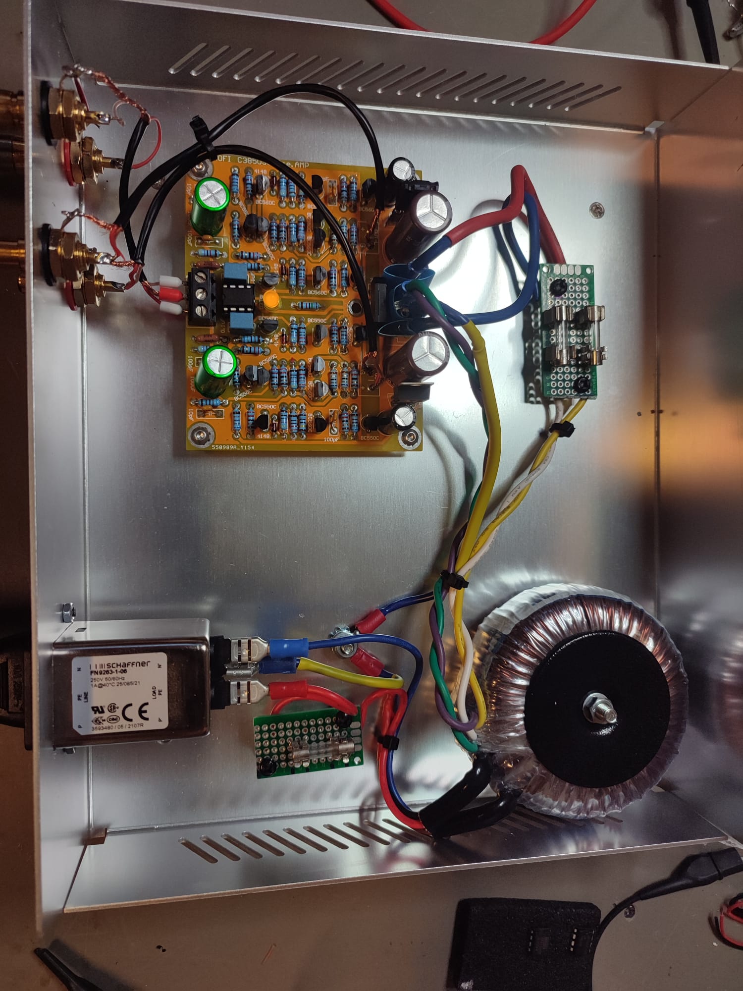

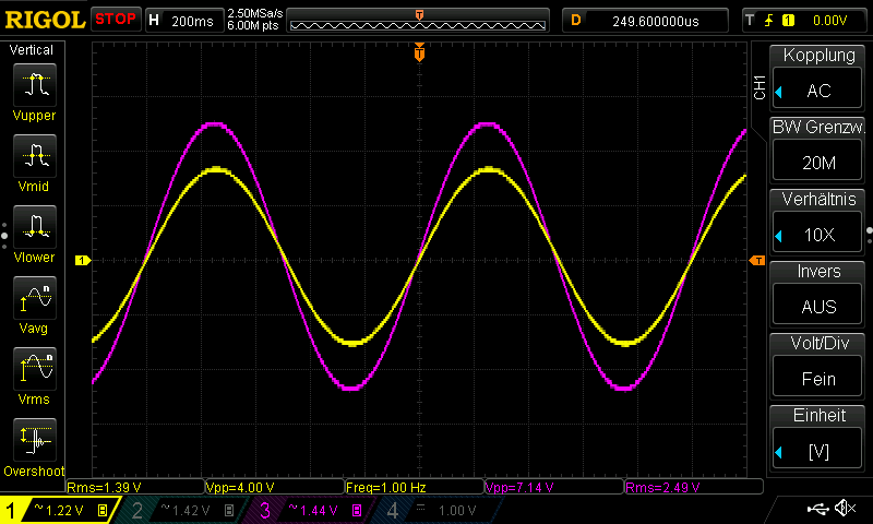

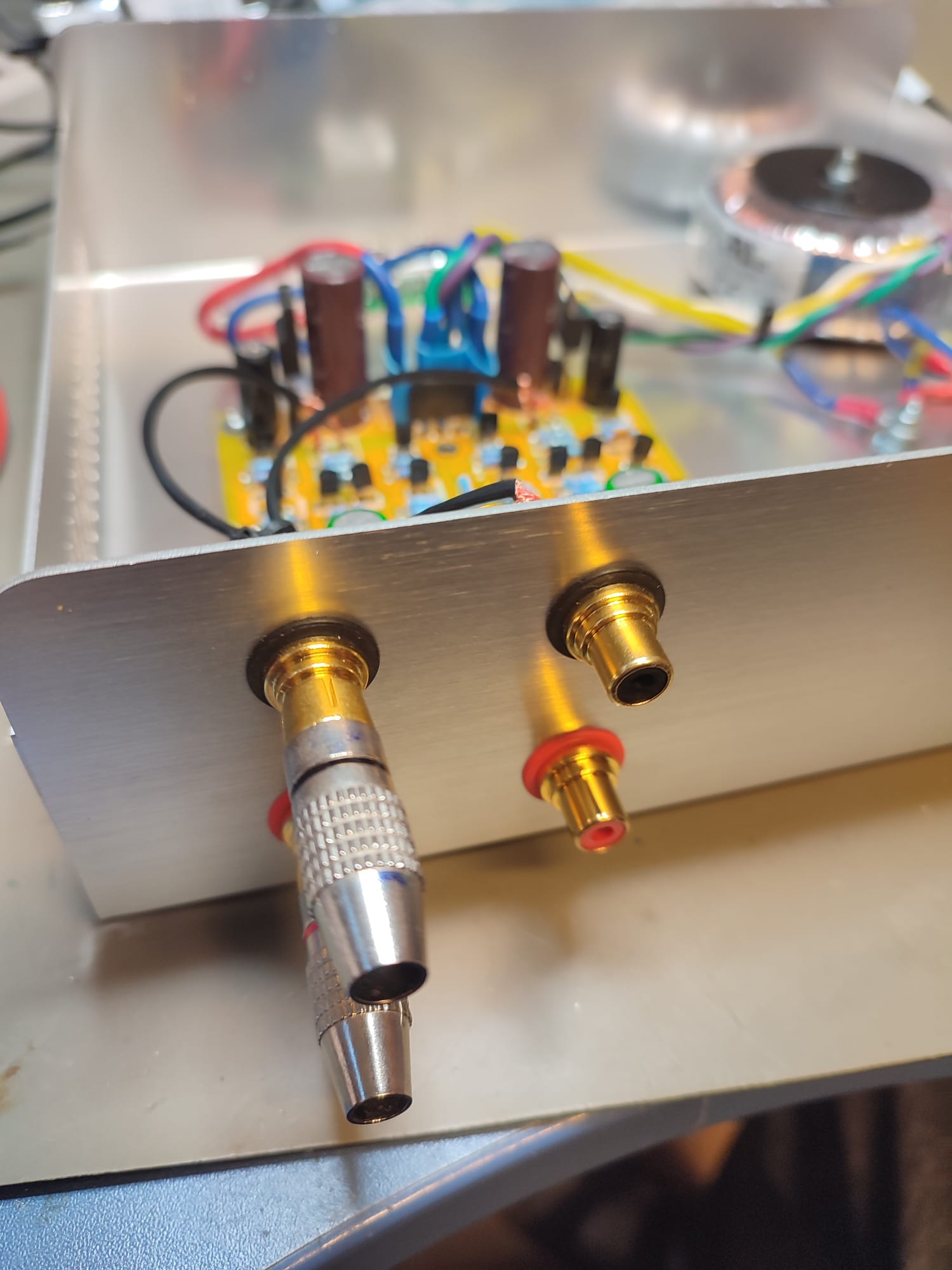

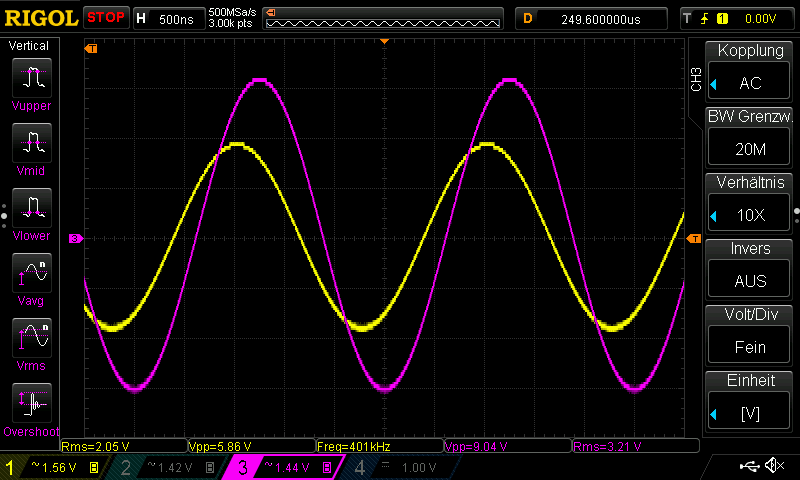

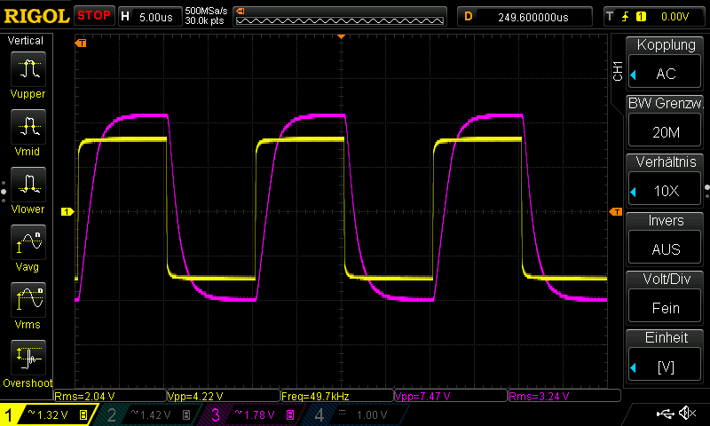

Hi
building finished. Test okay. setup is with bigger idle current. OPA LM49720 is inside now.
under the pcb i solder additionally to the film cap to each rail a 10µF silmic 2 cap.
Gain 5,14dB, DC offset is not immeasurable 0,00mV
input shorted and load is 10k ohms.
maximum is 3,3Vrms without getting clipped..that is 17,3Vpp!
test is done with 2Vrms input:
fg low is 1 Hz
fg high is about 400kHz...could get more but the phase shift is for me enough...

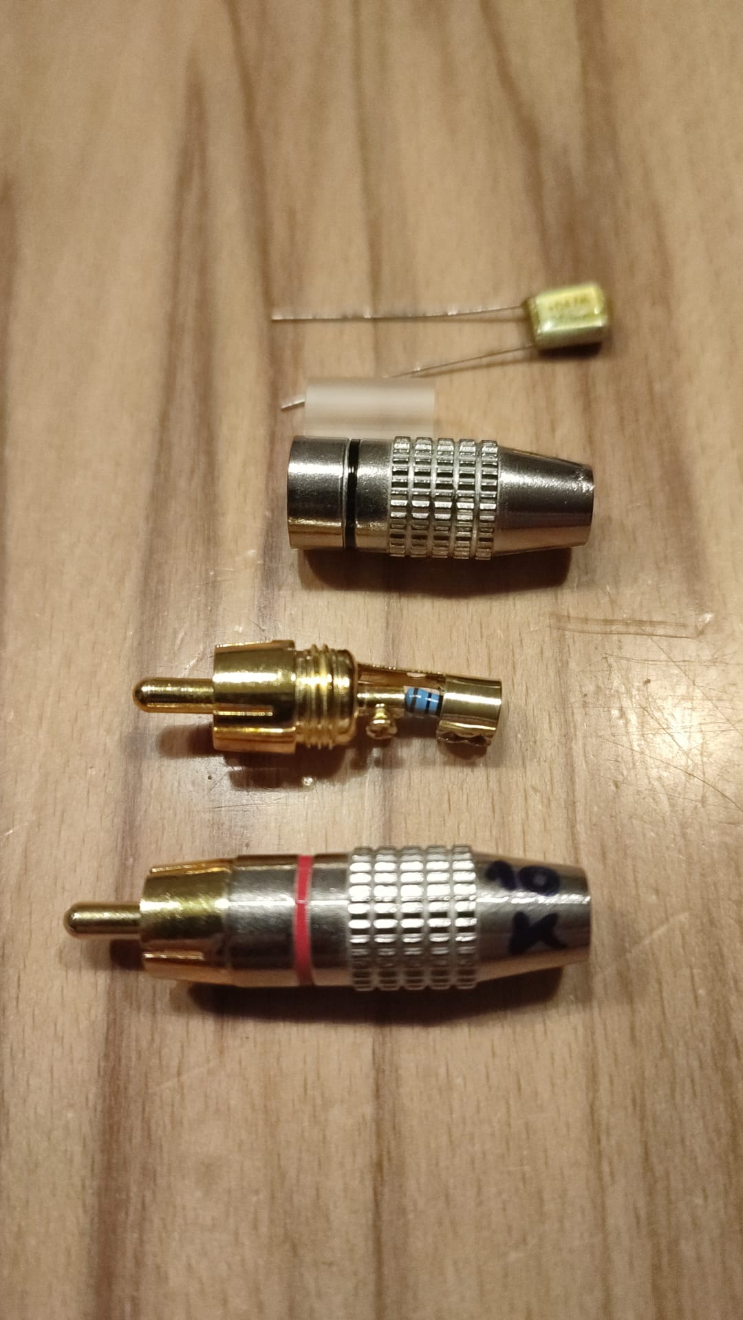

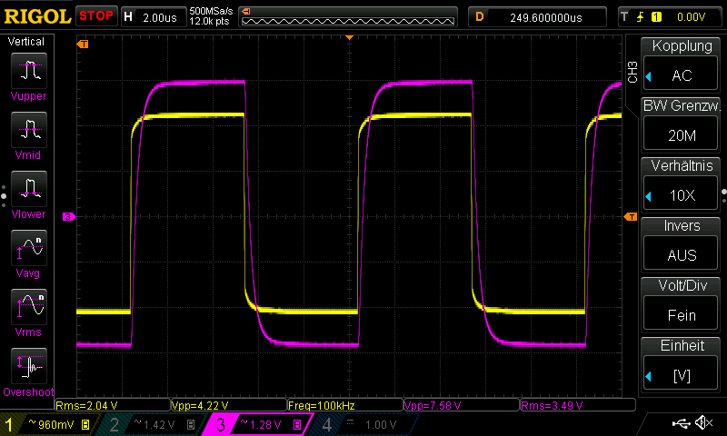

square wave tested with 10kR +47nF(49,4nF)
pro:
sound is in the first 20 minutes hard and "forwarding"...partly annoying...after 4 hours I can say without comparison with other pre amps:
this pre-amp is quick, sound neutral, deep bass, high are very open without S, Z, TZ, noises.... sound stage is deep and wide,...
cons:
a little bit more ground is missing- singers should have more feet, piano is always a bit hard, less body at singers and instruments( short/less resonant)...but it is not fair i own a NUVISTA 600 integrated.
the pre-amp has a loud turn on/off pop - so switch off the power amp !
fine preamp.
chris
