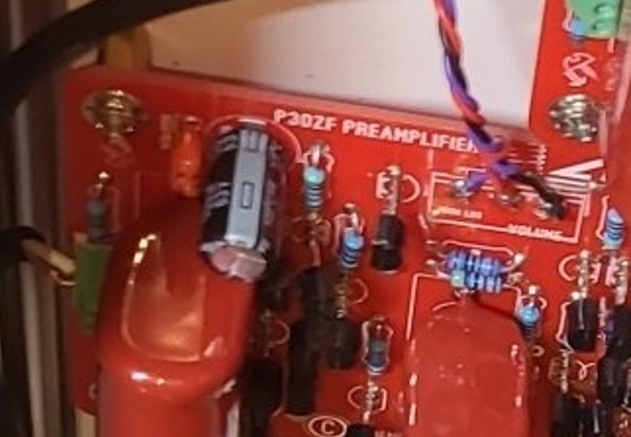

As i wrote before... i had hum too with the C3550 preamp, but it was my mistake. Something was not soldered right because of my changes of some components. Very rare mistake, thinking of the lead free solder....
Don't know what the reason of the hum in your preamp. I think its a faulty capacitor. Faulty from the beginning. That may be the cause for a higher current too, to blow the fuse. Unbalanced current in the secondary windings...just a guess. I don't think it is a small capacitor, must be one of the big ones after the diodebridge....
Perhaps you can see something on the lid of the capacitor ? A minor change ?

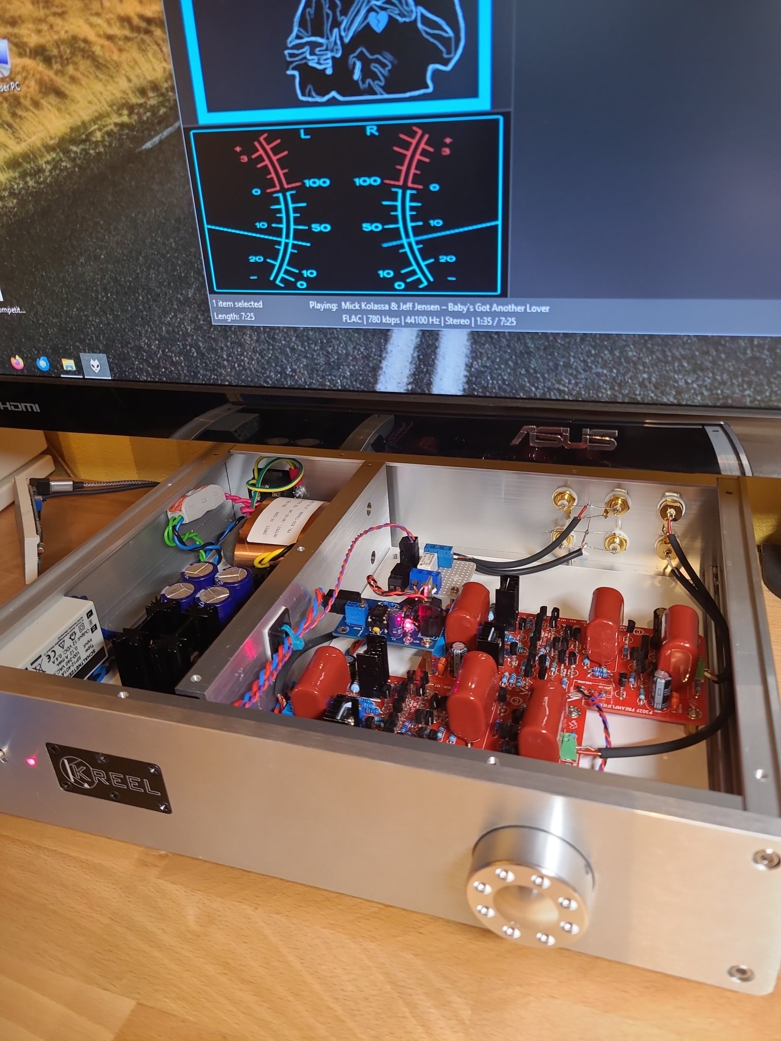

pre amp hum:
as i wrote yesterday i just check the fuses and i was wondering that the prim. fuse with 315mA is blown. both sec. rail fuses with 100mA were okay. it is not nice to know that the primary fuse was blown...therefore...
in my lab i checked again the signal in and out with fg and scope...nothing special.
i go to my room for listening. switch on everything and sound was playing. after a short dinner a was back and the sound was fine. no hum.
after an hour i realized between switching of some titles that i got a hum...wtf...thats loud...!!!!
i checked all connectors - nothing. after this time i always get an increasing hum after turn on the pre amp.
today morning i checked again with shorted inputs. so the DAC does not make troubles...fine..
other power cable or RCA connectors doesnt help.
hum is at starting very low but increasing after 20-30 seconds to loud!!
i will check again...today afternoon and will report back. maybe my power amp get with the pop a damage?! (FX8 ) hopefully not...

Sounds like you damaged the input to the opamp and/or the front end is wired wrong.hum is at starting very low but increasing after 20-30 seconds to loud!!
Or your power supply has an error in it or how it is connected to the circuit.

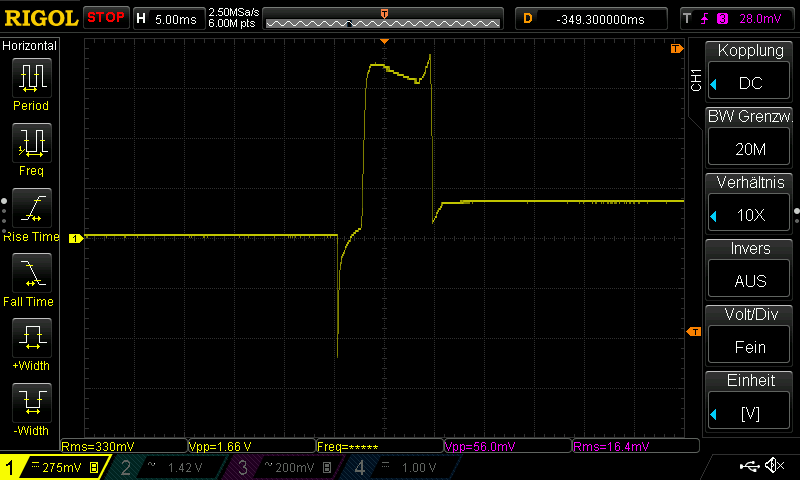

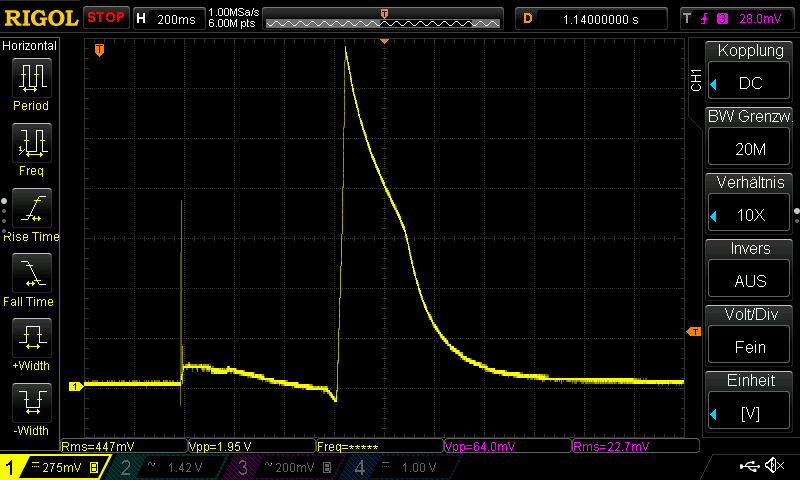

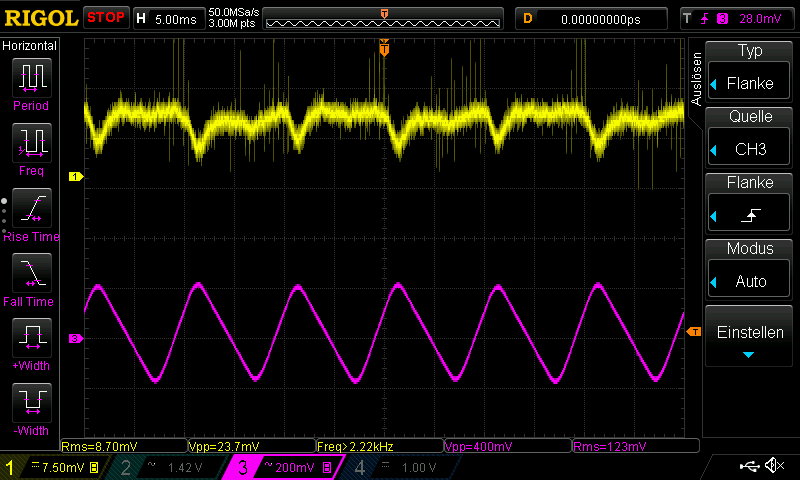

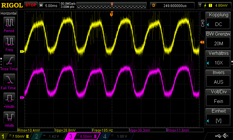

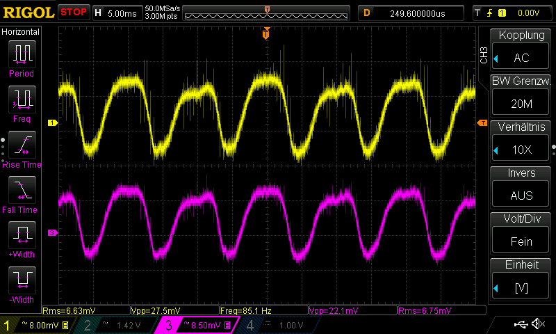

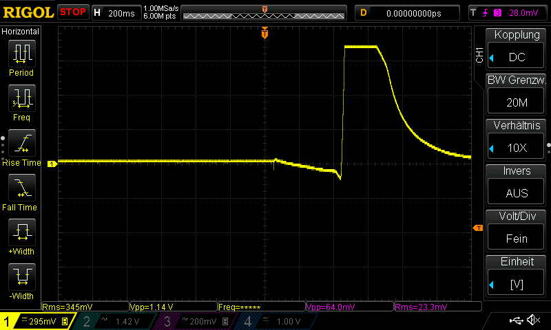

i probe around the pre amp...searching...

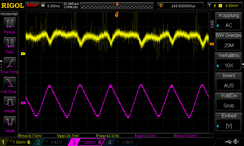

input shorted...to much ripple. 50Hz is visible.
RCA with DC coupling you see about 10mV DC offset...with DMM i measure about 6,6mV each RCA.

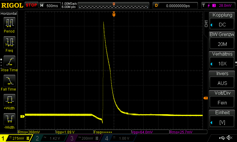

pop on and off is huge if you think you have about 1,5Vpp into a power amp!
connection earth show with LCR Meter (DCR) 0,08 ohms.. so no problem.
RCA checked no bad connector --> no contact to housing -earth

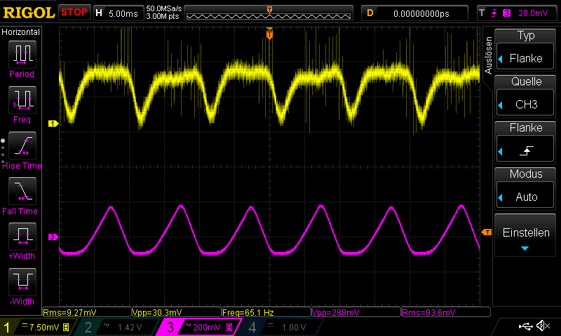

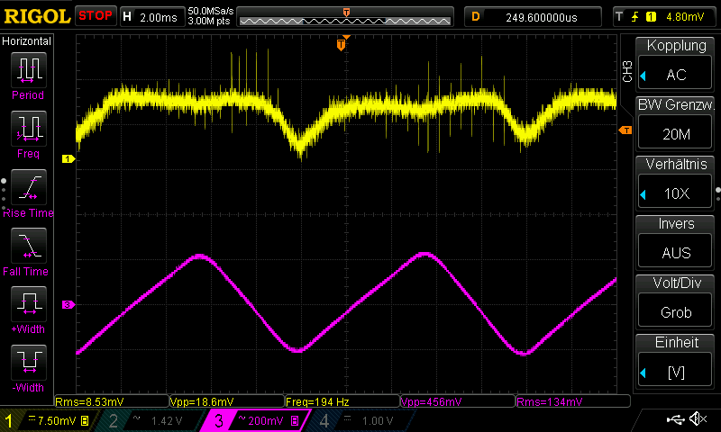

I am wondering about that "time delay". RCA is ok, you changed the opamp ...🙁
I would search for a bad transistor or capacitor.... the rail voltages are ok and nearly the same ? No faulty diodebridge ?

Did you couple those 2 transistors close together? Maybe temperature drift.
You match transistors firston Ube them on Hfe.

Chris, you are temping fate with this risky turn on/off sequence.i think i did yesterday a stupid thing.
after switching off the pre amp i heard a loud pop. then i made the mistake and switched again on - the same - POP!
okay now i realized that the on/off pop is loud...****...then i switched off without power amp.
Power amp should always be turned on LAST and turned off FIRST.
You can potentially damage the downstream amplifier and speakers from preamp on/off transient voltage.

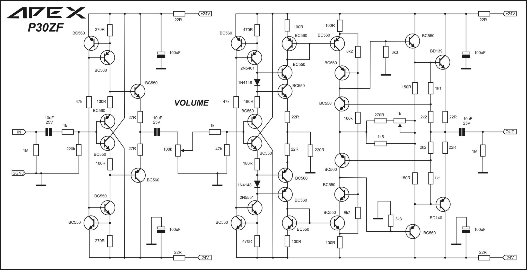

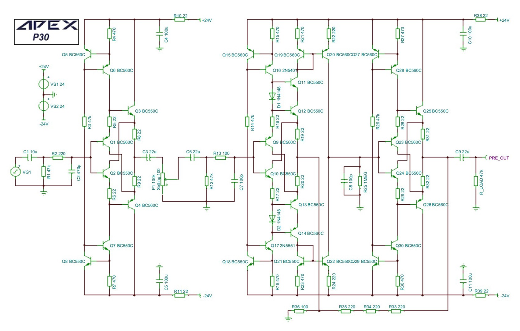

Hi STOXX,
you can read about https://www.diyaudio.com/community/...delity-amplifier.164093/page-659#post-6341301
Years ago Apex was so kind to give a few schematcs to the comunity. The schematic of the P30ZF was one of them....
I can upload the gerber files. Mono or/and stereo

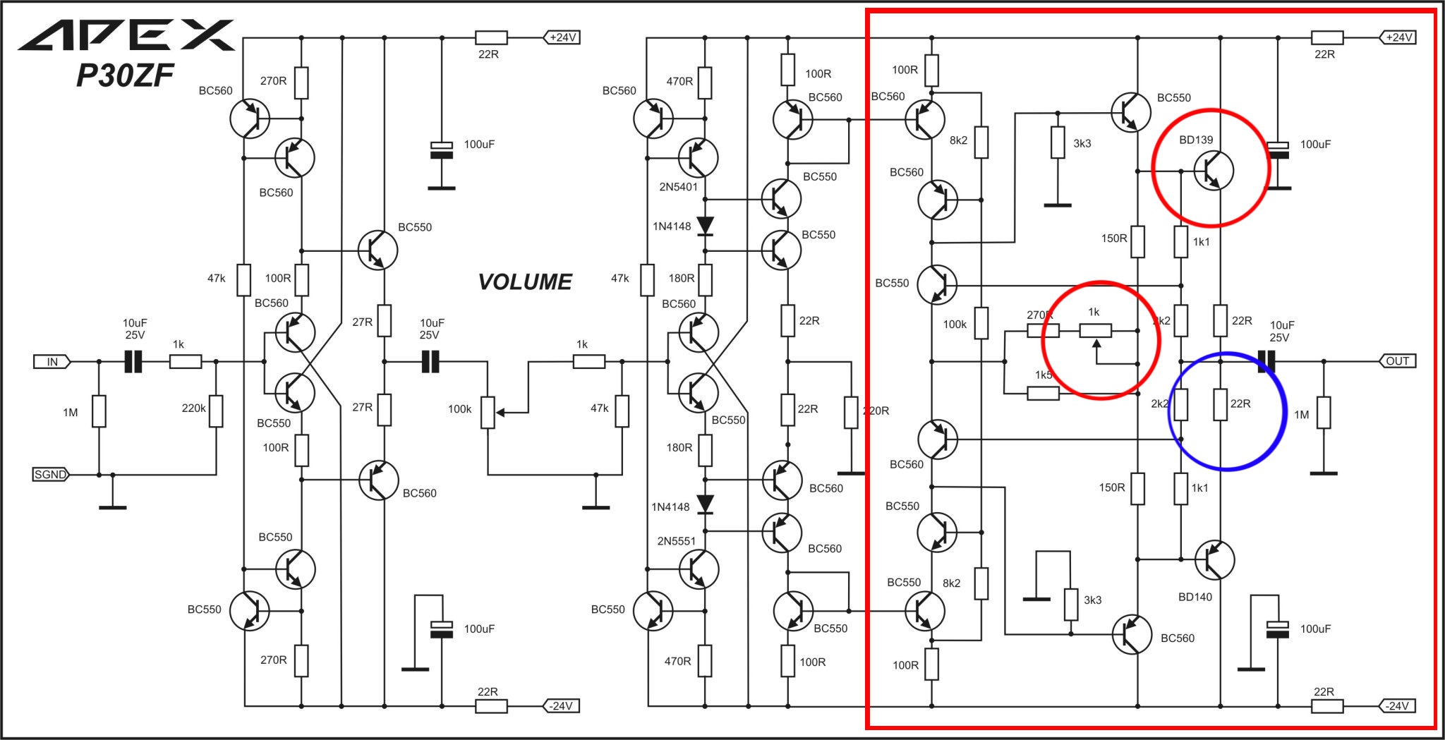

Is this the schematic you worked with?The schematic of the P30ZF was one of them....
Very similar, but i the P30ZF has smaller capacitors in. There are 10 uF build in and only three...The input is different and other components.
I dont know why there are two different versions, don't know about the meanining of "ZF".
I found the P30ZF on youtube first, not here in the forum. About the existing of another version (P30) i had read later, but had the P30Zf ready build....
The threads are a chaos, as Chris wrote. Nothing is realy splitted to themes...
