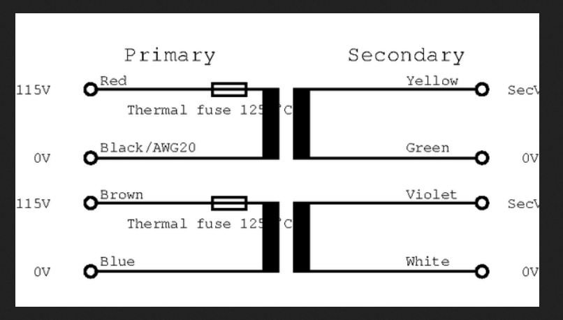

i have to correct my self: i mixed secondary and primary in post 320
thx
this transformer is a 2x secondary and 2x primary.
if you are in a country with e.g. 230/240VAC then you have to connect the primary in series. the the windings are prepared for 230VAC primary.
if you are in a country with 115VAC the you have to use this windings in parallel.
each secondary:
15VAC with 1,67Amp is 25VA
link to the transfomer

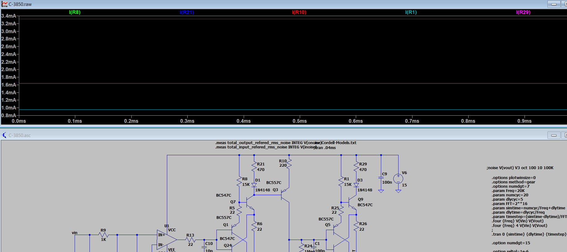

I know. But you were talking about the fuse needed and the primary current in post #320.
You mentioned the primary current is 2A but the EMF filter is just 1A so you need a 1A fuse.
That's confusing me.
If the secondary current is 1/10 to the primary.
To make the fuse blow at 1A then you will have 10A in your secondary.
I guess your circuit is already long gone before it reaches that level.
I think you should use different "calculations" depending on the design and consider inrush current.
A power amp with high inrush current should be approached differently from a low powered pre-amp without no inrush current.
Also the type of fuse used... Slow blow or fast blow is something to consider.
630mA looks ok for 50VA use, but how much does the circuit actually use?
From Sherman's calculation 2 times 15mA, with 15V gives 450mW.
With some headroom thats let s say 1VA.
1VA is something else the 50VA of the transformer used.
A 630mA fuse in the primary will blow if you have 6A secundary.
I would go for something around 40mA.

i made a mistake...i wrote wrong.
primary you need less current... because of the 230V
secondary we nee just 100mA or less fuse.
no
it depends on the ratio of the transformer.
Correct. The ratio from the transformer determine the voltage and current ratio.

a transformer has 3 fuses.
  1. primary fuse to safe the wire on the primary windings
  2. secondary fuse for the caps or load which can draw too much or a defect diode array or whatever
  3. thermal fuse which is in between the windings - about 45-50°C
oops the attachment in post 324 is the wrong one.
in the datasheet you see that fuse
for an power amp e.g. APEX FX8 is a rail fuse installed too.
it is on the person who is "designing" the box....if you are a fearless amp builder FAB then you don´t care about dimension with some margin and try out with no safety things like SSR or DC protection.
chris
