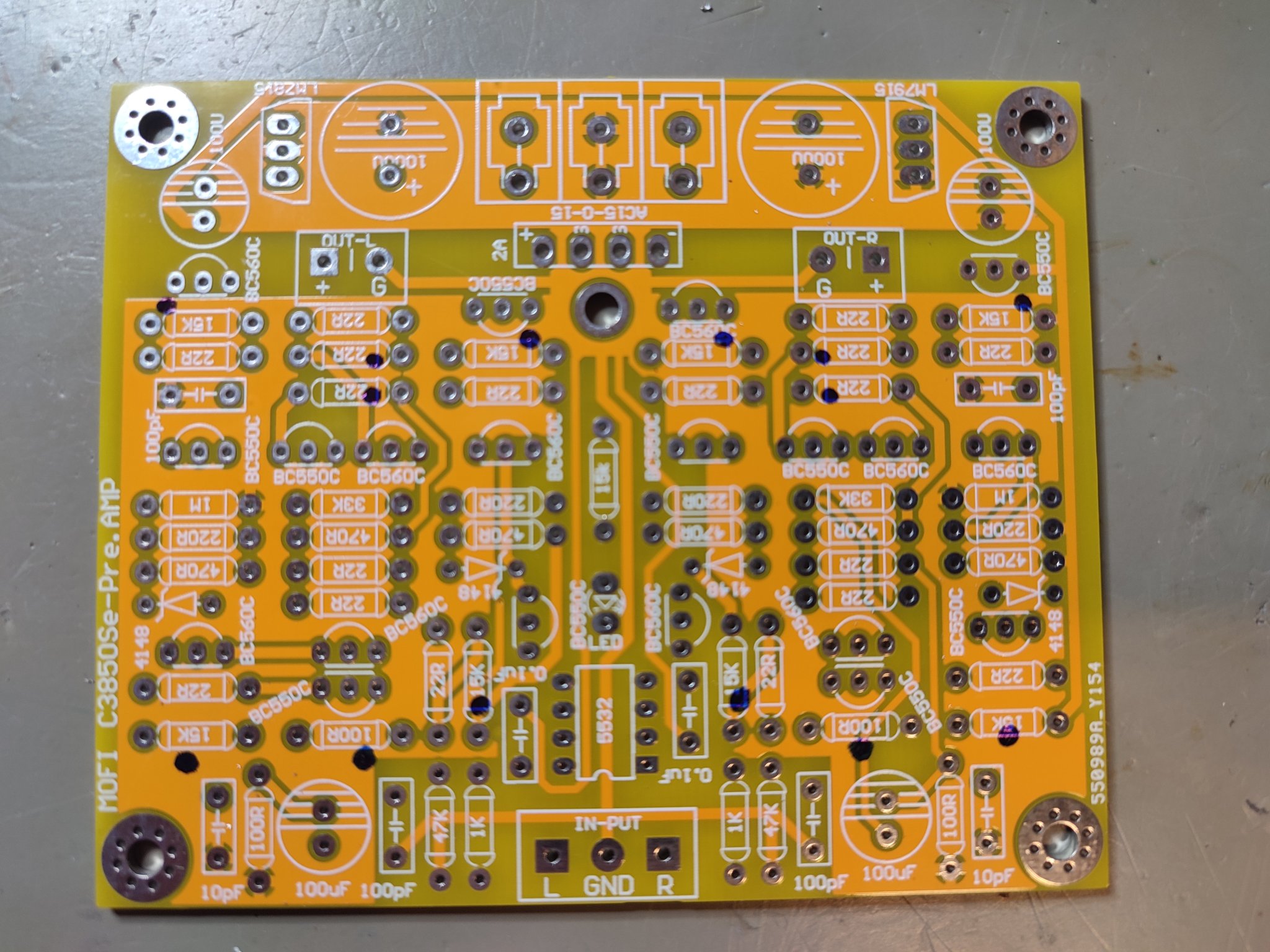

Here are the 8 x 15 k resistors, 4x 22R and the 2x 100R resistors for change at the mofi PCB.
Marked with dark blue dots.

  1. my proposal is to use a low current Regulator. the 500mA 7815 has a better noise level then a "normal" 7815 with 1A.
    cost is less and the function is a bit better for this preamp.
  2. as written above post 267- change the resistors to the values that you have a bit more current.
    the 15k - you can solder 2 in parallel - you get about 7k
    22R - use 3 pcs the you get about 7R
  3. OPA output resistor to 22R
kr
chris
If you have - like me just- 6k8 then use this and solder parallel a 20k under the board. ---> 5k1

the improvement is for all stages (IPS, VAS, OPS) more current and therefore more level of Class A modus. this is normaly less THD and give a pleasant sound.
