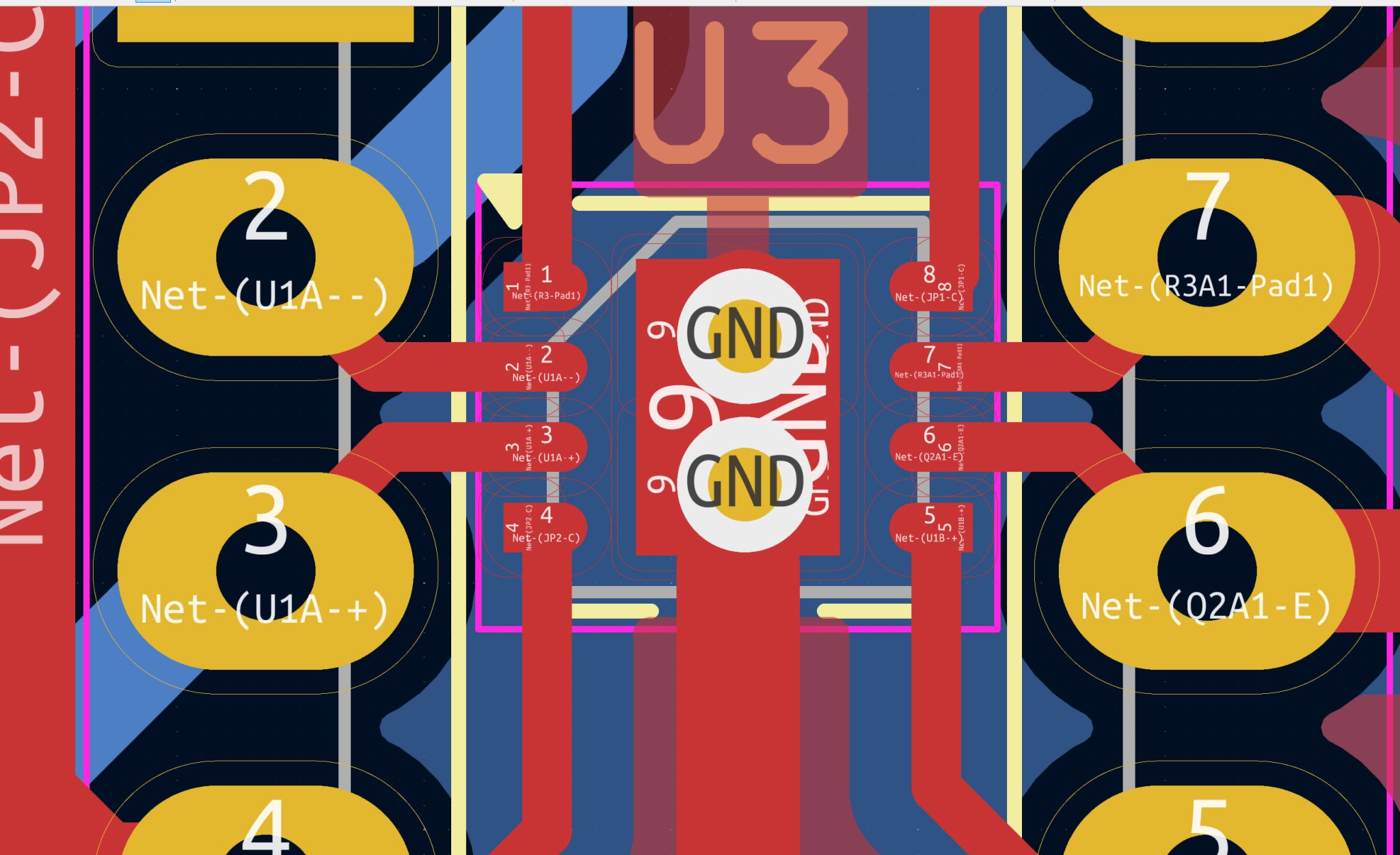

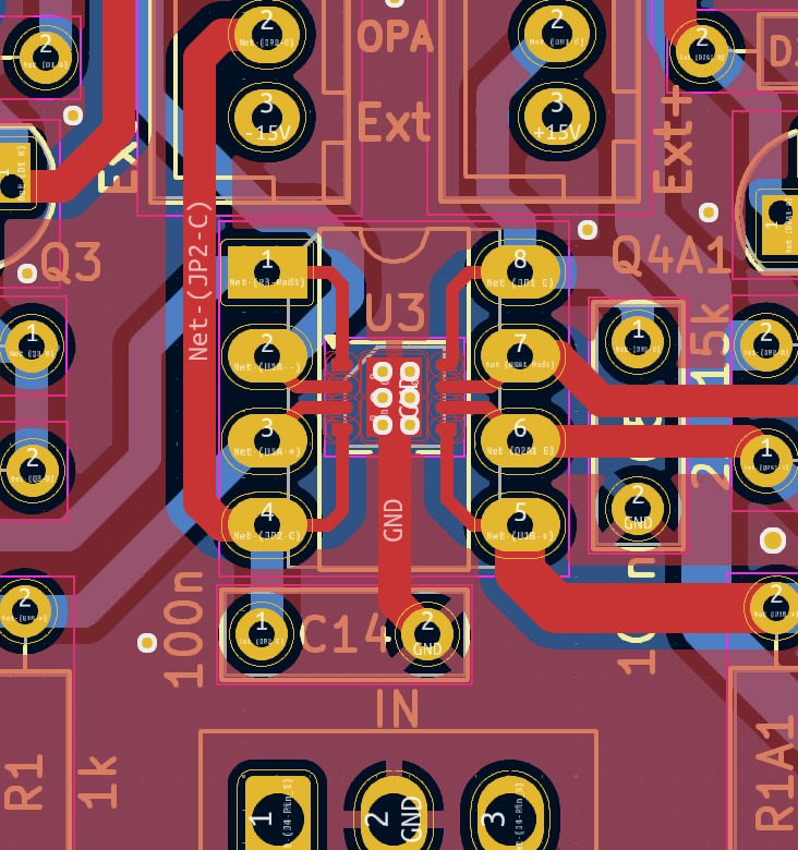

A couple thoughts about the smt opamp in the layout. An 0805 size 100nf/50V cap could be placed by the opamp at pin-4 and pin8.
The footprint suggests a no-lead package. If soldering by hand with a soldering iron, you may want to extend the pins outwards so that they are accessible with the soldering tip. If needed, shave the pads or use circular pads on the DIP opamp footprint to make room.

I can give more space with other pads, thats possible. There are 100 nf at pin 4 and 8. You cant see on the last picture. Or others ?
It is possible to make 2 different gerber files, one with the "normal" OPA and the other with SMT. Perhaps the better solution..

I did see them through-hole caps by the DIP package, and they are as compact placement as you can get. With SMD option you can do a lot better in minimizing the rail decoupling loop area, or parasitic inductance. This can be helpful for some opamps. Modern opamps even designed for audio can have gain*bandwidth far out to 50MHz or higher. By putting smd caps close by the smd opamp, the decoupling loop area becomes probably 1/3 or less that in the case of DIP opamp. Not saying they will certainly make a difference, it's more about have them and not need them vs not have them and need them.

No way....i spent over two hours now to find a way to connect a standing alone OPA with thermal pads on the pcb properly.
Kicad only accept the red tracks "F_cu", on one side of the pcb to connect this OPA. It seems not possible to find a way to connect the tracks only on this side of the pcb. I have one track i can't connect without a crossing.
I have to give that up...its against tht concept of this pcb.
What is to do? One gerberfile exists with an footprint for one dip8 ic. One gerberfile i can upload for an OPA with thermal pad and dip8.

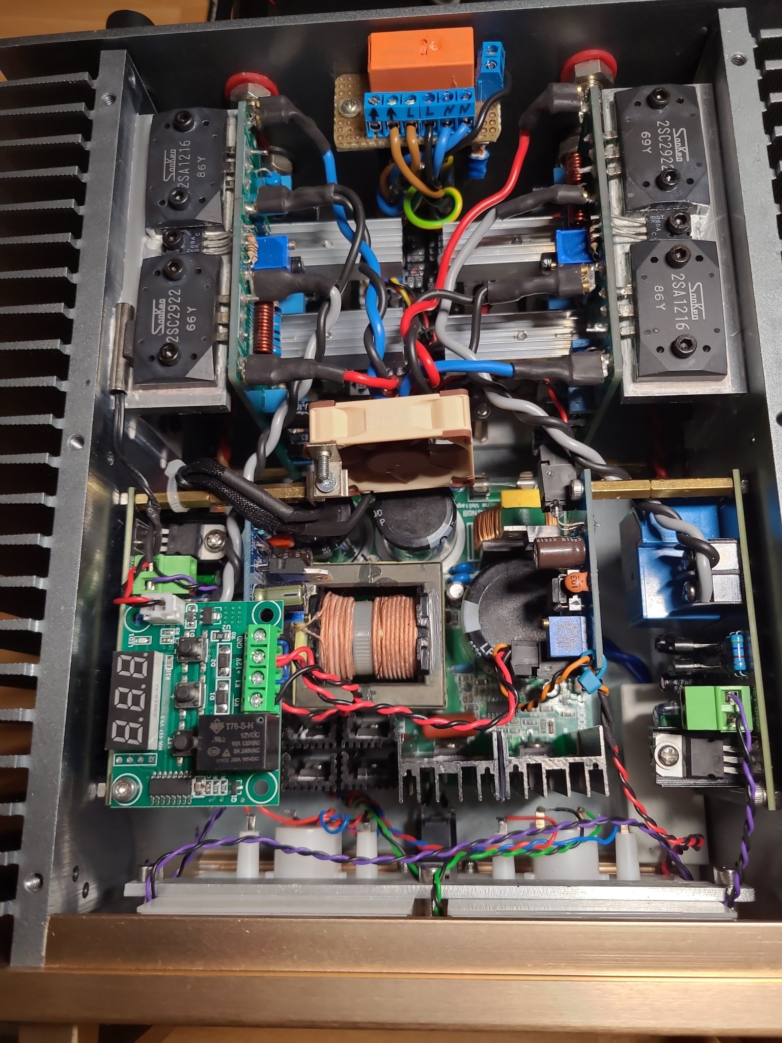

I have taken a picture of my goldmund clone. Yesterday morning the amp worked fine at home. In the evening at regulars table it worked only on one channel, failure with one speaker protection. The voltage the connection i guessed.
I had expanded and connected to my laboratory power supply, all ok. Built in and it works....😳

I have made an update to the pcb. Some tracks had to be changed to put an OPA footprint with thermal pad in. KiCad does not like that, two footprint in one.
But it seems to be no problem. I uploaded the gerber files to pcw way and it seems to be fine.

i am not an KICAD expert.
you can use the via (V) to make connection to the B_cu layer..maybe that helps
