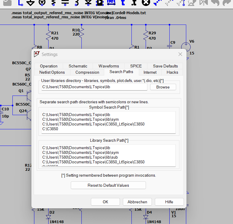

Yes, I did that. Changed it to BC550C. This also changes the transistor under "Transistor Properties" (when right clicking on the transistor symbol) to BC550C. Still the same result.Instead of the symbol, can you have a try right hitting the value of that transistor itself, the wording that reads "BC550C_C", and see if anything there can be messed with?
In the pick transistor list, there is not any BC550 or BC560 or any variations.
Opening standard.bjt as a text file with Notepad. Search finds only BC550C_C and BC560C_C. Search through Cordell-Models.txt finds only BC550C and BC560C. For some reason, LTspice isn't using those files.
Also tried "Update Components" under Tools and that didn't work.

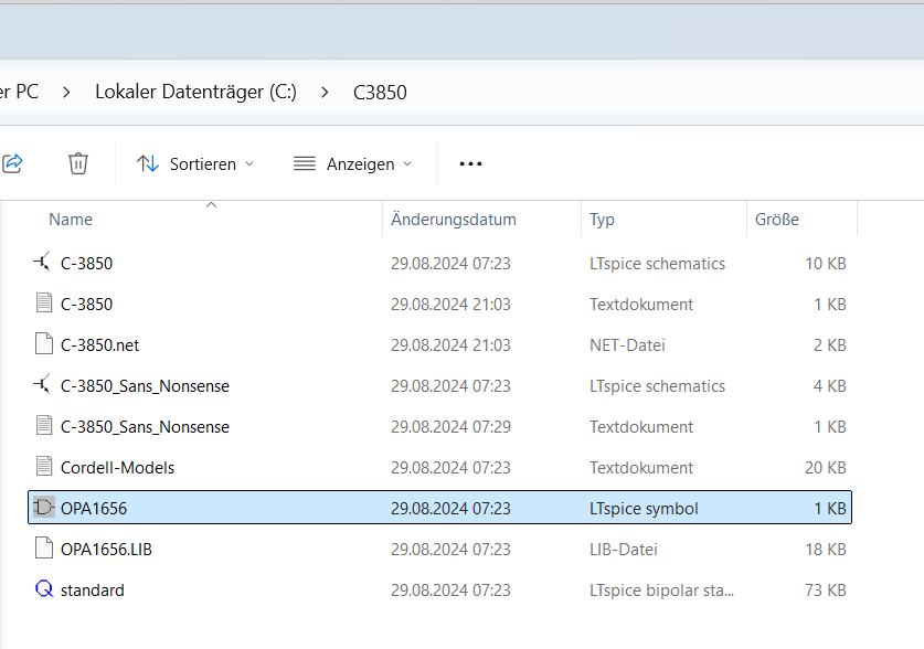

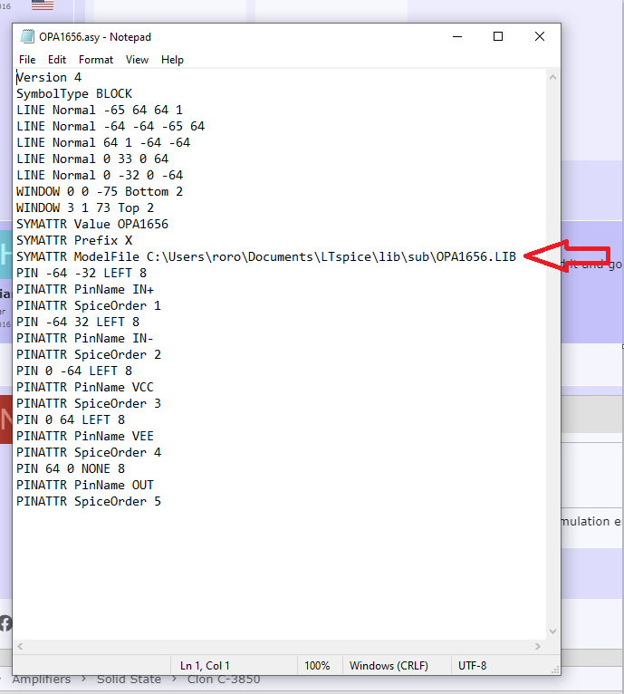

Unlike the way it use to be, LtSpice now seems to treat the \users\???\documents\ltspice\ as if it's its private territory, and any altering/addition to the content may have likely been ignored or rejected, including the added \3850 folder. How about trying put folder \3850 under c:\, and adding c:\3850 to the search path?
i made a small circuit by my self from scratsch and it is working...i really dont know what is wrong.

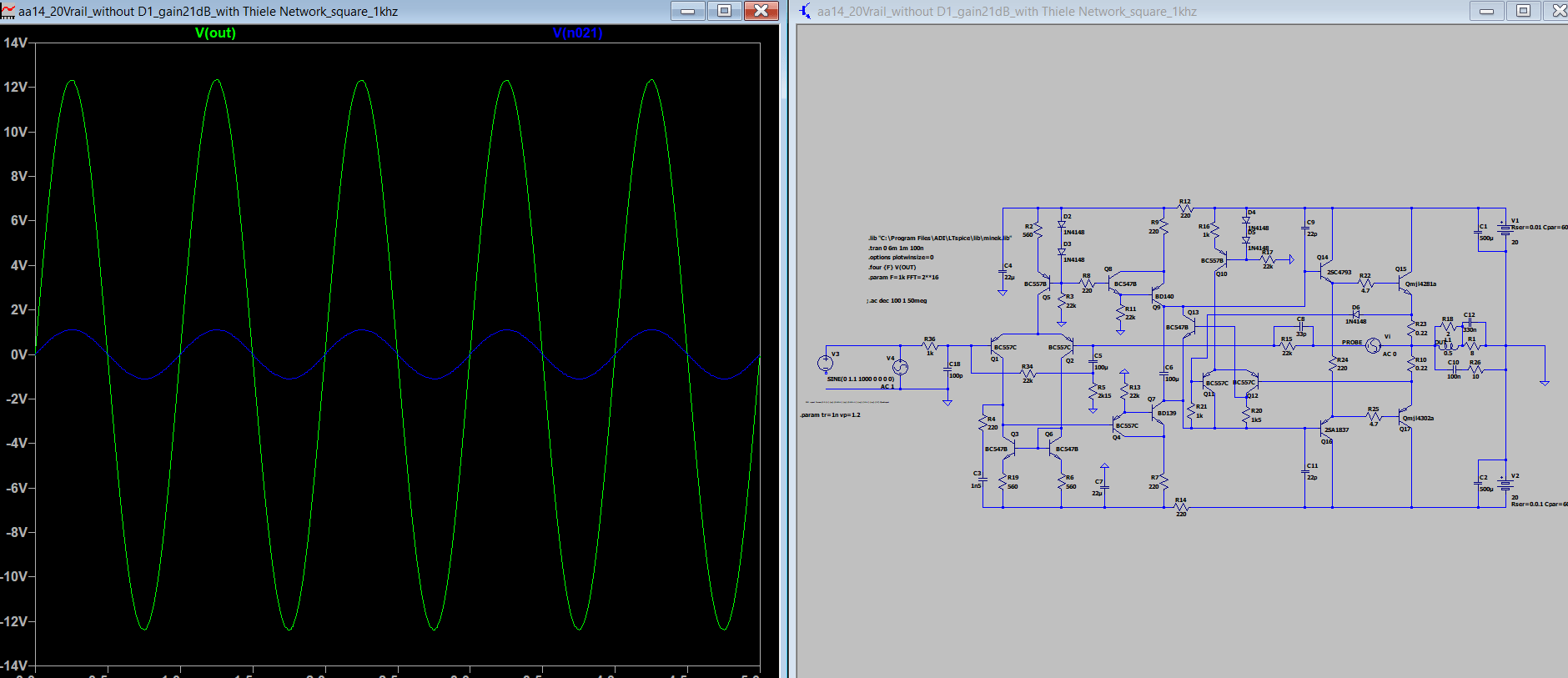

LTSPice file from my APEX AA14 (with great help by minek) is working fine too...

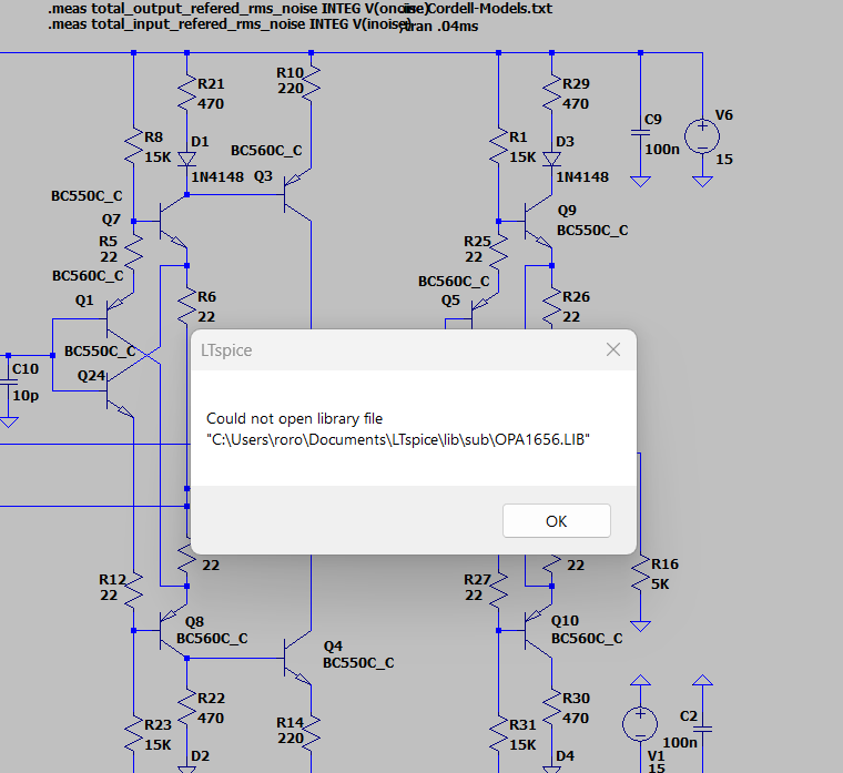

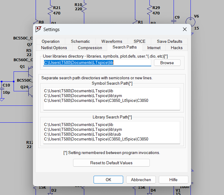

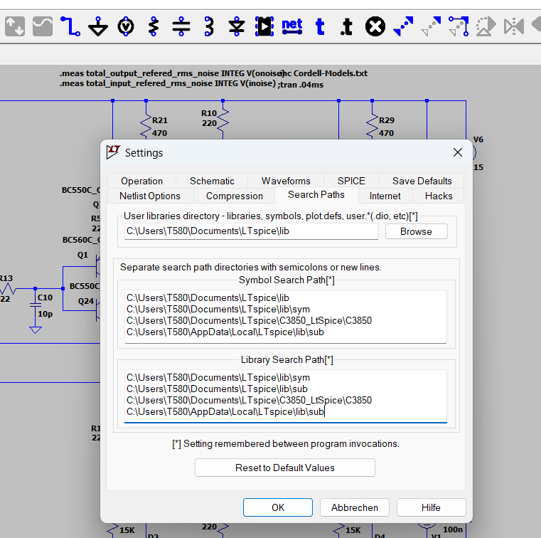

Try putting the OPA1656.lib file into C:\Users\myusername\AppData\Local\LTspice\lib\sub .
no...i think i have a problem with my pc...user rights.
because i did this as you wrote...but the same
This is the log file after doing the resistor mods ala @chalky . Reducing R12, R16, R19 and R21 from 15k to 5.1k and emitter resistors of Q6 and Q12 from 22R to 6.8R (referring to Peter's schematic) . LTspice schematic attached.
OPA1656.lib file must be in C:\Users\roro\Documents\LTSpice\lib\sub . Removed it and got the "Could not open library file" message again. Replaced the file and it works.
