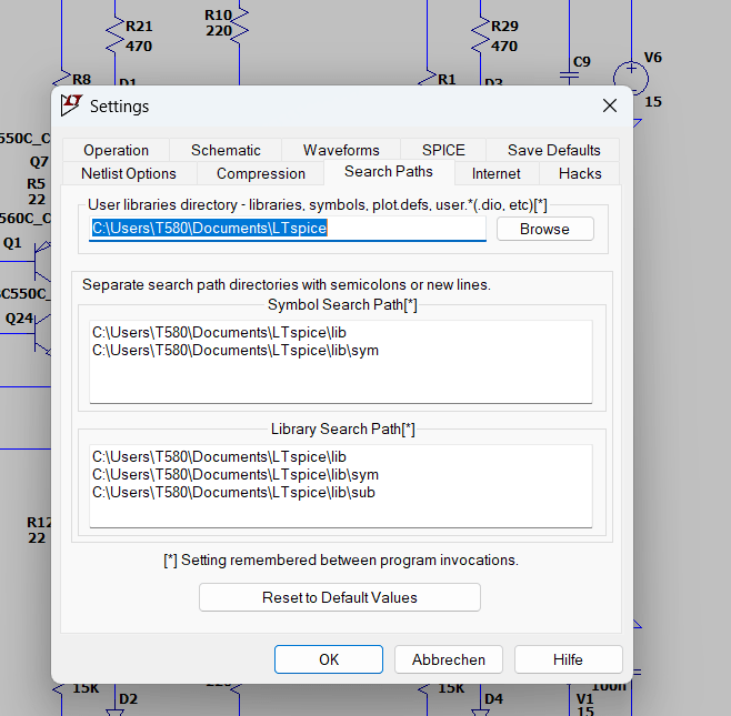

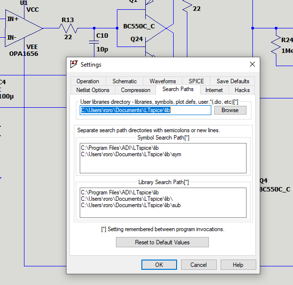

Here is where to put in the search path. Just type in additional lines to tell LTspice where else to look for parts.

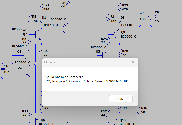

LTspice insisted it couldn't find the OPA1656 in the roro user library. Even after I added my documents folders in the Search Paths. So I made a user roro, with the OPA1656.LIB file in the LTspice\lib\sub and it got past that point. Then it says "Can't find definition of model 'BC550C_C'. Not sure where the standard.bjt file is supposed to go. Also not sure where Cordell-Models.txt should go.
It works properly with the C-3850_Sans_Nonsense.asc file.

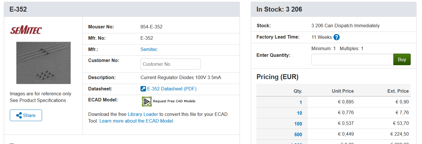

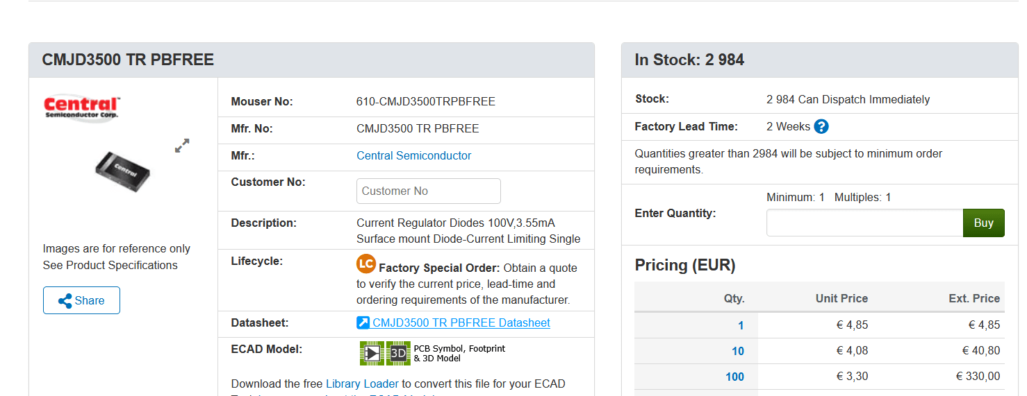

hi chalky
i did a short search at mouser, and i found this - current regulator diode 😉
Cherrman the devices you get from mouser will be genuine Semitec parts; I don't think the ones from AliExpress are as they are slightly smaller than the Semitec parts and the leads look different ( I have both types in my inventory ). Having said that the AliExpress parts work fine in all the projects I've used them in so far, might be different if you ran them up to their max of 100V across the diode. I'm pretty sure that both parts are functionally identical for this application. Take your pick.

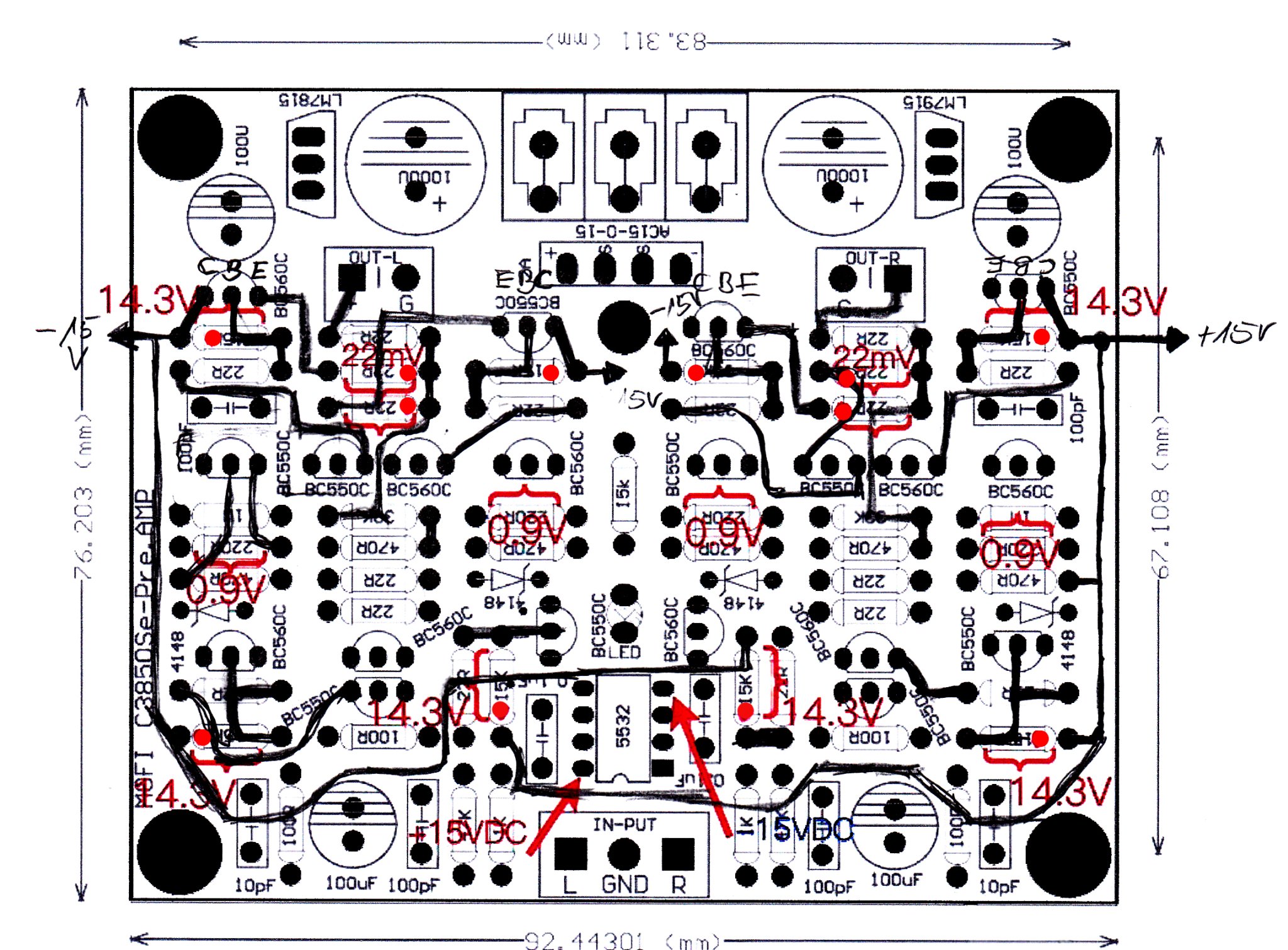

I have measured out the resistors 15 K on the mofi board, easy doing, only 5x 15 k resistors on the pcb. The 22 ohm resistors i have also marked with a red point on my picture. Perhaps it would help.
I will order CDR at Ali Express. Until the CRD 352 i will change the resistors to lower values.
Peter

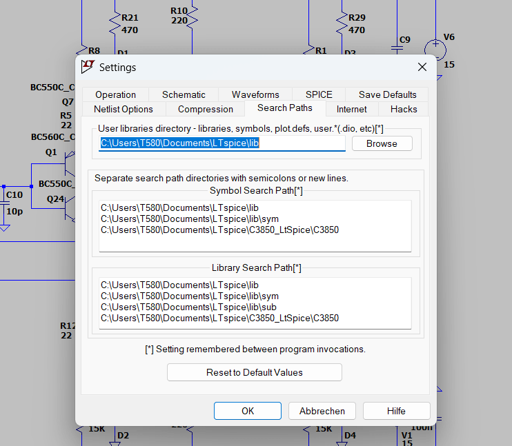

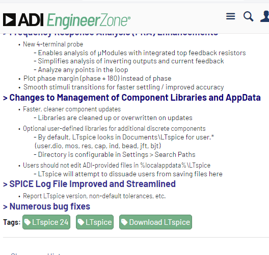

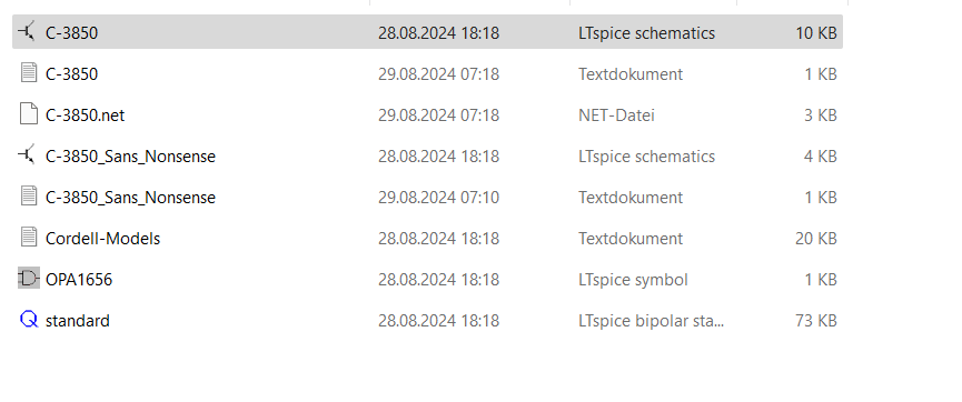

As both the opa1656 .lib and .asy files came in the same folder under \C3850, how about trying adding a line to the search paths pointing at that folder? with the newest greatest LtSpice24, there seems to be restrictions to altering the "factory" library files and folders.
The standard.bjt in the \c3850 folder has the bjt models used in the schematic. It is to be located in the \lib\com
Alternative to standard.bjt, a quick way to make the schematic work is, change the transistors in the schematic from BC550C_C to BC550C, BC560C_C to BC560C. The latter are covered by Cordell_models.txt.
Reactions: chermann
Added C:\Users\myusername\Documents\LTspice\C3850 to search folders. No good. Same error message.
Added standard.bjt to new folder LTspice\lib\com . No good.
Right clicked on BC550C_C "Enter new value for Q9", changed to BC550C. Right clicked on the transistor symbol, and transistor listed as BC550C. Changed all of the other transistors. No good.
Right clicked on the transistor symbol in the schematic and transistor listed as BC550C_C (after reverting to the original C-3850.asc file). In the "Pick new transistor" list, BC550C_C or BC550C are not listed. Also, BC560C_C and BC560C are not in the list.

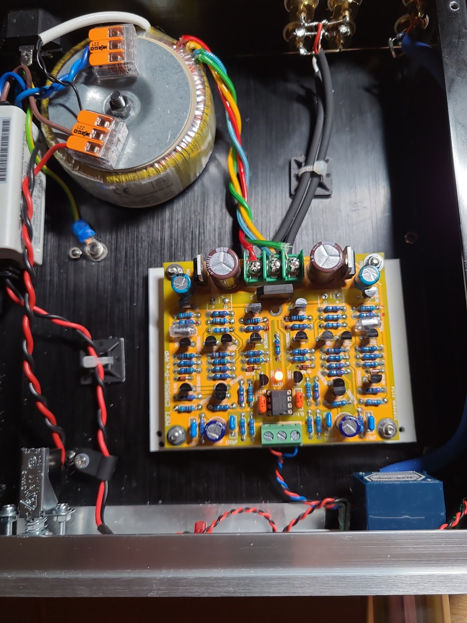

i can say i picked the right 15k/22 ohm resistors...🙂
@chalky
Your Mod is working on the original Mofi board. Sounds very good. Very nice indeed. I have the feeling that in higher frequences it is more open, much more open as without your mod.. love it...👍
Chalky thank you very much for your effort and ideas....
It was also a good idea to change the OPA, but subjective and only my ears. The gain of ~ 5 is always sufficient. I dont understand why the chinese built preamps and amps with a higher gain as necessary.
I have to hear much more (and Moore)

sorry still it is not working🤔
