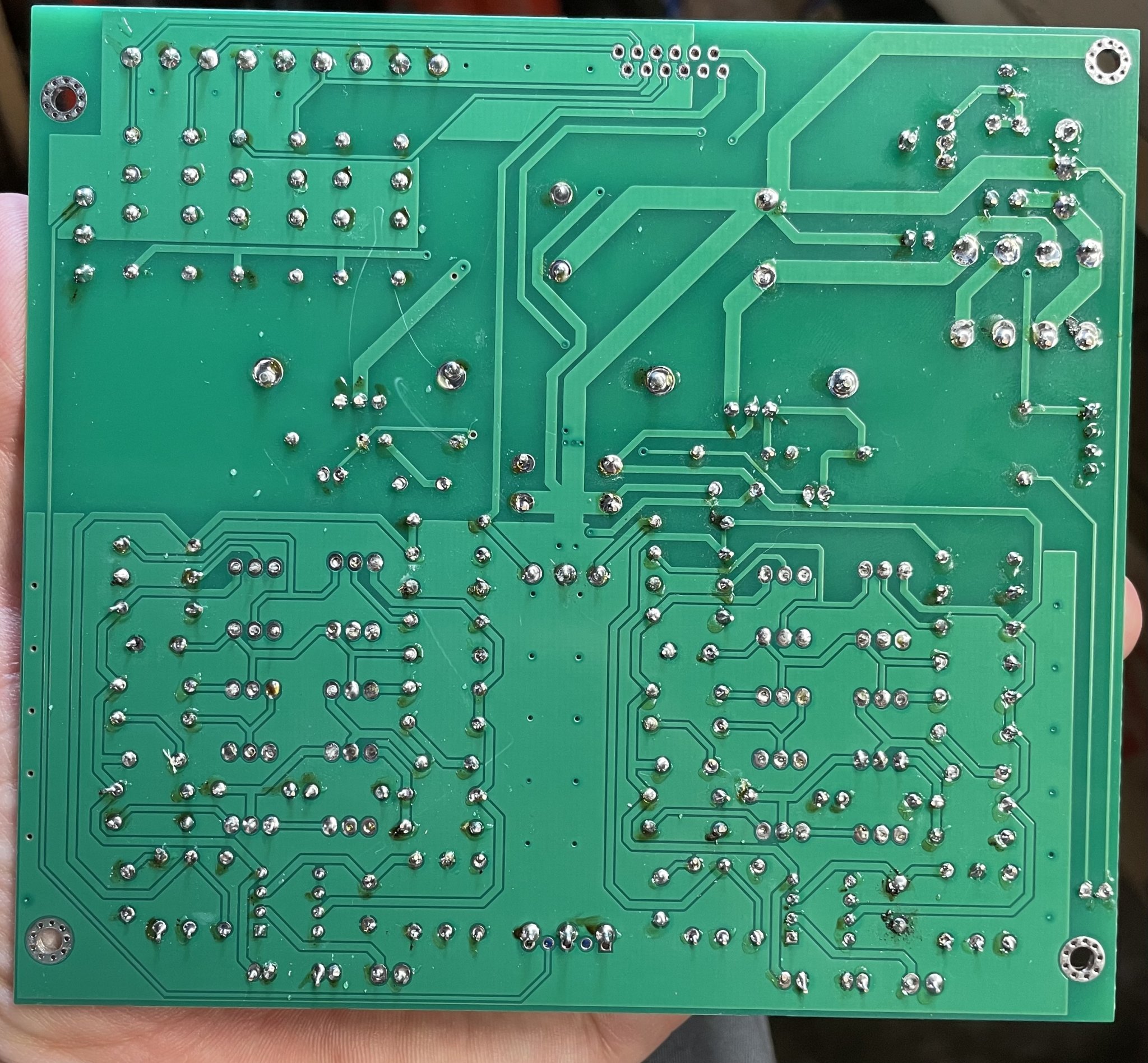

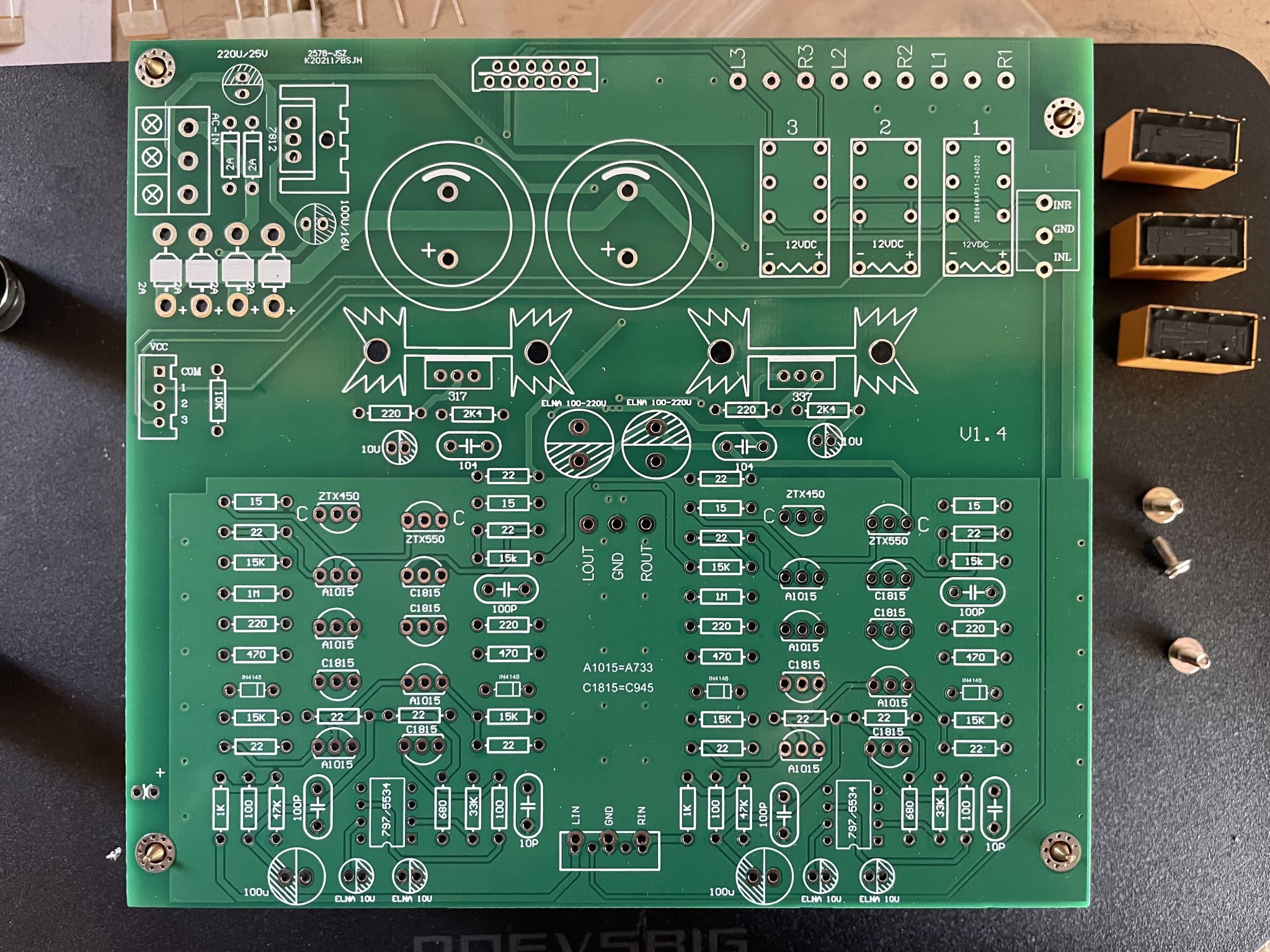

Hey I just wanted to share that my C3850 kit was just a bit different than what I see from the schematic posted in @chalky mod post #177.
I've got a board with the 3 relays, and it is labeled V1.4
Front
Back
So final resistor pair is a bit different,
R24, R25 = 15 (instead of 22)
Also, I've got different transistors. The board is labeled for A1015 / A733 and C1815 / C945, but the final pair changes to ZTX450 and ZTX550. The components delivered with my kit were A733 and C945 (and the ZTX's).
Does this difference seem to be of any substance to the brain trust?
I've got the 6.8 Rs and the CRDs to swap in. Can anyone confirm the orientation for the CRDs in this board?
Thx -
Adam

They have a cathode ring mark, which connects to the negative voltage potential. The opposite lead (anode) connects to the positive voltage.I've got the 6.8 Rs and the CRDs to swap in. Can anyone confirm the orientation for the CRDs in this board?

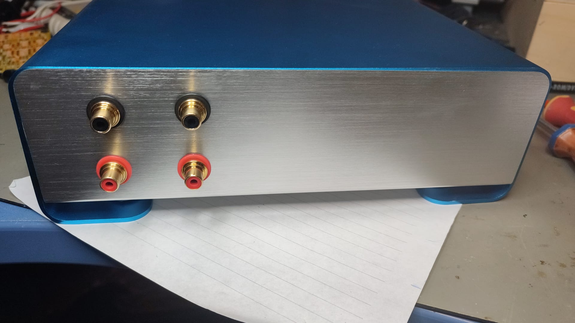

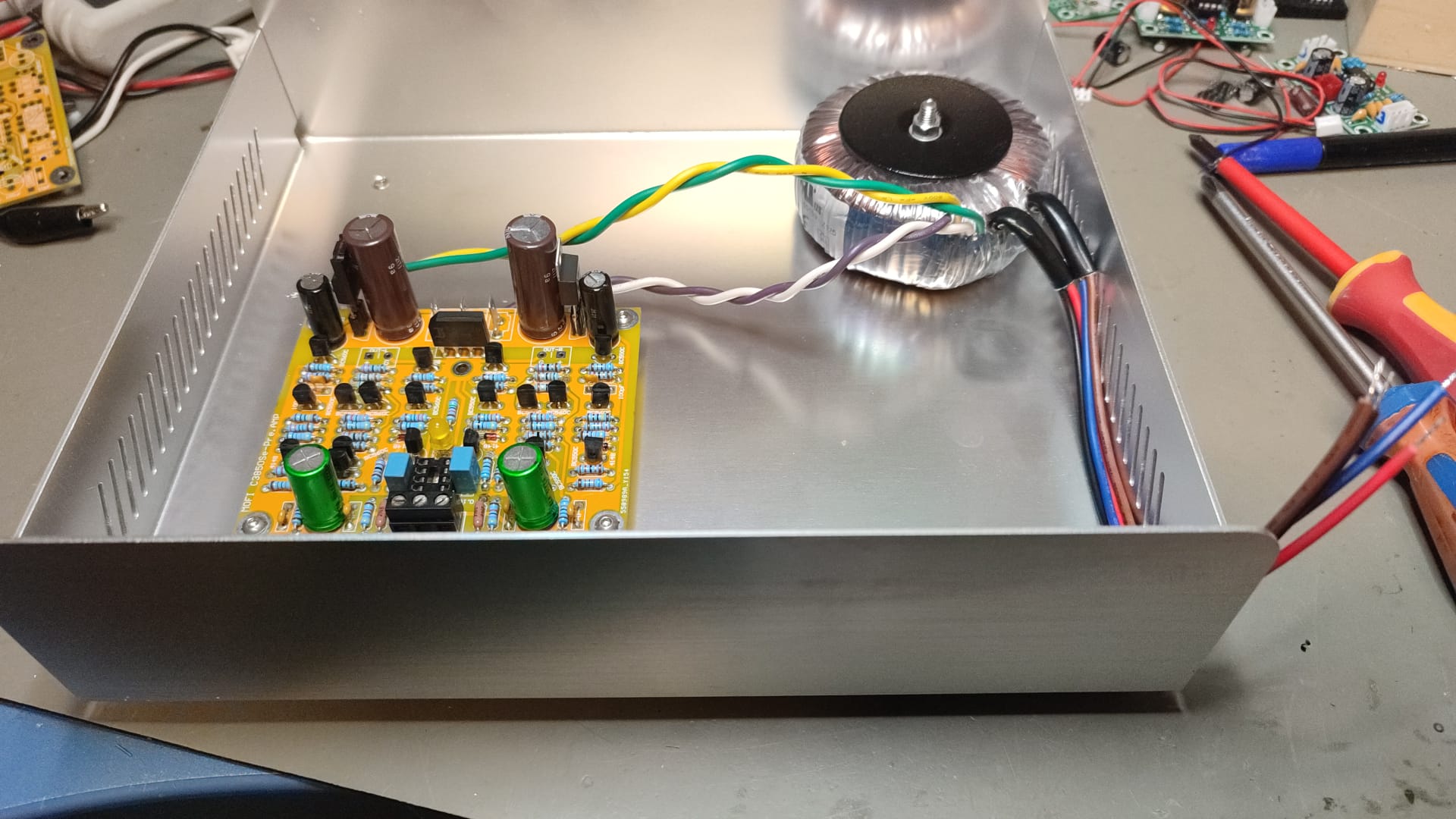

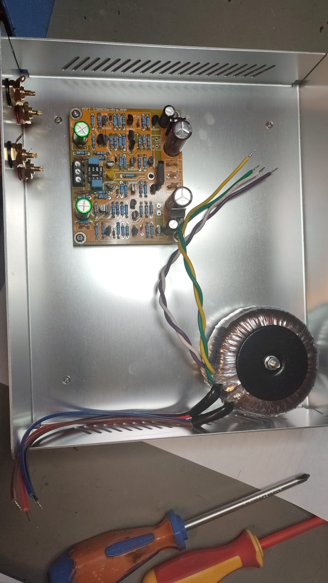

good evening
small progress...
housing and RCA, transformer and pcb setup okay.
i need 230V socket and wires,fuses, cabling, testing
i bought that housing for small Class D amp in 2021. available in blue, gold and black
housing
kr
chris

I subbd in the CRDs (and changed the 15R (22R for others) to 6.8) on my functioning stock board. I ended up with 14 v dc at the input and output, and the LM337 became hot after 10-15 sec. I looked around a bit but couldn't tell why. I pulled the CRDs (afterword they measured at the same current flow as before I inserted them) and moved to the 5.1k resistors and that config seems to function just fine.
Sonically, it might have improved resolution? But the time to take it from one config to the other prevents a tight A/B so it's hard to say for sure. I thought it sounded fairly nice before, and think it sounds fairly nice after.

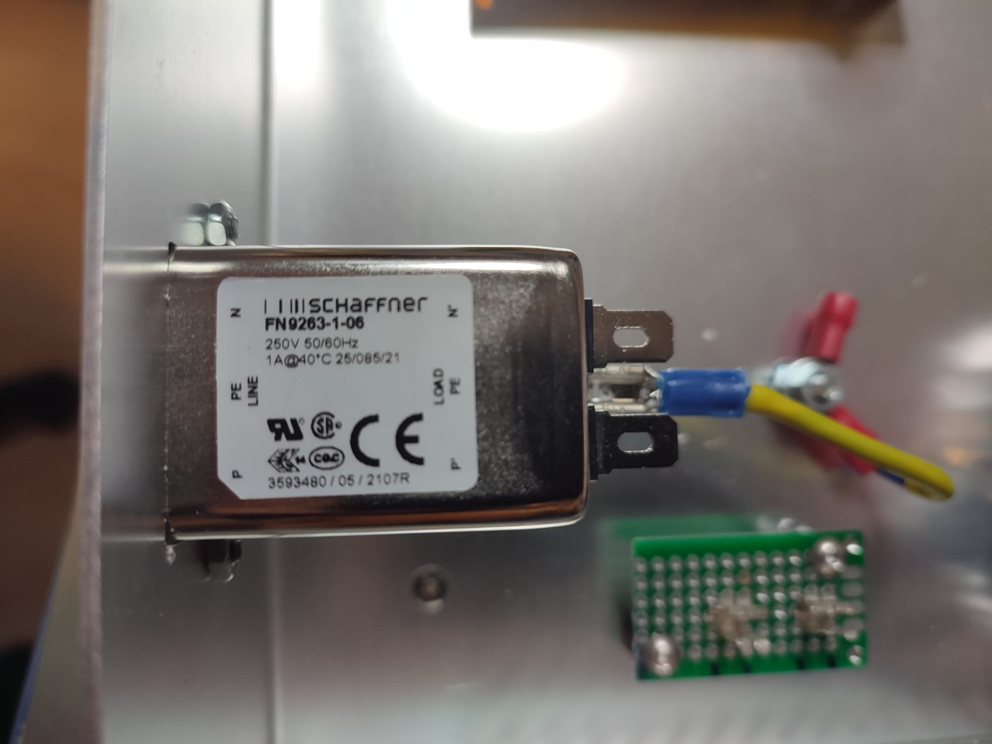

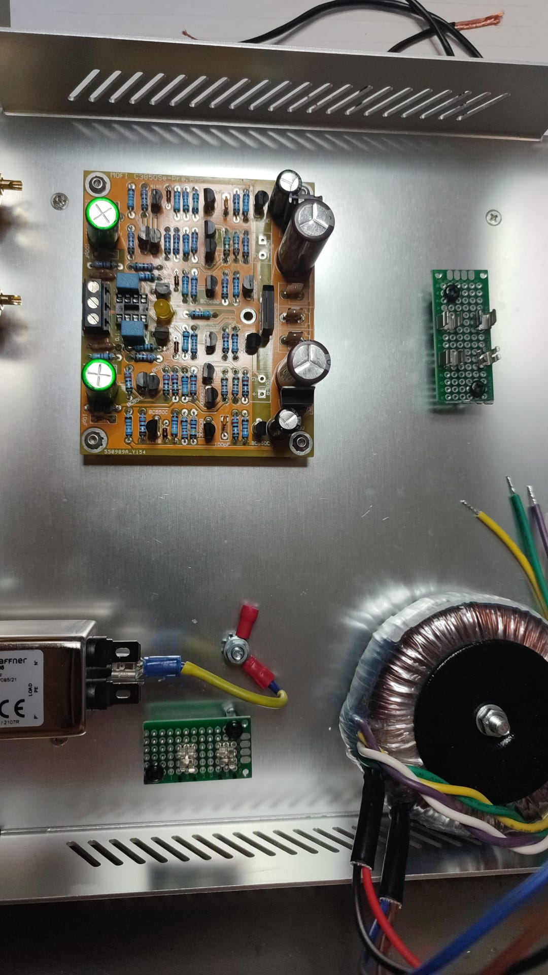

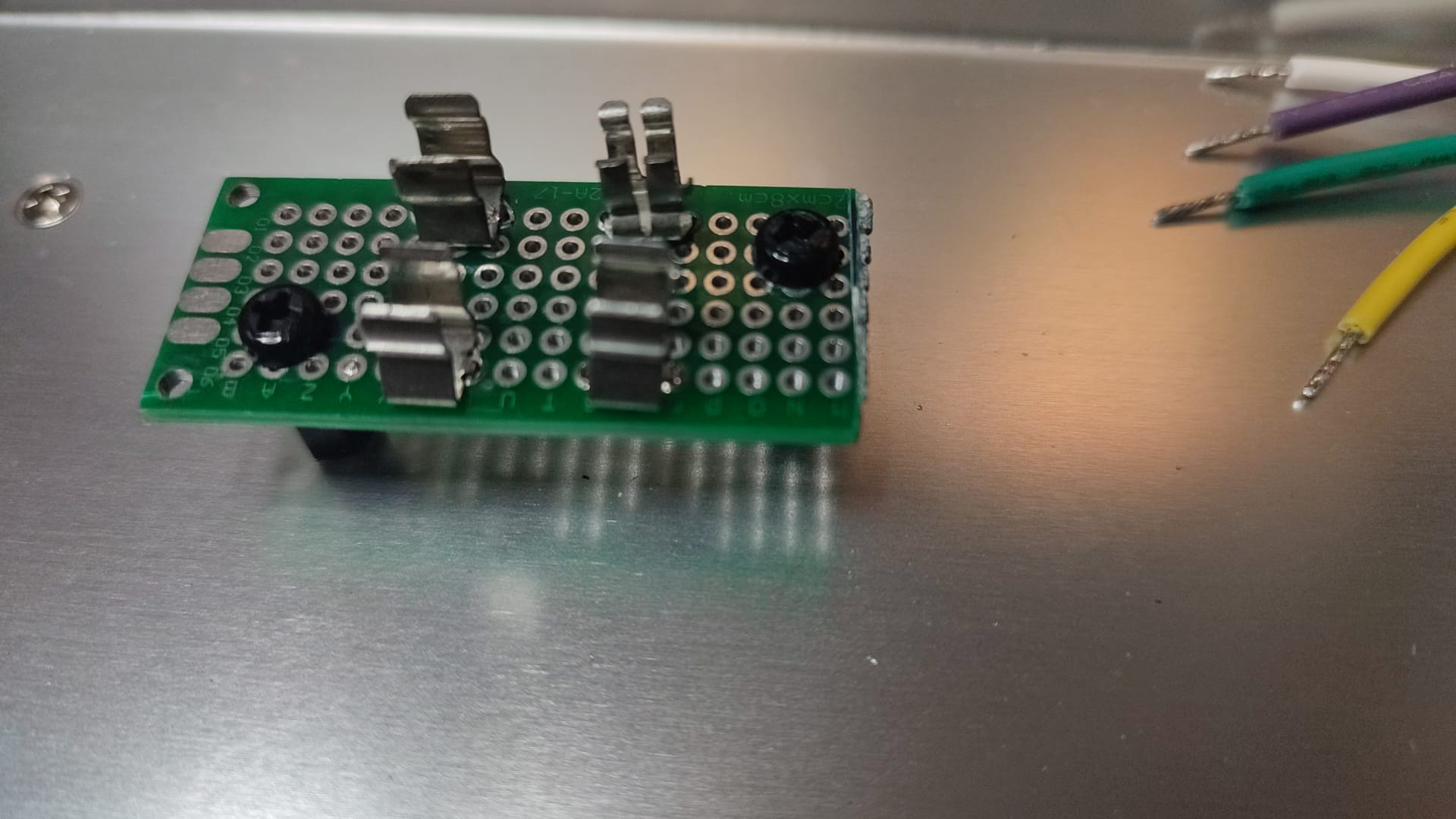

Hi
small step forward,
schaffner filter HF filter (without fuses but switch -digikey) is 1A. so keep in mind that the transformer can have 2A primary (noratel 50VA) but you should use 1A fuses because the schaffner HF filter can handle just 1A.
secondary of the transformer can handle 2x 315mA...so that is not needed for your pre amp ...so i guess 100mA should be enough.
is use a small pcb for hold the fuses 5x20mm) ... keep in mind that you should use for safety reason nylon stand offs and nylon screws. every better solution for fuses in my case is very welcome.
chris
small step forward,
chris
