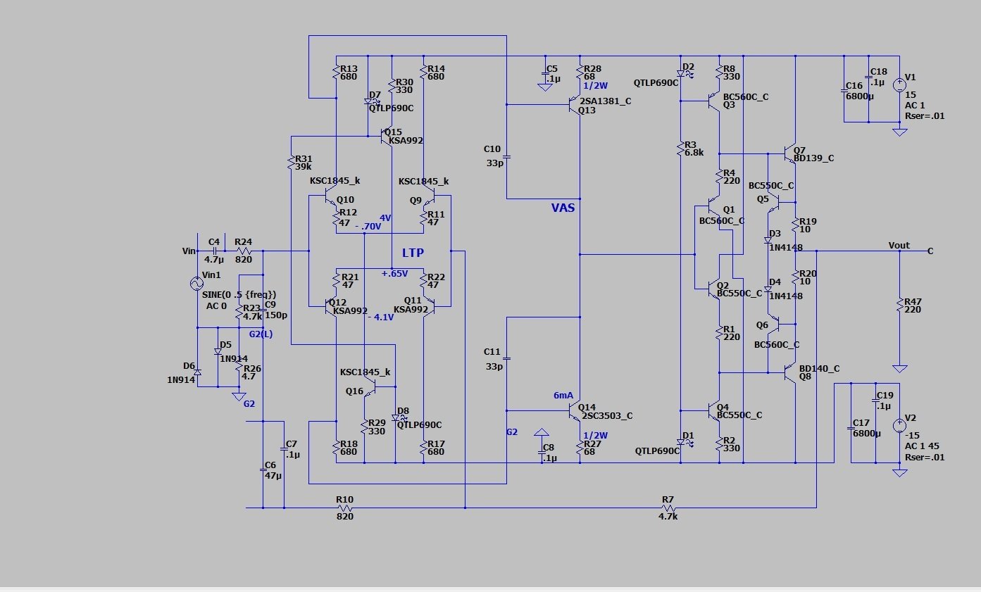

I put the "leach front end" on the OP stage - magic 1PPM BJT headphone amp !
It might need a output zobel / inductor ?? Not sure with headphones ?
As a line stage I just lightly loaded the outputs.

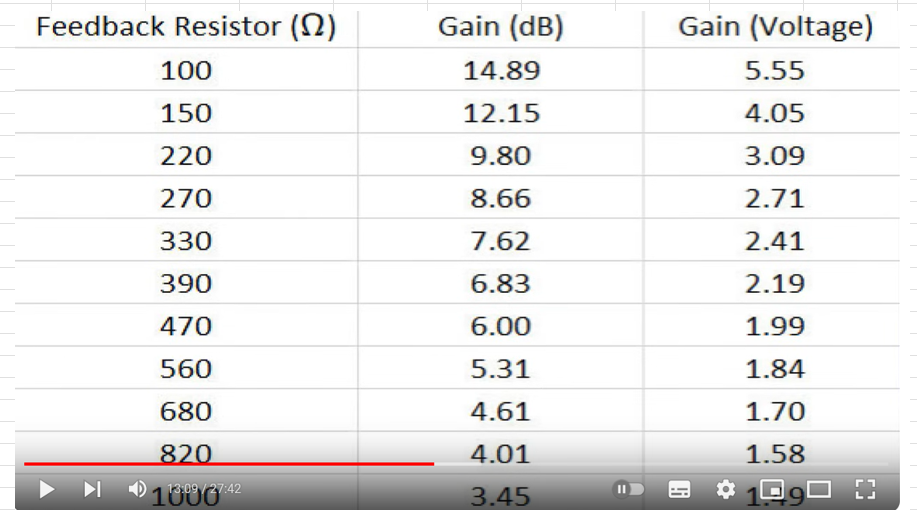

gain is set with 680R --> 4.61dB

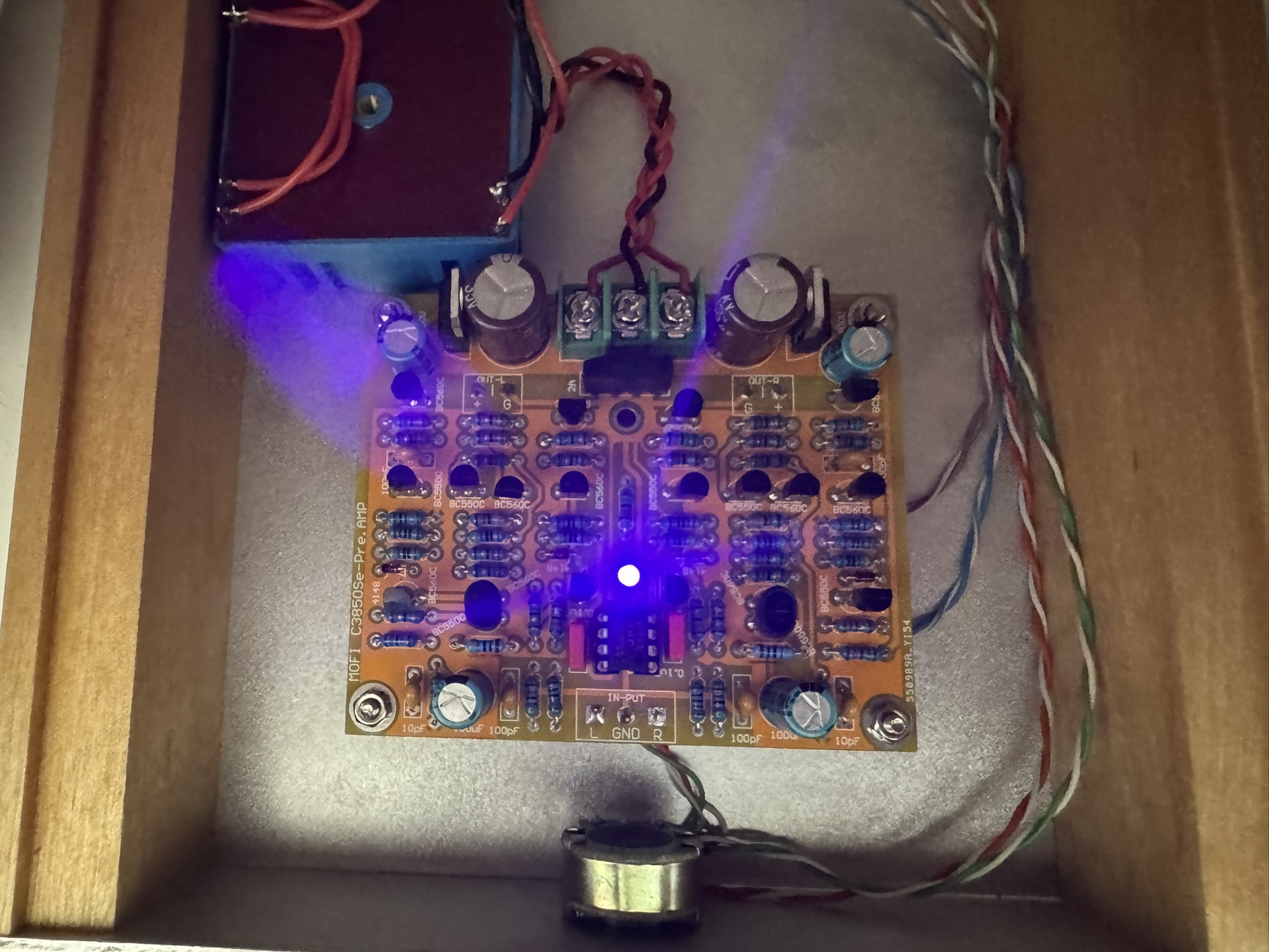

Here's mine! Saw the youtube video a few months ago and ordered two kits! Finally built it up this last weekend.
At first it seemed the general consensus was to increase the resistors connected to pins 1 and 7 to lower the gain, but now it seems like lowering it to 22ohms is recommended?
I used 470 or 560 (can't remember) and socketed them for easy tweaking in the future. I think the pre-amp sounds excellent. Before this I was using the B1 pre amp with the NuTube, and before that some JISBOS. I'm very happy with this Pre, as its noise free (B1 can had tube microphonics) and seems very clear. I used all the kit components except for the 100n caps near the opamp were canged out to WIMA.
Hi...
if you had made no change after taken the picture i think you use a 510 ohm resistor. My idea too to change to a higher value. I am wondering why all other clones are quiet...exept mine...🙁
greets
Peter
greets
Peter

you can set your needed gain as you want. you can change the resistor.
for me a gain of 2-5 is fine for a preamp.
100R is original
kr
chris
100R is original
kr
chris
