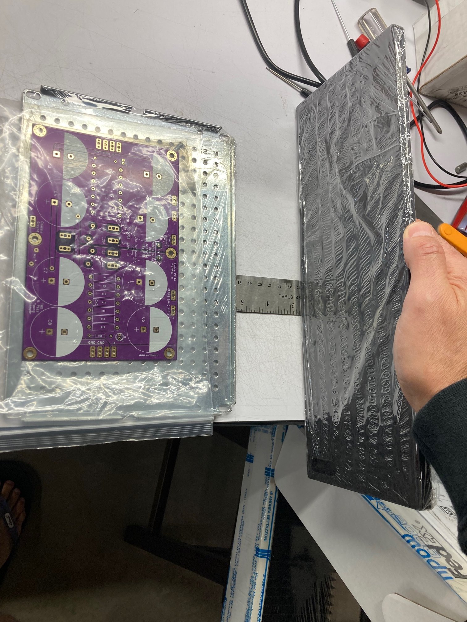

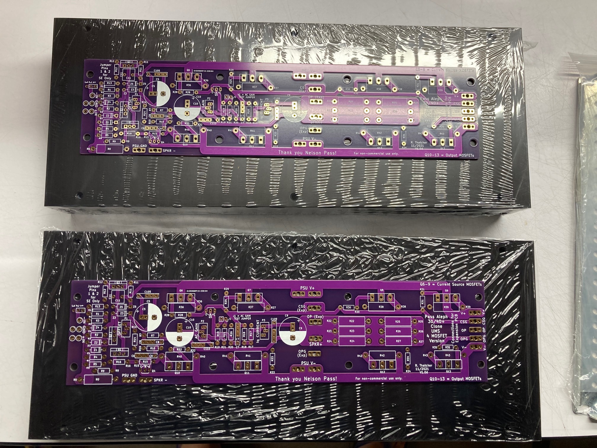

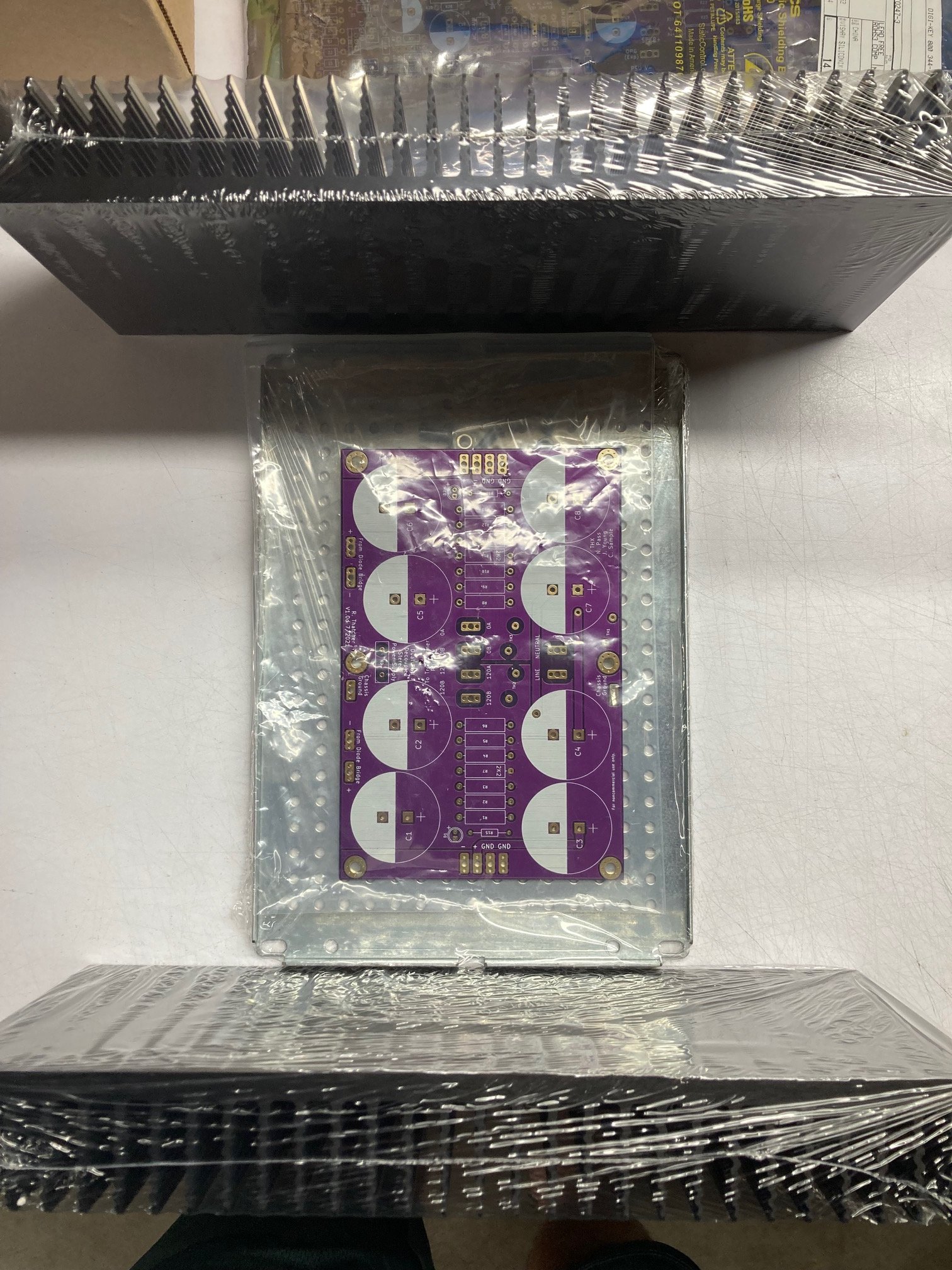

Since I have a 3U x 300mm Mini Dissipante bought during last year's sale, I got curious to see if Randy's UMS amp boards would physically fit on the 300mm heat sinks. They would appear to, even though these heat sinks aren't available from Modushop with UMS drilling. The smaller 33-200/250/300 base plate doesn't have room for much more than the PSU board (244mm wide x 170mm long), but with the 70mm longer plate (240mm), there might be enough room for both the PSU board and a toroid, if the toroid as an estimate were less than 120mm high and less than 60mm thick and likely mounted vertically. Rectifier boards might have to mount on the inside of the face plate, which would need drilling and tapping like the heat sinks do.
What about heat dissipation? The standard 4U/300 heat sinks, which are 300mm long x 40mm thick x 165mm tall, are rated 0.31C/W; these 3U/300 sinks are 300 long x 40 thick x 120 tall and rated 0.40C/W.
24V 2.2A bias/ch = 53W/ch = ~22C above ambient with the 3U sinks, vs. ~16.5C above ambient with the 4U sinks. Well, one thing I've learned from the ACA and the MoFo is the IRFP240s can both make and some heat, and I like smol cases, so maybe.. 😈 :flame:

Don’t neglect that there are 2 rails @ 2.2A. Assuming the +/- 24V rail and 2.2A recommendations are correct (I haven’t looked at the Aleph 30 build doc)…
That’s +/- 24-25V @ 2.2A, or 106W/ch. Not 53W/ch.

Ah. I missed that. That's a lot of heat even for the 4U sinks, 33C above ambient?
Also the Antek toroid AS-3218 is 5" wide, which won't fit vertically in a 3U chassis.
