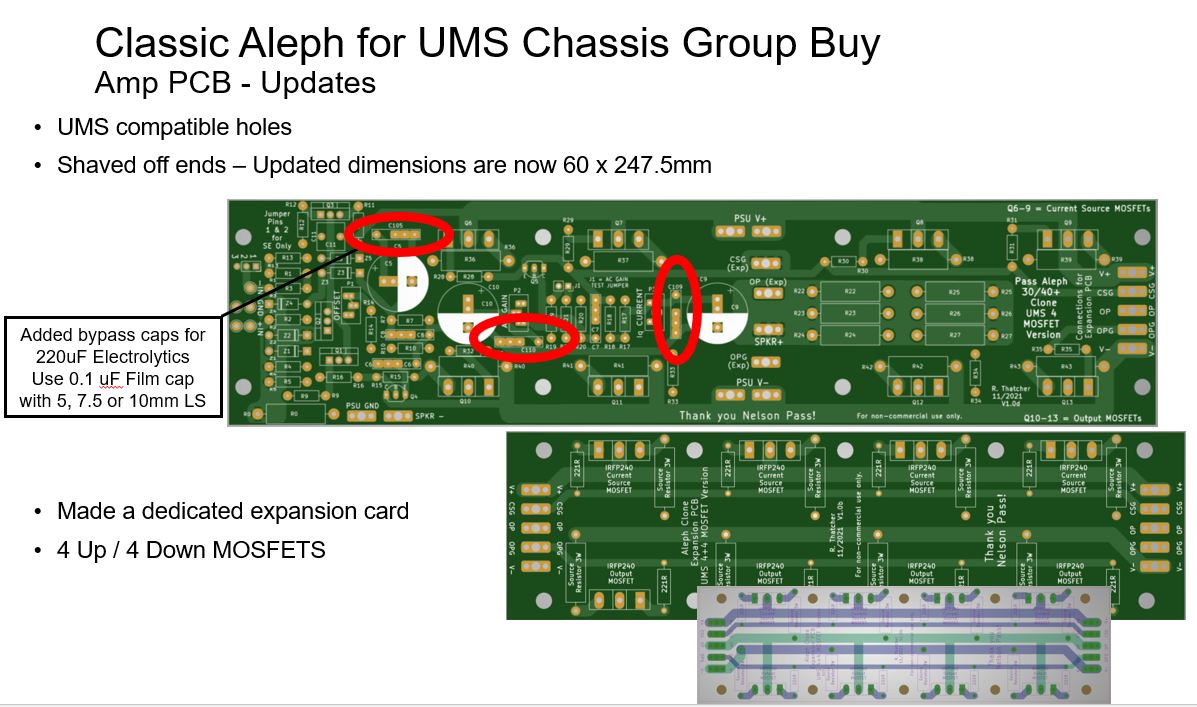

I made a few tweaks...
- Added 0.1uF bypass cap footprints for the 220uF electrolytic caps. These are purely optional. I saw a post earlier in this thread pointing to a ZM post about this topic. Now the option is there to add bypass caps with 5, 7.5, or 10mm lead spacing. I'll put an option or 2 in the BOM (Kemet, Wima, etc.)
I was thinking about chassis options, and using 250mm width PCBs leaves no room for space on a 500mm deep chassis. I shaved a little off the end of the boards. It is now 60 x 247.5mm. Still tight...
So I made a 4 Up / 4 Down dedicated expansion card. This will make for an easier fit on the 2nd heatsink if 2 PCB's are side by side. Now use the main PCB + Expansion PCB. The expansion points are in the same order, just daisy chain and go.
I'll update the group buy spreadsheet for any A2 or A60 builders who want to switch from 2 pairs of main boards to 1 pair main + 1 pair expansion.

Randy,
This is great work.
What would be the recommended PS for building the Alpha 60 Stereo in the 500mm chassis? I would still think that the "New Original” F5 Dual Rail Decoupled PS would still be recommended for stereo.
500mm - I assume you're doing 2 channels in one chassis. For that application go for the "New Original” F5 Dual Rail.

Randy,
I am trying to produce a BOM for 30 version and can't seem to find anything for C8 and C11 from Mouser. C8 is shaped to accept a 2.2uF film about 10mm square and that is what it appears to show in your picture. C11 appears to be a 10pf silver mica but nothing of that value and form factor seems to be available. Any part numbers or vendors would be appreciated.
Roy
Roy,
I have a 10+ page build notes guide drafted including BOM for the A30. When I’m done with that I’m going to make a version for A60. PM your email address and I’ll send it to you. I could use an extra set of eyes for review and input. I’ll publish the doc once it’s a little further along.
