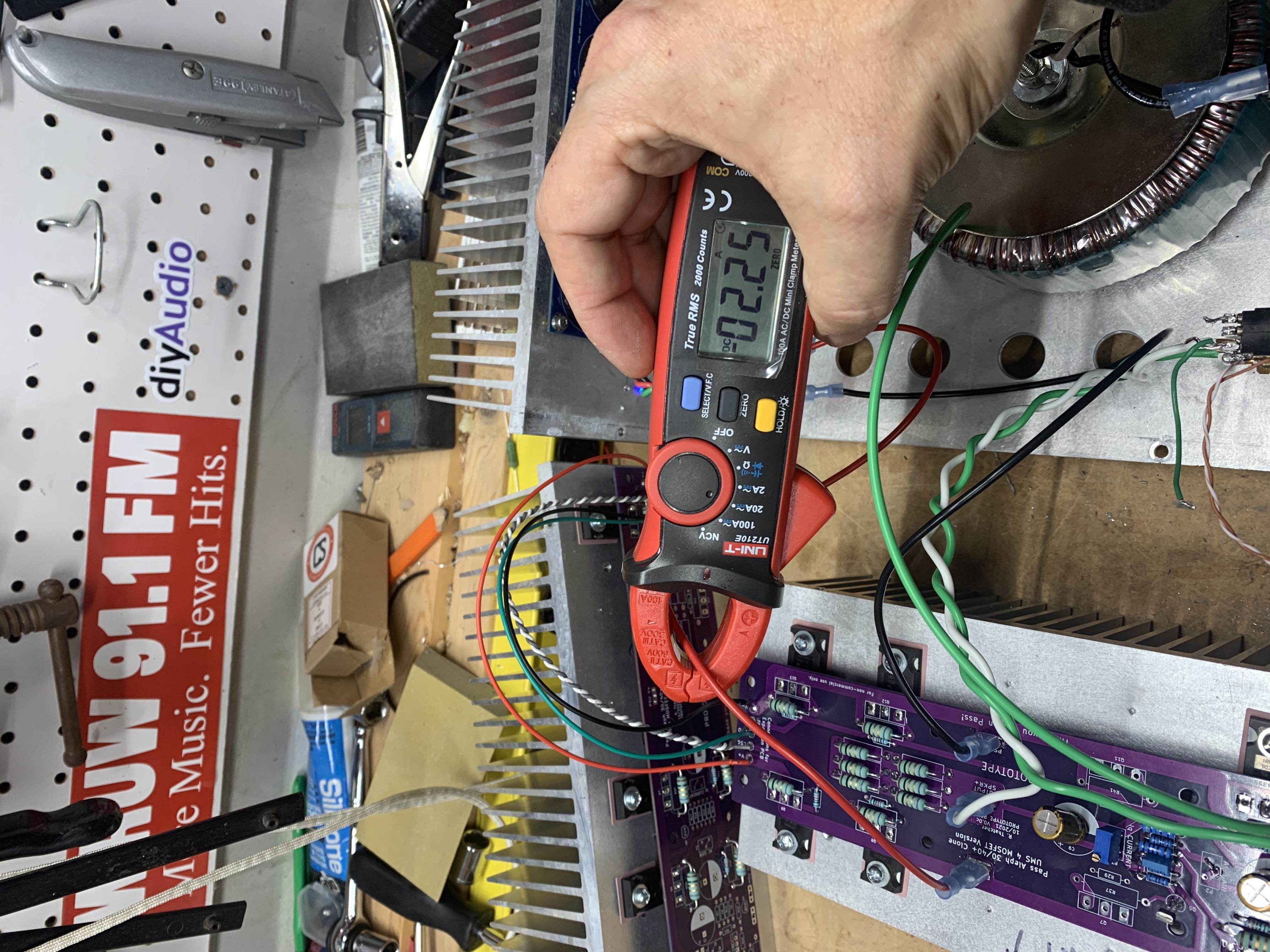

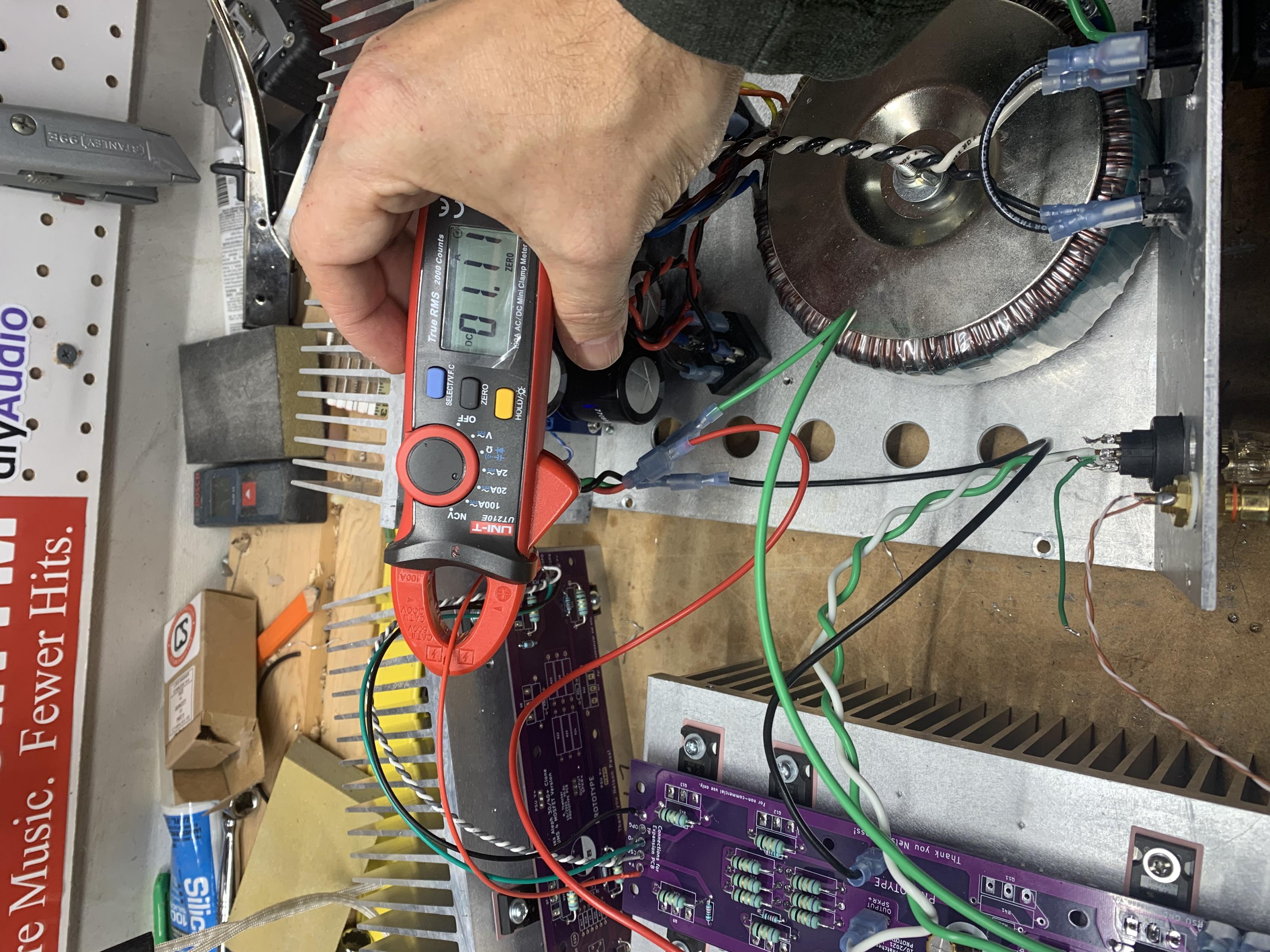

I made a test bed Aleph 60 mono using a Rawson aleph 5 chassis to prove out the expansion from main board to a 2nd board without the front end bits populated. This was all parts bin goodies and some mosfets harvested from the aleph 5’s. Price was right!
34v rails. 2.2A per rail from psu, 1.1A on 2nd board. Load is spread evenly. I had fun and turned the current up a bit, and that worked as expected. Ac gain and offset pots were jumpered out and the spec a60 resistor values were used in the respective positions.
The amp works and sounds great on test speakers! I’ll call this experiment a success, and it unlocks the possibility to do higher power amps with these boards. Thanks again to Jim 6L6 for the idea of using the same board for expansion (as opposed to a dedicated daughter board.)

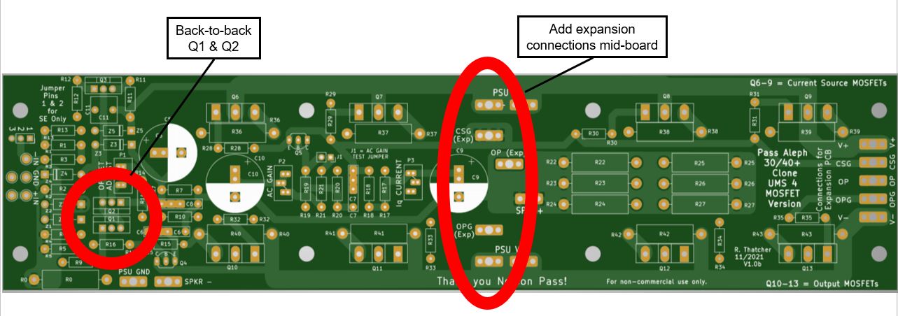

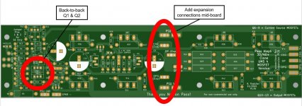

Would it be possible/useful to place Q1 and Q2 back to back to thermally coupling them?
By request. 2 changes.
- Classic Aleph Amplifier for Modern UMS Chassis
