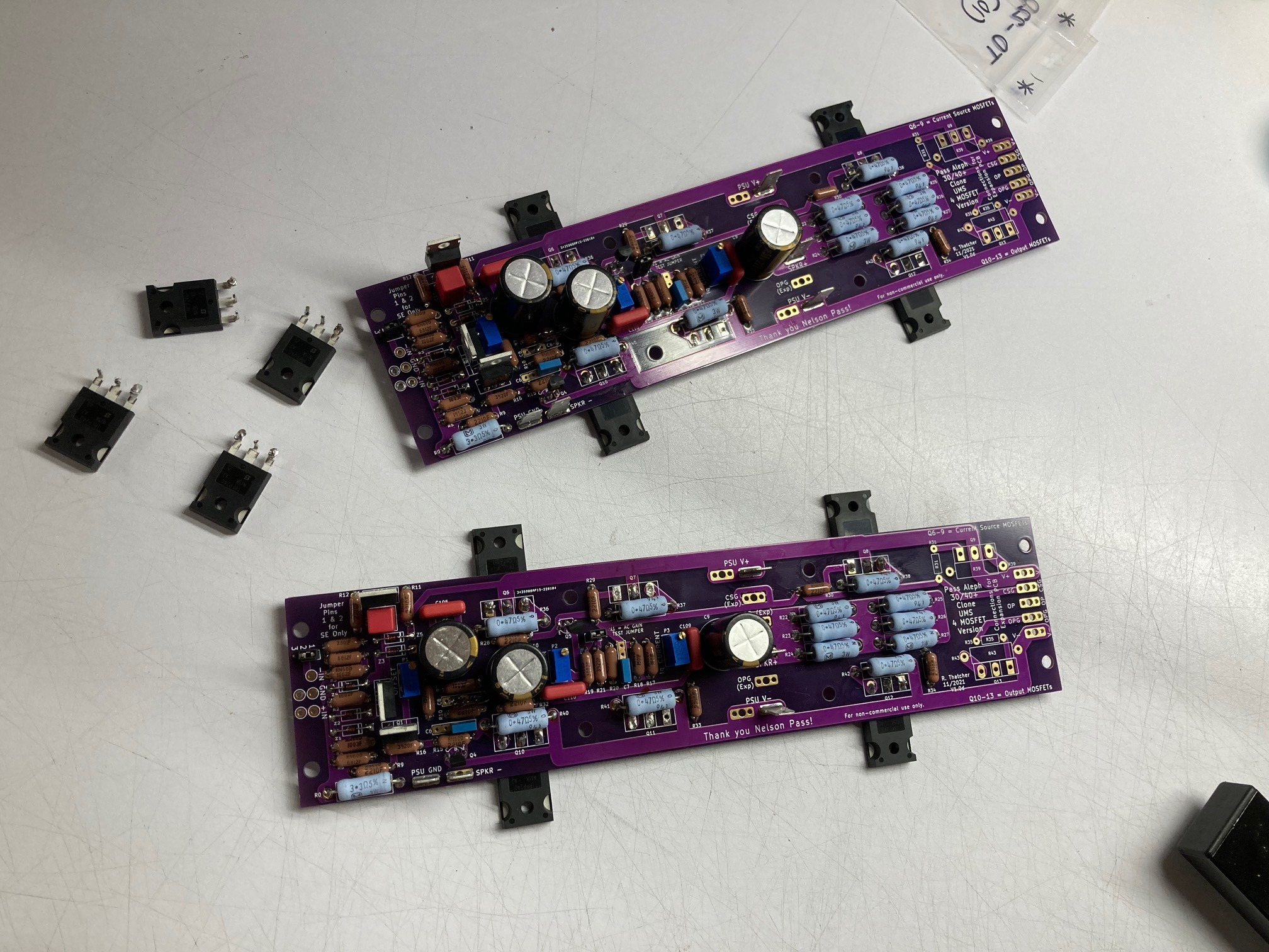

Pm sent. I can make a mini build doc and BOM for these boards.

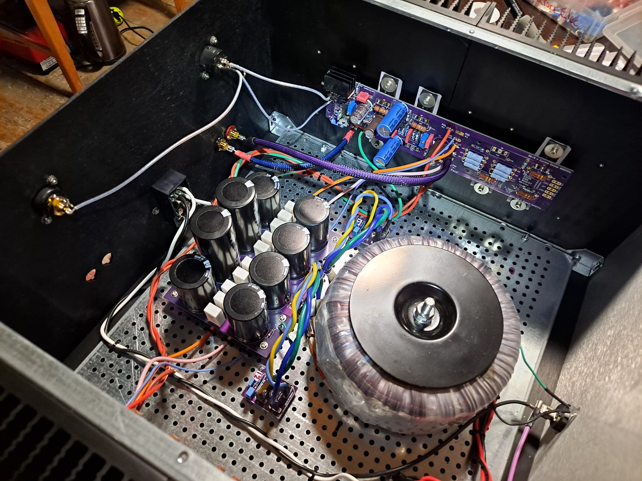

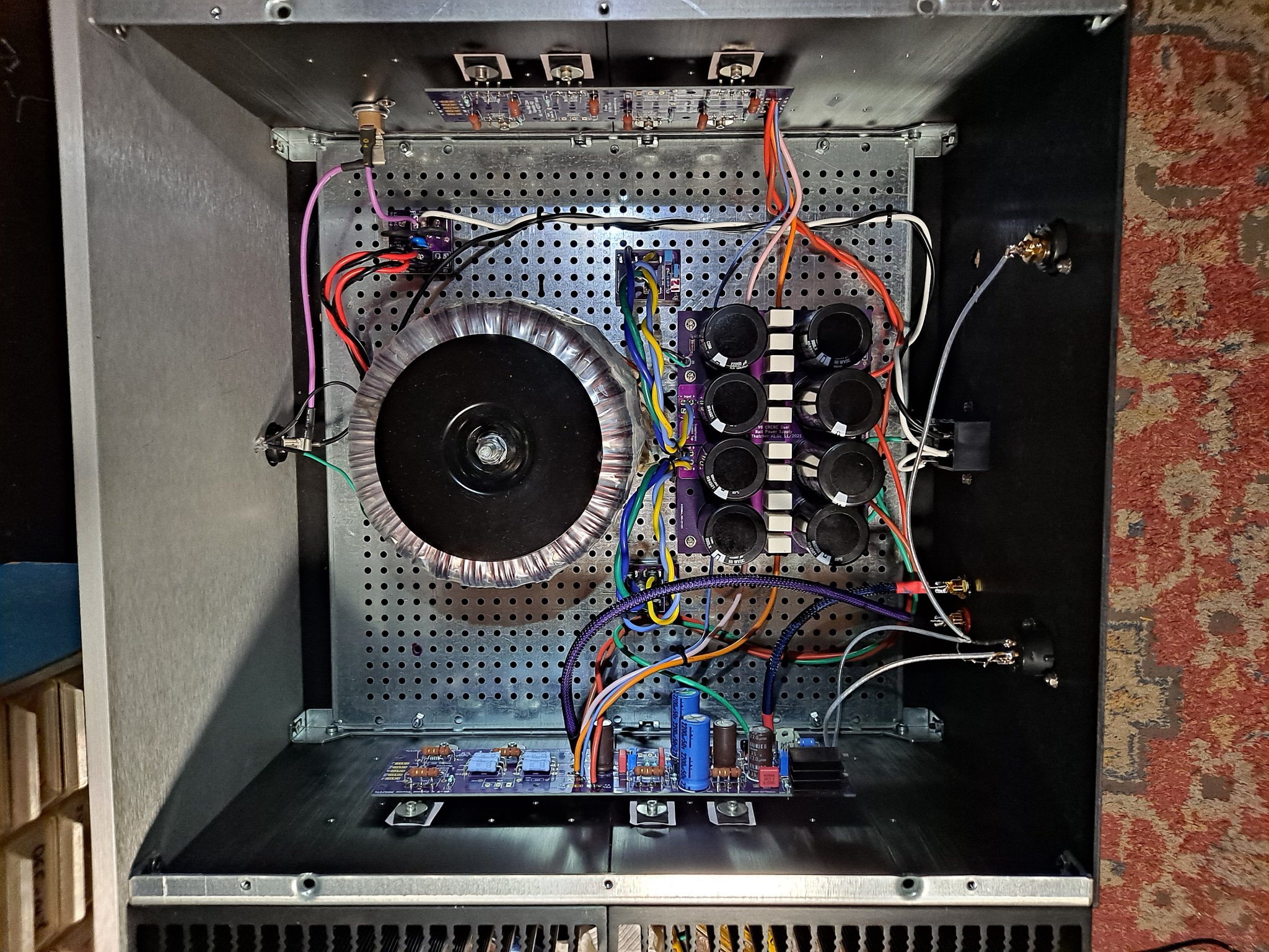

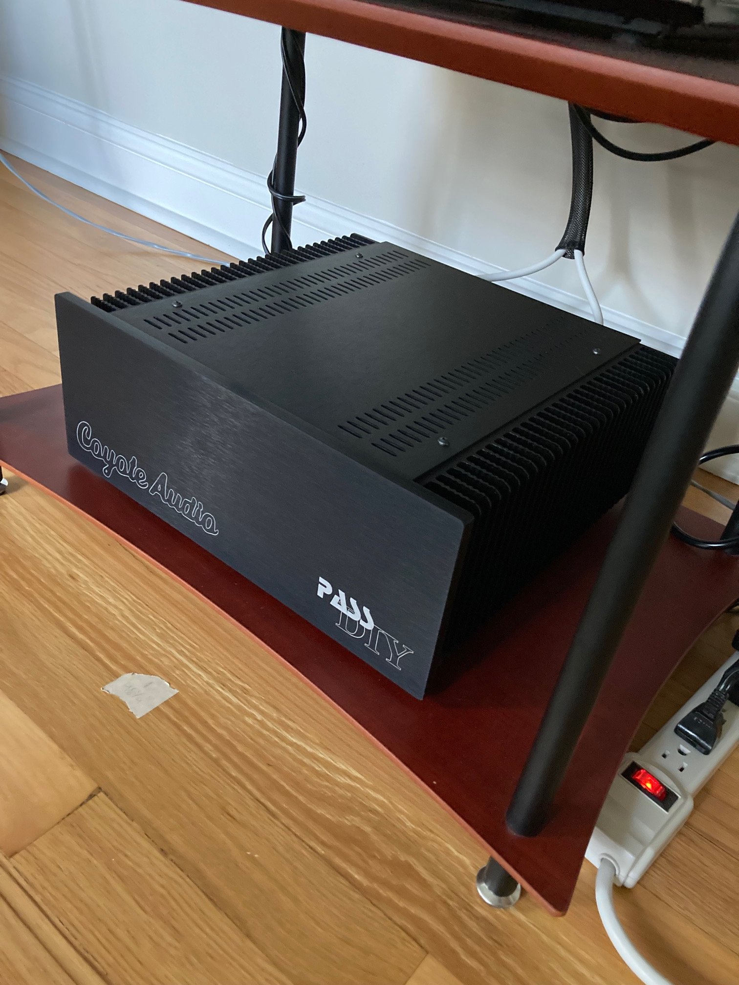

Idk where I posted it now, but I ended up turning my Aleph 30 into an Aleph "20" by pulling one pair of output transistors per board, leaving two pairs per channel, and mounting the thing in a 3U 300 Dissipante chassis which previously held an F3. An Antek AN-3218 donut just barely fits. I didn't need to make any changes to the DC offset or bias, L-R channels were at 30mV and 14mV, respectively and 1.5A bias, +/- 21.8V rails loaded. I must have done a better job with grounding this time as there's almost zero hum/buzz, compared to when the Aleph 30 was in a 4U Deluxe.
The sinks of this Aleph 20 get no hotter than an ACA's. 3-5 second touch no problems.

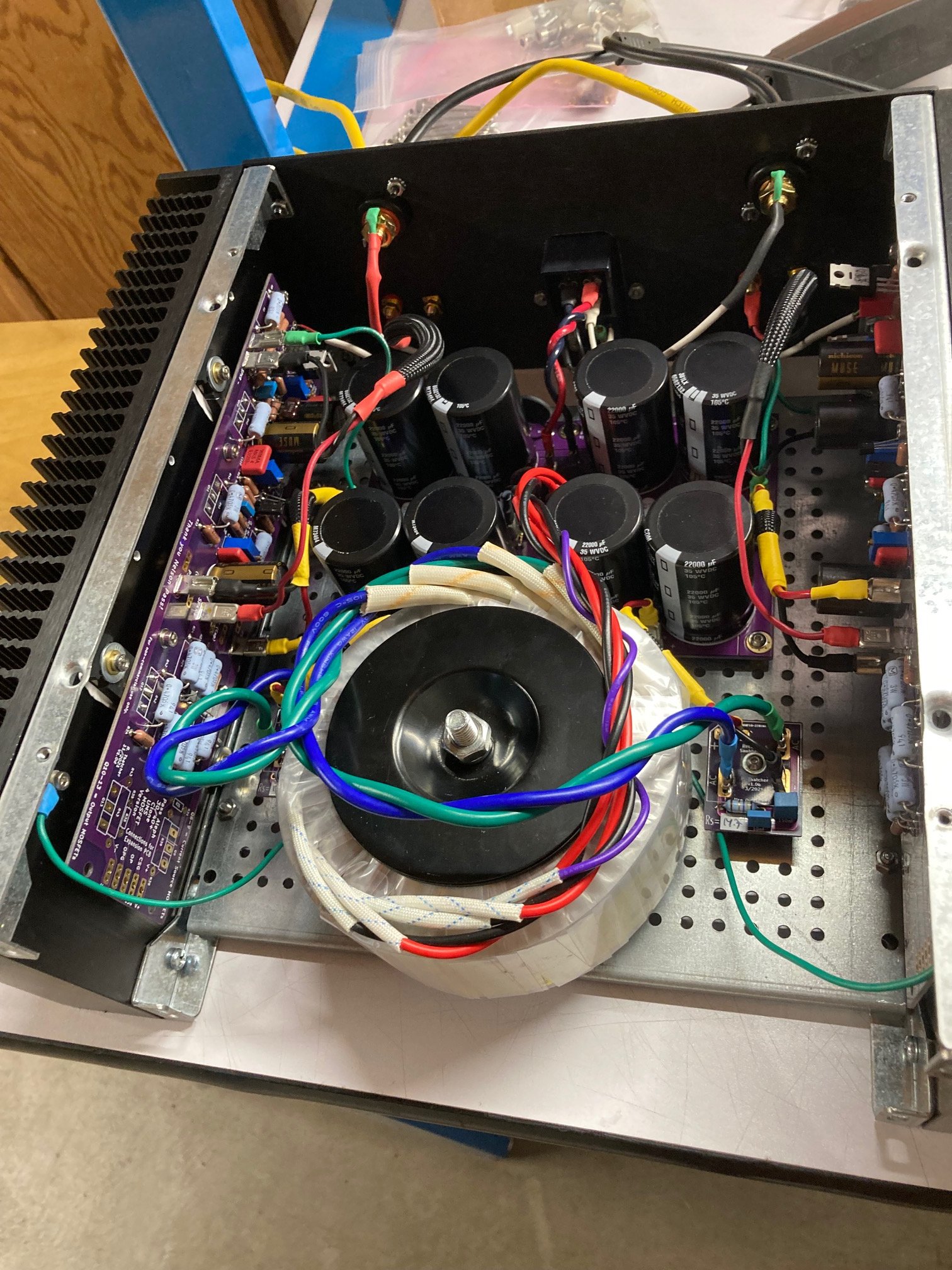

The one I built had point-to-point wiring for the PS supply, cheap resistors on that circuit, wooden bottom to the chassis, no real provisions for transformer snubbing etc. Against all odds, it was quiet. I also built it with IRFP150's which is the equivalant of two IRFP240's. That probably brought the distortion down a bit
The new UMS boards look so much better and much more practical. I built mine as cheap as possible to be a garage amp thinking it was am old design etc. Now I am planning another one for my main system! I was surprised to say the least. I shut my other amps off for a while and just let this little thing cook the house.
You know what would be neat is if HIfi 2000 made a mini UMS case where mini amps could be made. Something the size of the Vfet case. I think this amp was only 10-15 watts or so and it was great.

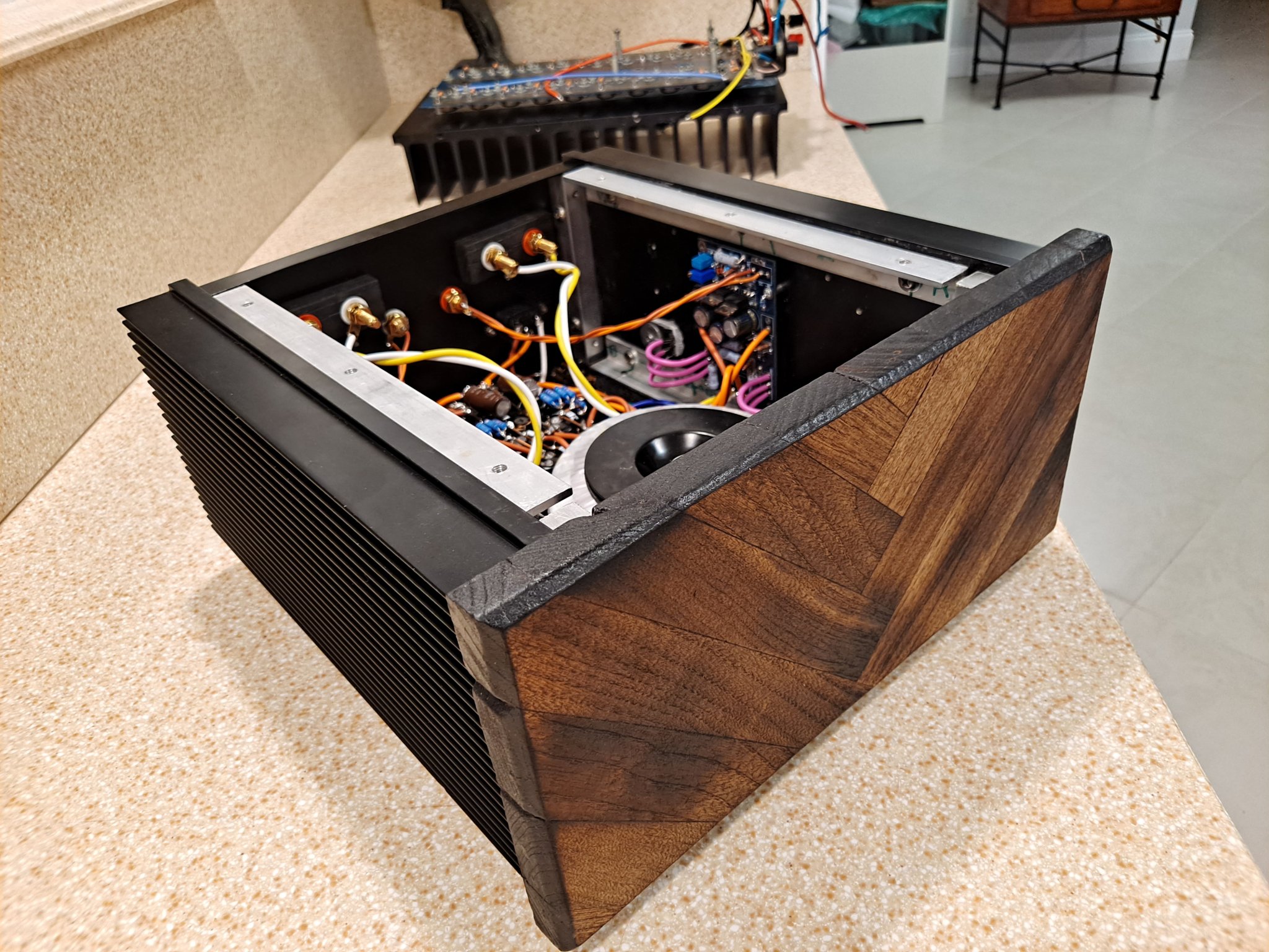

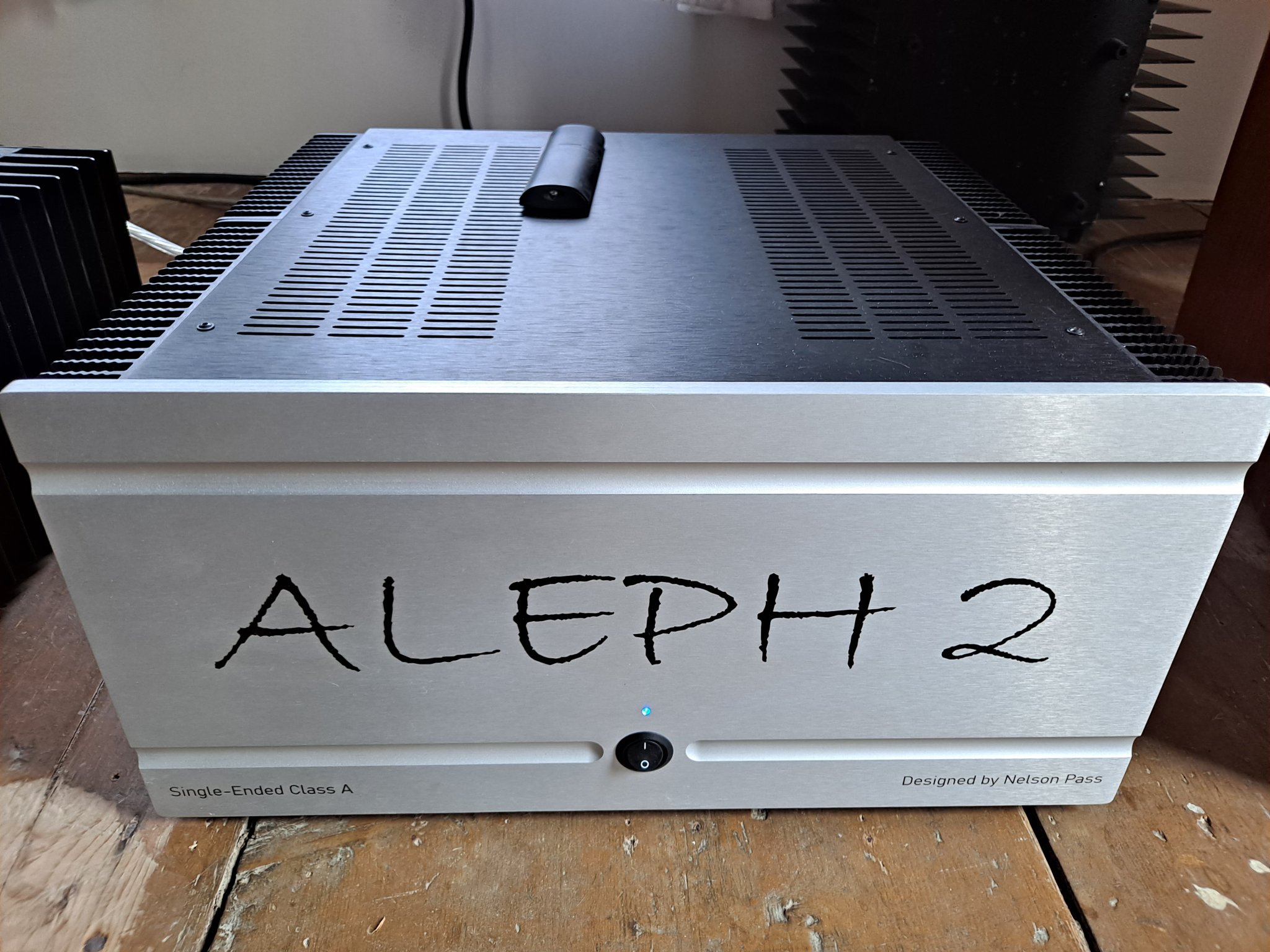

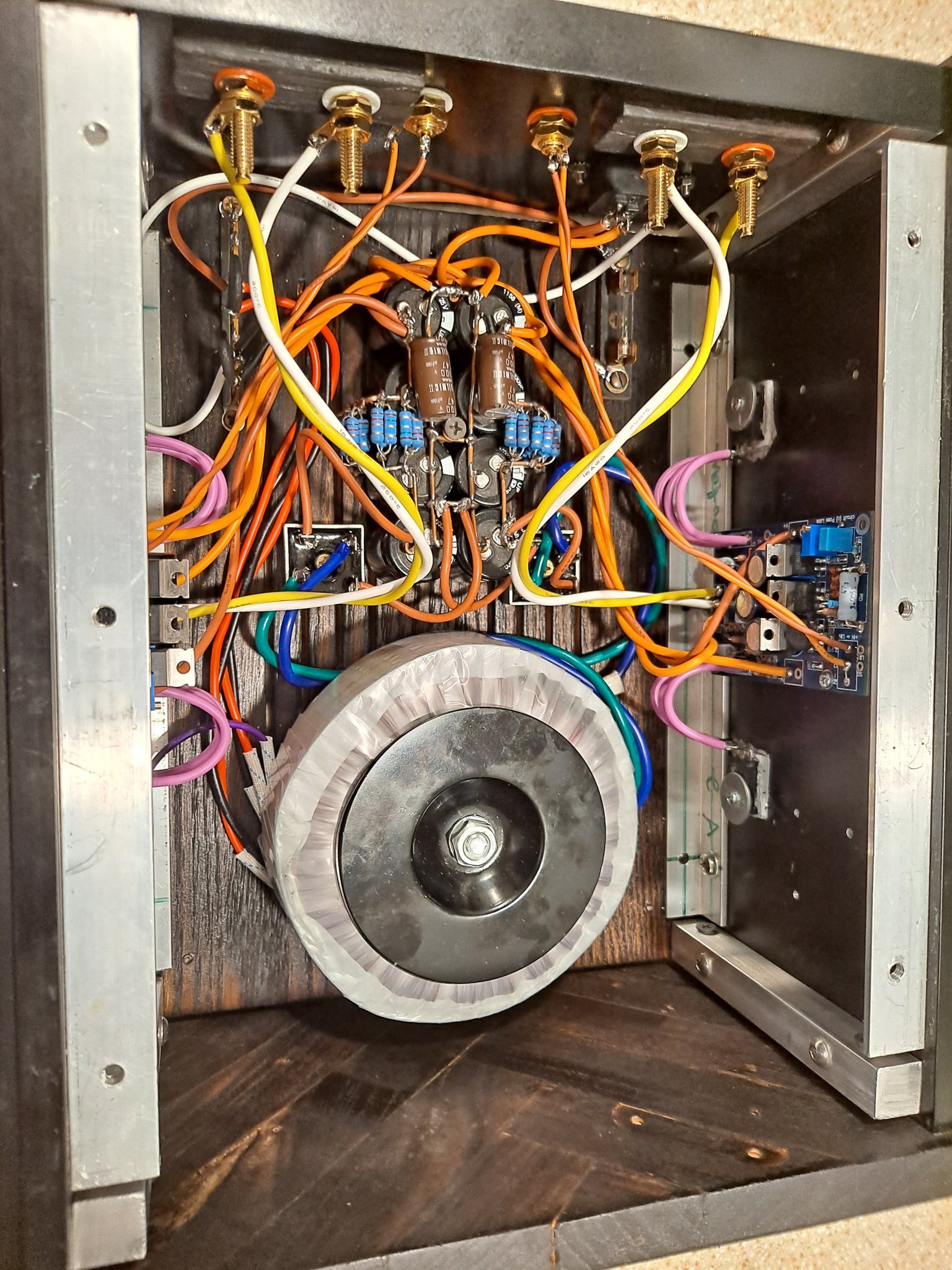

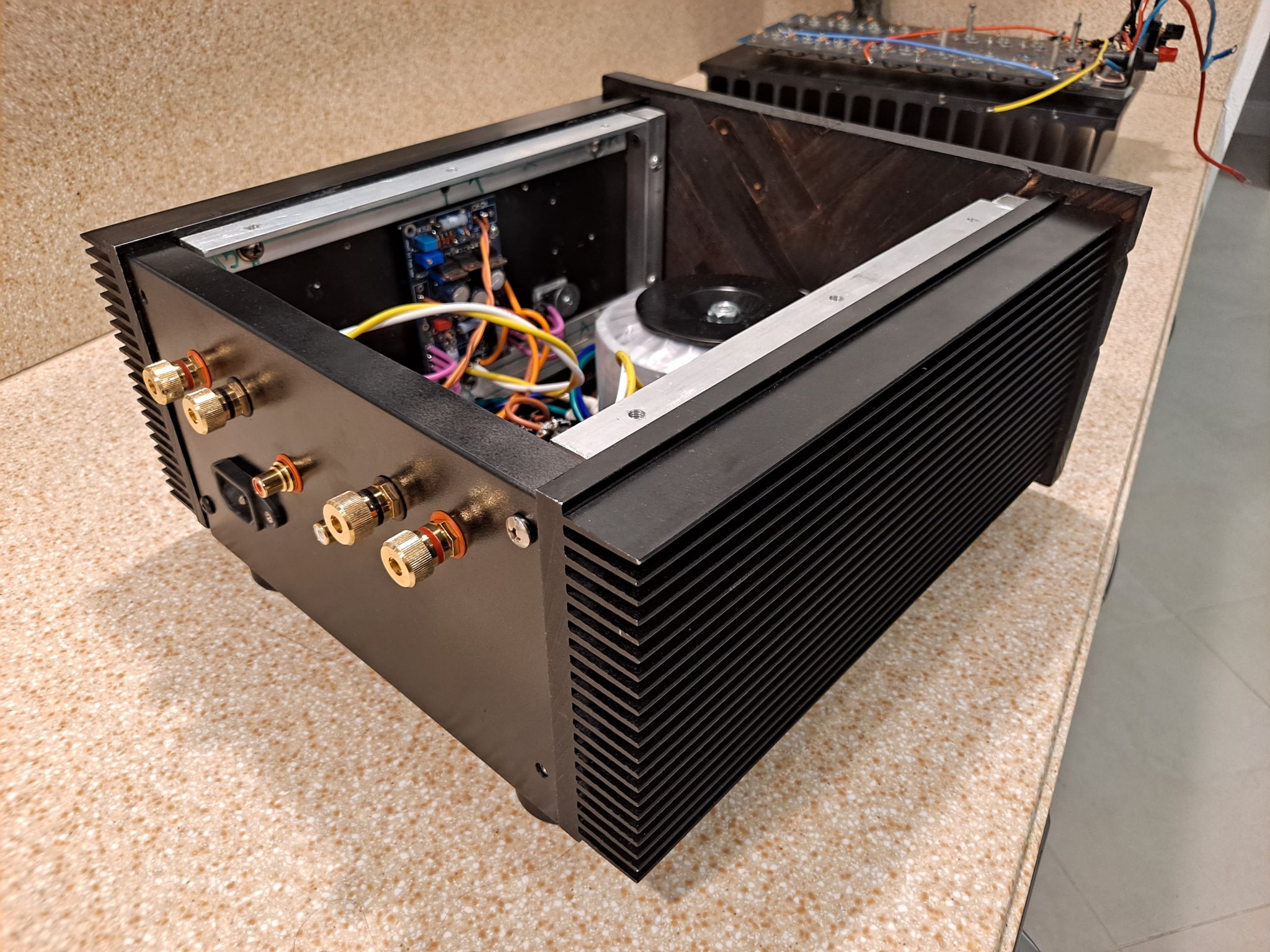

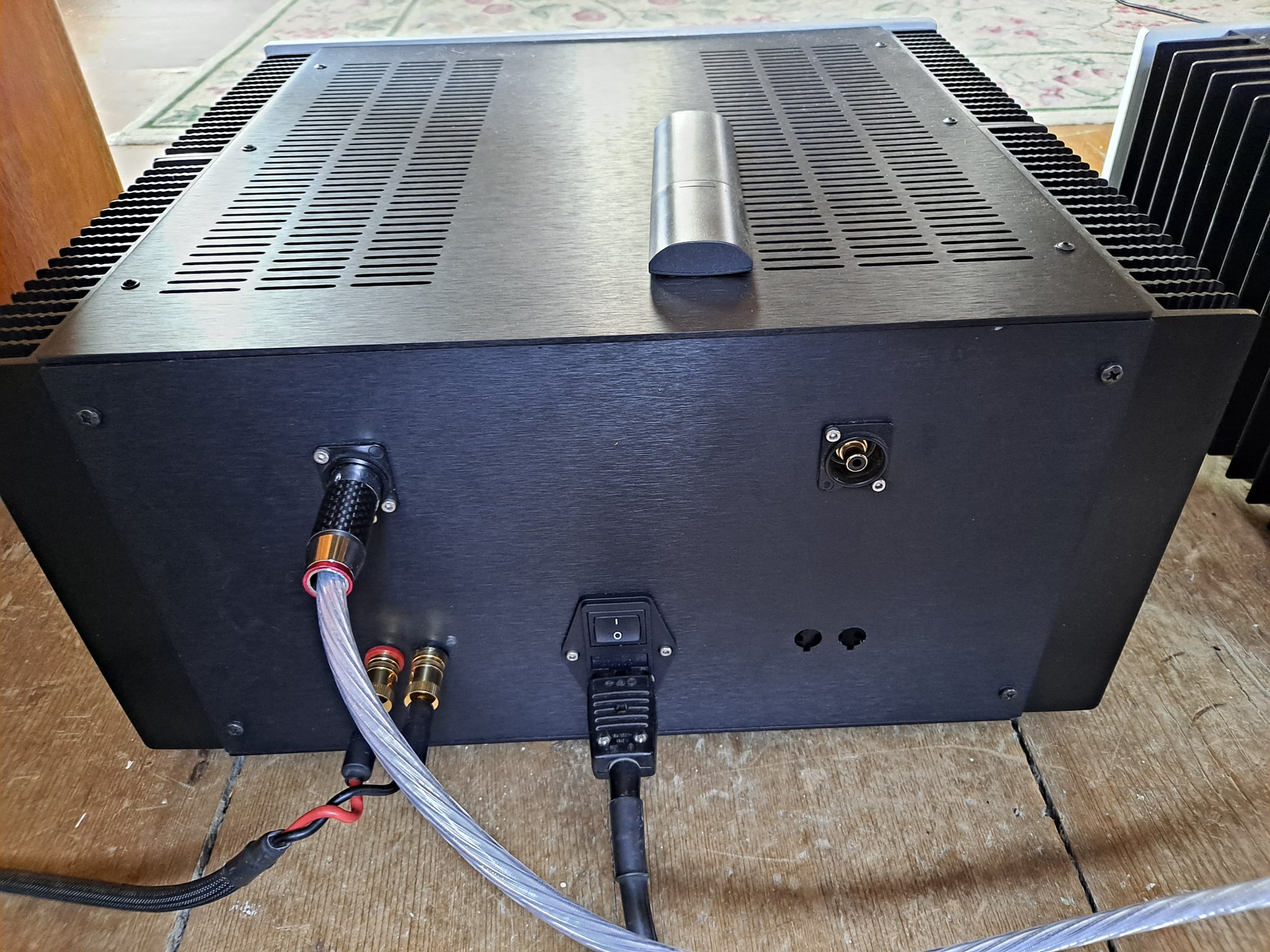

I finished these Aleph 2's about a month ago for a friend. Randy's boards are easy to use and very straight forward. Mosfets were well matched and the 9610's being harris parts are icing on the cake.
I went the bolt-it-together approach trying to keep things as simple as possible. The only holes that I had to drill were opening up the holes for the transformers and the holes for the rectifier bolts. Otherwise no machine work. Not something I am used to.
I have the heatsinks between 25-30 degrees celsius above ambient.
The amp sounds terrific. A nice large weighty sound with a little warmth and sugar on top. Reasonably detailed while not being a fast amp with sharp edges. One of the Pass sounds that I have come to love. Before these, I had only heard Aleph Mini which was only around 18 watts. Going off of memory, I hear a lot of similarities with the Aleph 2's being a lot better overall.
A big thank you to Randy and Mr Pass! 🙂
Attached are a few pictures. Don't mind the state of the floor and trim. This is an 1840's farm house that is in the middle of a remodel.
