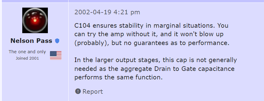

C104 sullo schema Aleph 3 è C6 sui PCB "Classic Aleph".
Da papà stesso:
I just don't understand Why in Aleph j this capacitor has been eliminated...do you think there could be a precise reason?https://www.diyaudio.com/community/threads/aleph-choice.3176/
C104 on the Aleph 3 schematic is C6 on the "Classic Aleph" PCBs.
From Papa himself:
Or maybe the answer could be written here?
https://www.diyaudio.com/community/...rsus-later-aleph-versions.148640/post-1900830
