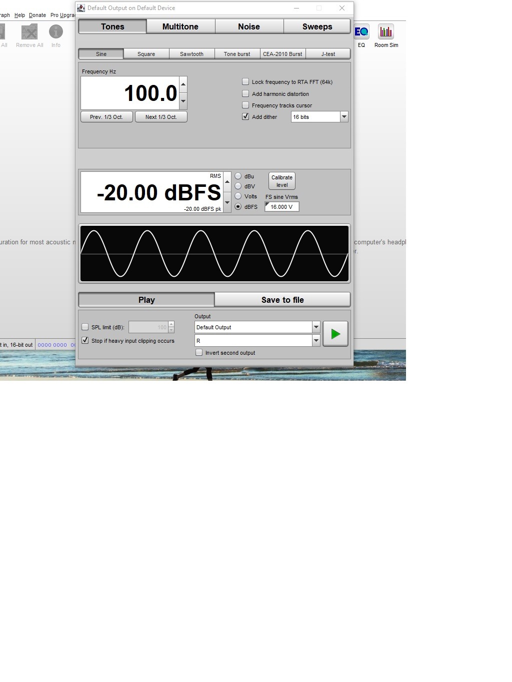

I'm familiar with REW. This works well?Found the problem! Y'up, my P2 has a 500k pot. I had problems with out of stock, so I must have ordered the 500k twice, and didn't catch it.
Thanks so much guys for the help! You both were right on it, and correct!
I am just using a laptop with REW software for the test signal, so I thought it might be the problem, but it works fine, and so for those that don't have a signal generator, I recommend this option.

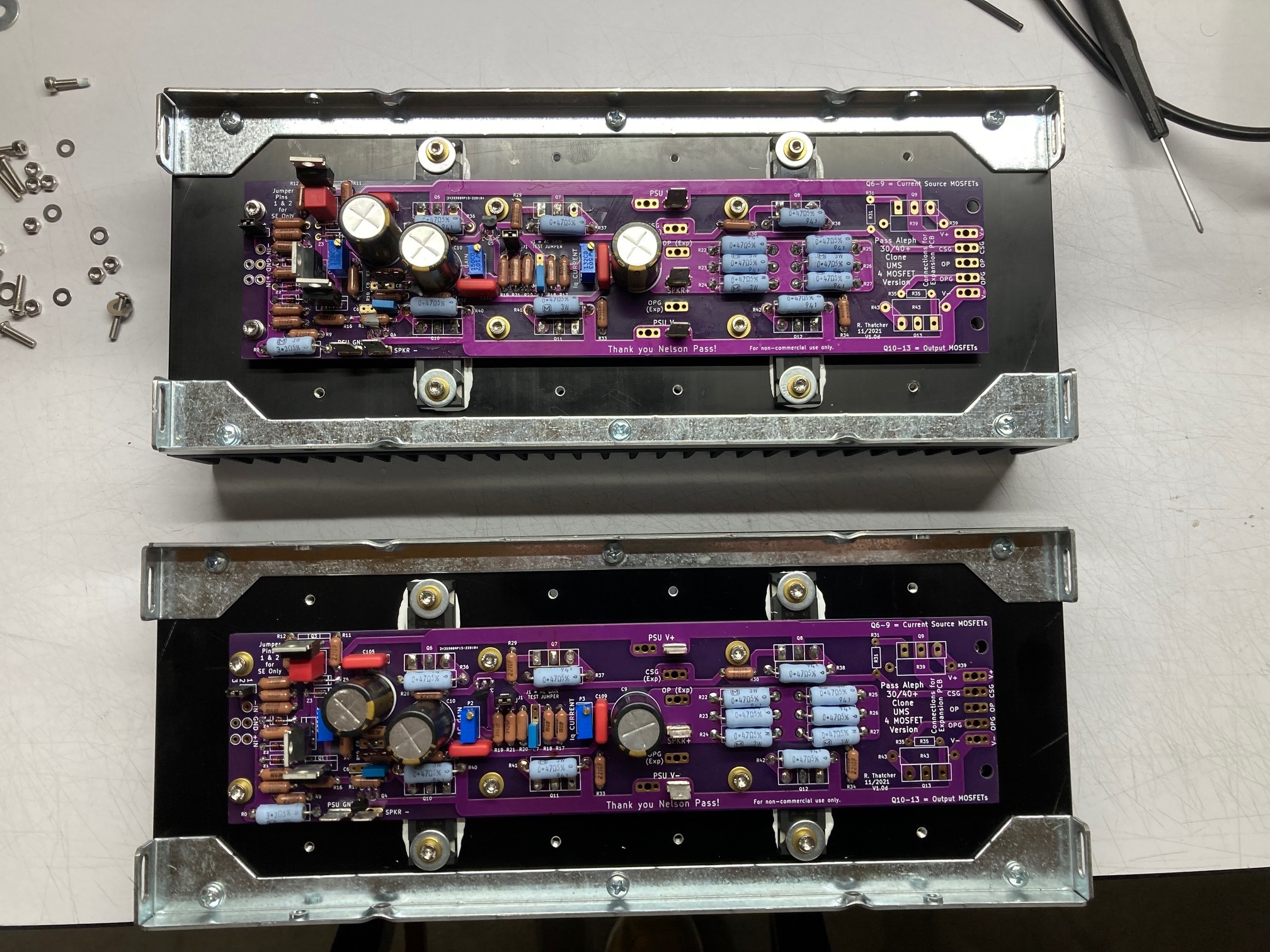

I made a tweak to the Aleph 60 Build Notes. It's updated in Post #1 of this thread.
NOW REV V1.0F (29 Feb 2023)
Updated schematic for A60 specific values
Added cleaner "old school" schematic.
Replaced some caps in the BOM (Silmic 2 for Panasonic FC and some out of stock PSU caps with in-stock PSU caps)

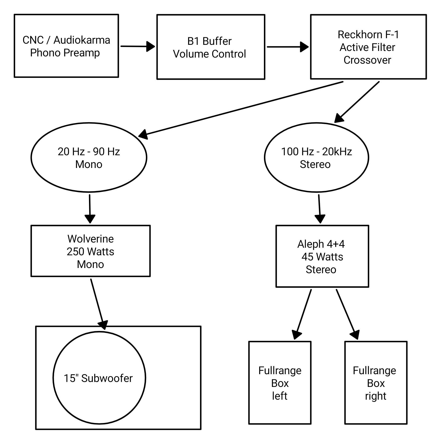

I know what you mean. I recently finished a Wolverine amp, but I also love the sweet Aleph sound. After years with a HiFi Setup i switched back to where I am coming from: jamaican sound system style. I hooked up a cheap yet good sounding active subwoofer crossover. Now I am using my Aleph 4+4 build with my 2-way loudspeakers and one channel of the dual mono Wolverine for an old 15" Speaker. Sounds great with Reggae and Dub, I feel sorry for my neighbours..
