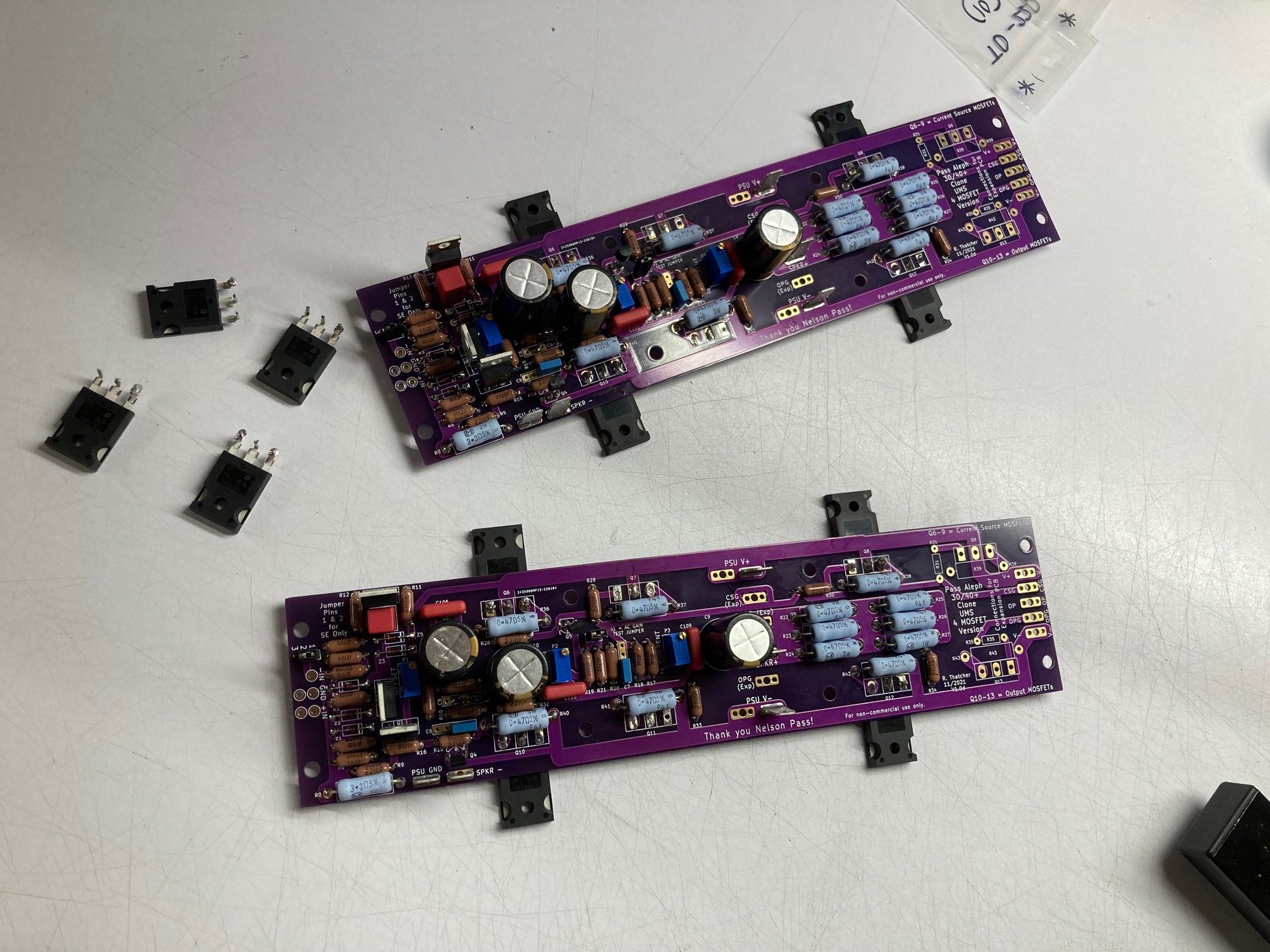

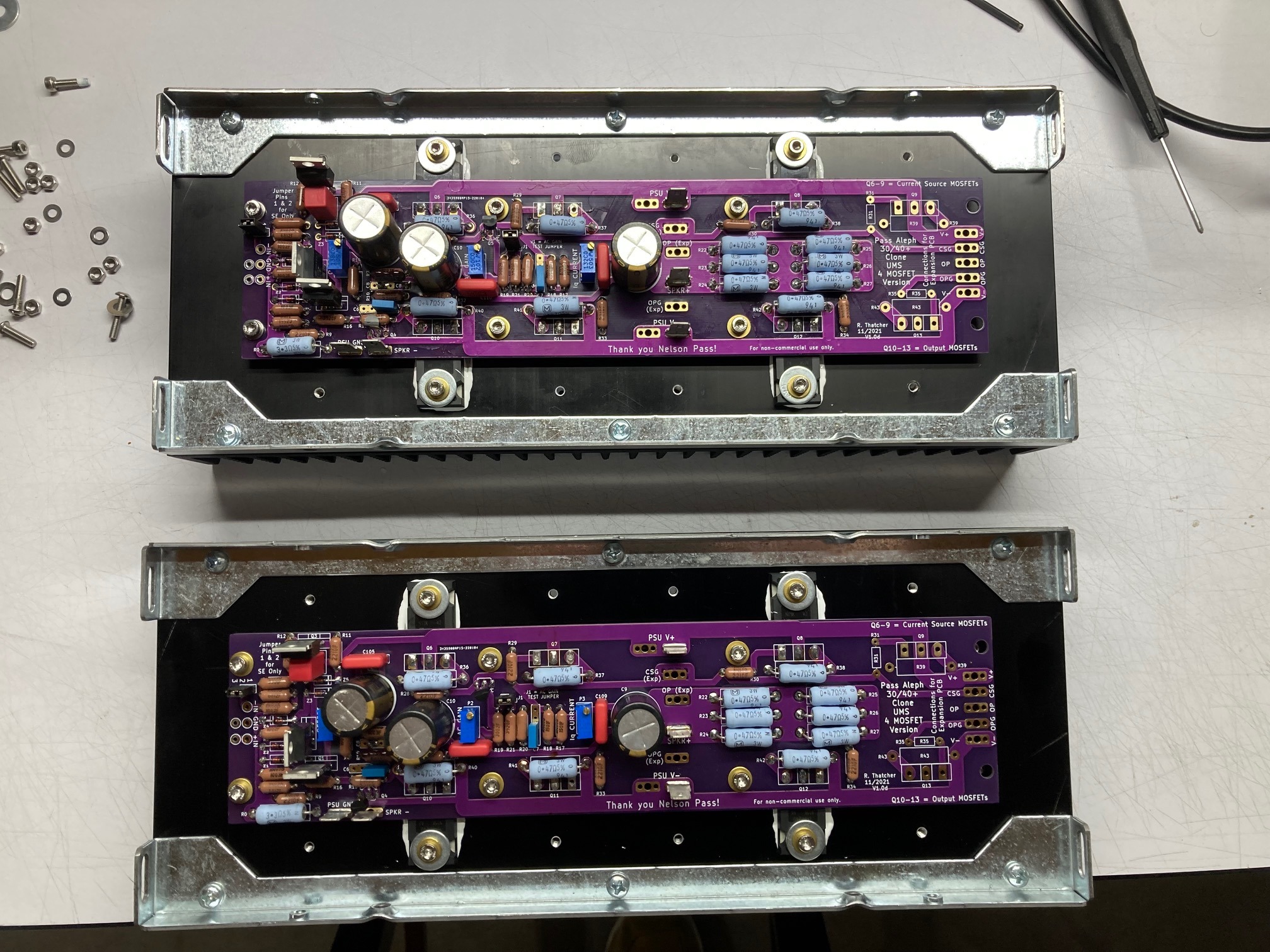

Speaking of meek, I had need to use a 3U chassis for my Aleph clone. There's no way 100W/ch of heat would have worked, so after a think I pulled an output stage out of my Aleph 30. I guess this makes it an Aleph 20? Bias is now just a hair under 1.5A
It works on the bench & doesn't get too hot. This mod bought another 2V of rail swing and maybe a tiny 10mA increase in bias. The DC offset if anything got a touch better.

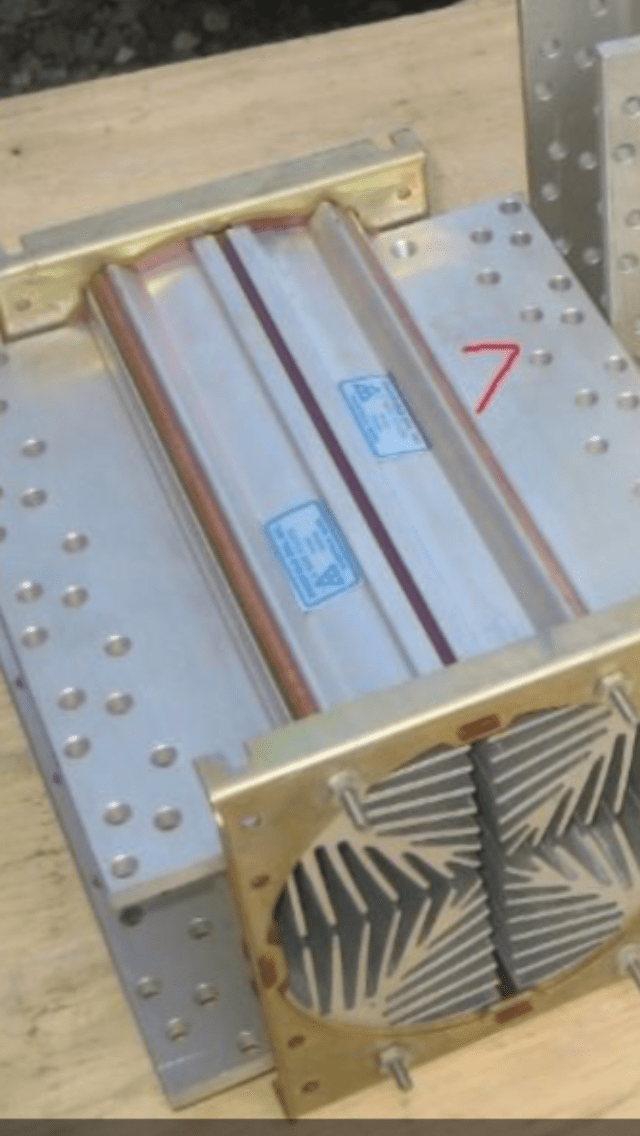

Another possibility would be to change the 5U heat sinks with flat slabs of metal. On the outside, mount some big Xeon class CPU coolers... that will work, BUT will be a bit loud. So, I'd recommend the liquid cooling to passive radiators to absorb the extra heat load.

The Krell that has those nice, expensive fins in a way that you can flow air over them. Force air through them ought to be simple. A single fan, with the cooling fins in a "tunnel" will flow cooling air through them.
With Randy's proposed chassis, to properly cool an A1.2, with a fan, would take full coverage, the heat sinks will have to sink an additional 100 watts per side, 200 per chassis. So, either build a box on either side or mount three cooling fans directly on either side. Either way, it's gonna look like a monstrosity. The thing is already 18 inches wide.
Or, like the Audio Research cooling fans of yore: enclose the sides of the chassis with an aluminum plate so that the air flow across the heat sinks is vertical and mount a "pizza box" enclosure above it with the fans drawing air from above it so it flows over the heat sinks. The whole thing could be built as a single piece "shroud". The problem is that without empirical data we really don't know how much cooling can such a set up handle.
Or... put the power supply in one chassis and the amps in another chassis... Will the 300 watt capacity of each chassis suffice?
Or got with active CPU cooling via pipes to external heat exchangers. We know the rating of those devices, the only issue being how to mount those heat pipes to a secondary heat exchanger chassis.

Shows some active cooling options and gives an idea of their performance
https://gdrectifiers.co.uk/products/category/heatsinks_and_hardware/force_air_cooled_heatsinks/
PSBF160bgives 0.12c/w for 175mm and is 82mm x 82mm. This with a 12v fan but doesn't state air flow rate/ fan speed.
So quite good performance for a compact package
PS260 over 300mm gives 0.07c/w with a 5m/s airflow. 125x135mm extrusion.

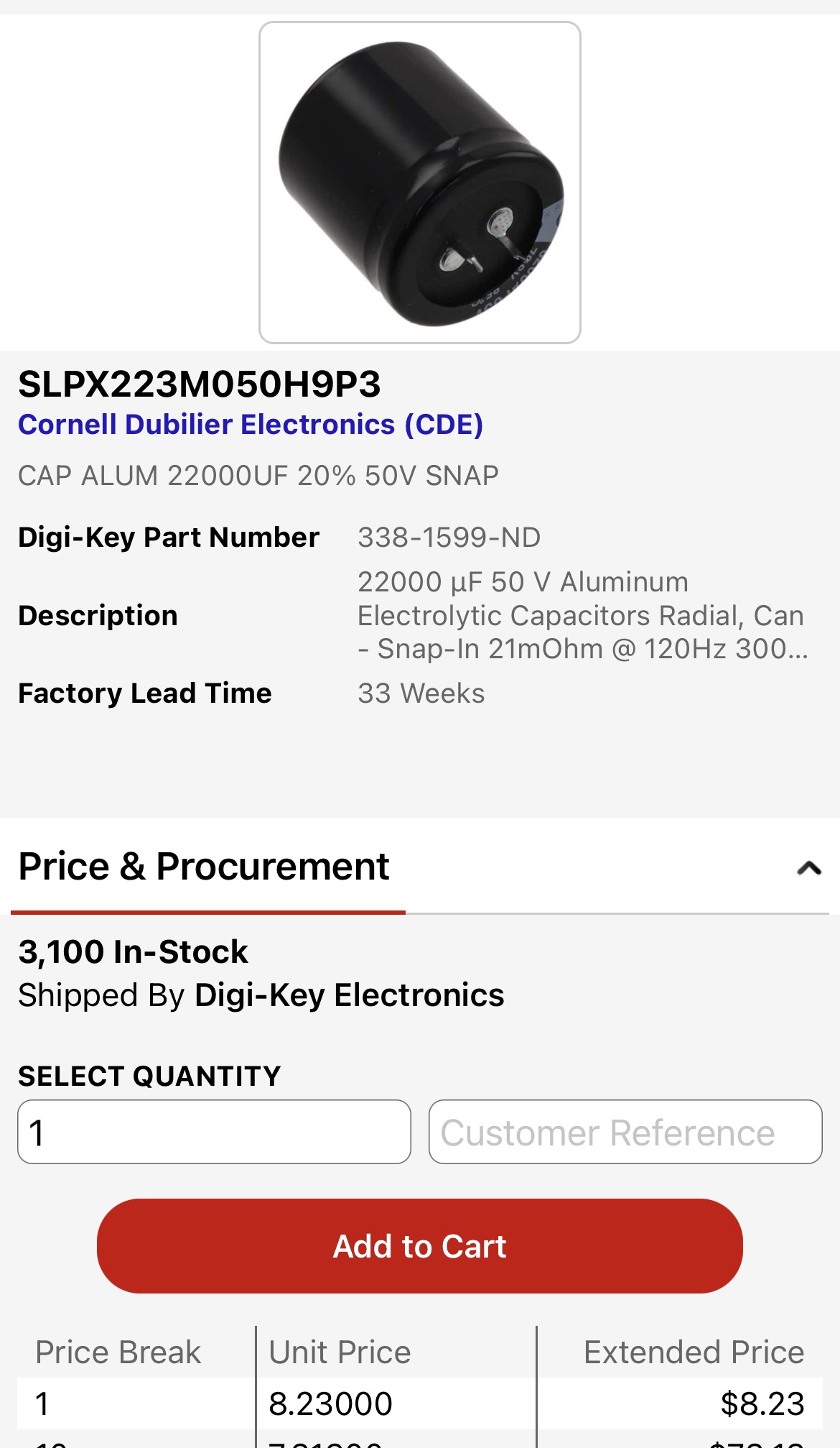

Is it just me or Caps for 100w monos in short supply right now? Look for at least 55vdc and something at least 24000 capacitance or over. I am not rushing this build but start buying the more expensive parts. May just go for transformers now
For 100w Aleph 2 you can run 22kuF / 50v.
But if I have two 50vdc rails on one mono I don't need some Room above 50V or will I be ok?
If you’re planning 50v rails then you will want headroom over 50. What donuts do you plan to use? 45v rails should be good for A2 clone. 5v to spare on the caps.
