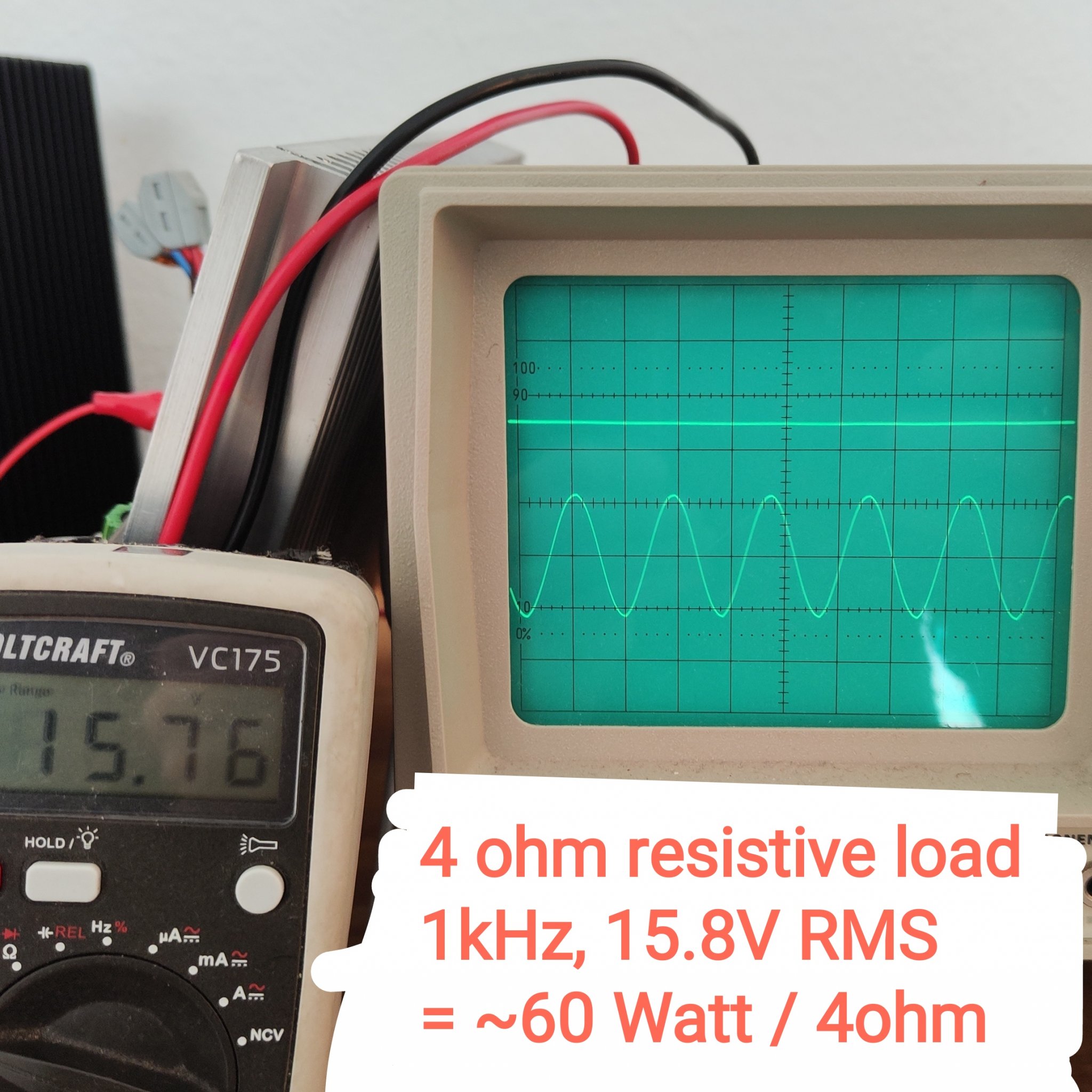

Do you really need to run it so hot at 2.7A? Is it for the power on 4 Ohm or the THD figure? Or?
The aim was to build an Aleph 35+ to see where we can go with only one main board and no expansion cards. To achieve more power compared to Aleph 30 the rail voltage and quiescent current had to go up.

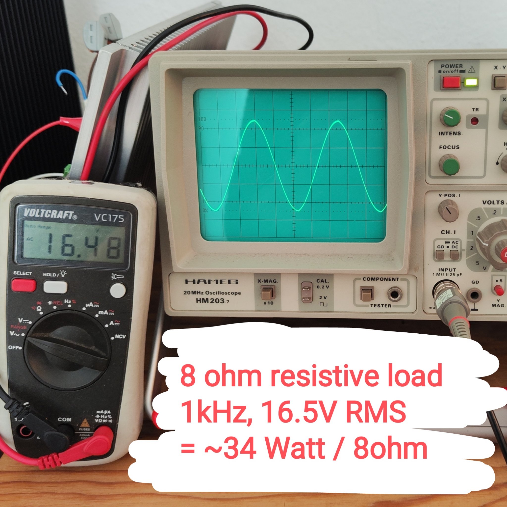

By the way, here are my scope pics of one of my channels:
Clipped waveforms @ 18V RMS into 8 ohm:

I am asking because I have a similar Aleph 40ish plan (already have PCBs and FETs) in a dissipante 5U/400. However, the bottleneck remains the heatsinks dimension. I made some simulations assuming 125 W dissipations and indeed the bias and/or rail voltage must be lower than yours.
At this point I am wondering if I should go with a plain A30 (6 FETs) or is it worth going for a kind of A30+ (with 8 FETs)? Citing Papa (here) "paralleling
devices at somewhat lower bias can give you greater transconductance" but I do don't know what this would mean sonically.
I cannot go with a 5U/500 and even with monoblocks (that deviate from the idea of an Aleph 40 IMO).
... I made some simulations assuming 125 W dissipations and indeed the bias and/or rail voltage must be lower than yours.
I think 125 W will still run hot on the 5U 400 enclosure, depending on your living room temperature. But not as hot as 150W for sure.
With your dissipation budget you could decide to optimise the amp for either 8-ohmish speakers or 4-ohmish speakers.
To achieve more power into "easy to drive" 8-ohmish loads, you could choose a rail voltage of 29V with bias set at 2.2A. This way you could achieve ~42W into a 8-ohm resistive load.
To achieve more power into "heavy" 4-ohmish loads you could go with 25V rails and 2.5A - that should give you ~50W into 4ohm resistive load.
For a dissipation budget of 125W per channel a 6-Mosfet configuration is still sufficient in my eyes. Each MOSFET will dissipate ~21Watts, which is okay (with a sufficient heatsink).

Can someone help me to interpret the "clipping" sinewave in post #605 above?
To me it doesn't look like normal voltage rail clipping, but I am not educated enough to interpret the waveform correctly.
Could it also be the current limiter circuit kicking in (bottom side of waveform)?
What kind of "ringing" does the waveform show in the top half of the picture?
lift one side of the resistor, feeding the voltage drop to the limiting transistor (that shorts the voltage drive to MOSFET(s)), and try again...?
pls share the circuit diagram..?

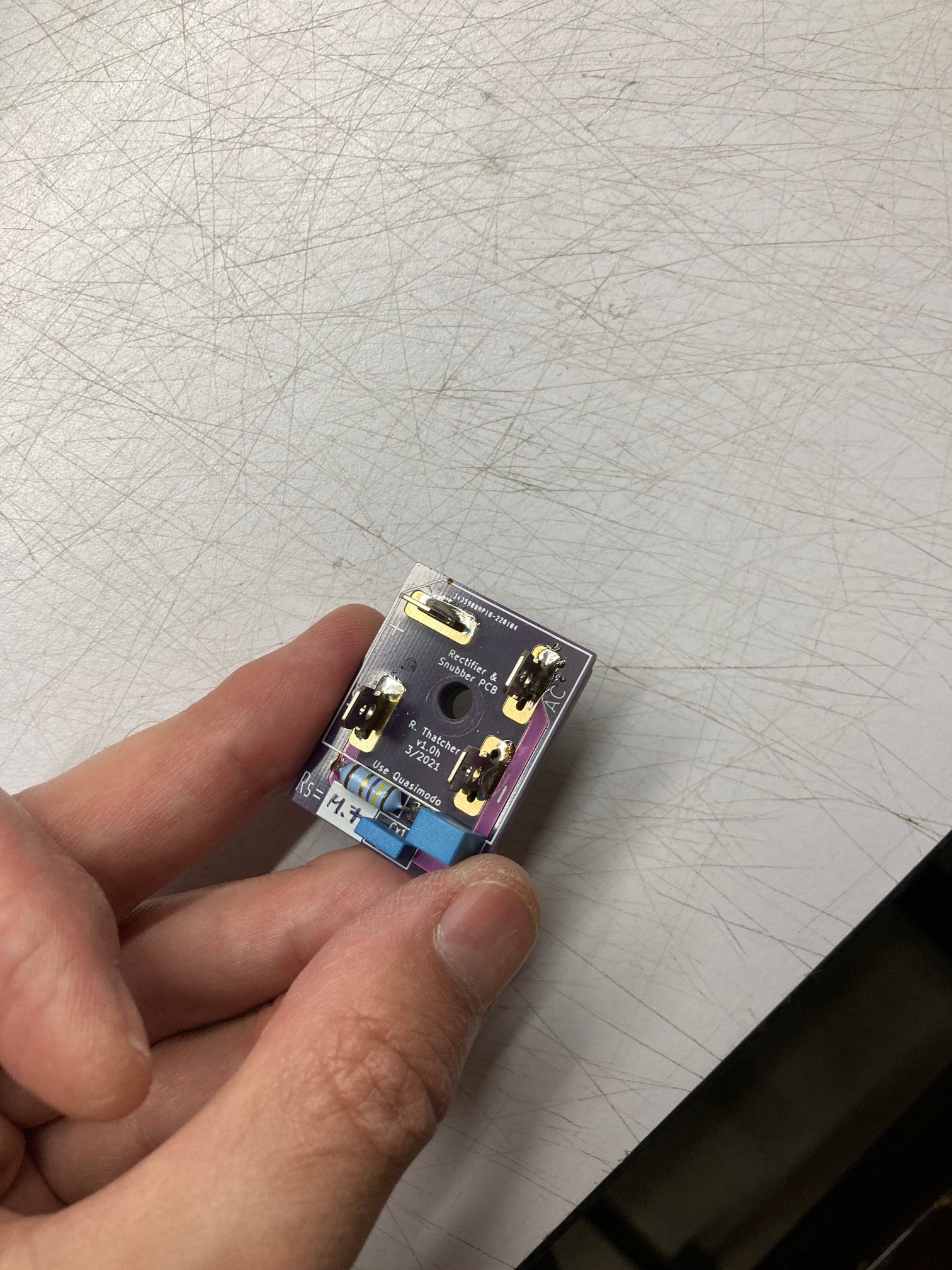

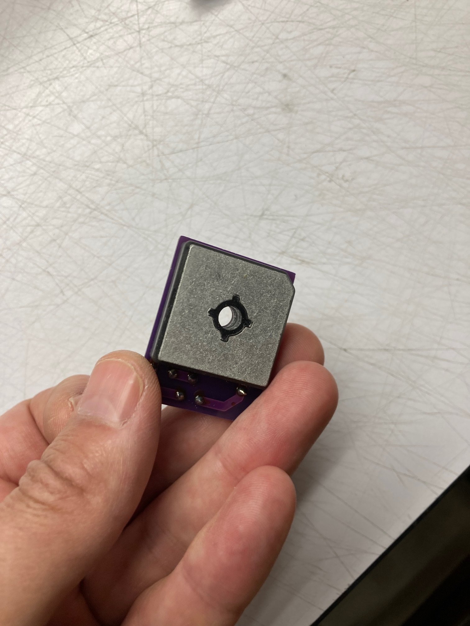

I have a build question. I had low level hum in my Aleph 30 I couldn't solve, and repurposed the chassis for another amp. Today I realized that I'd been mounting the metallic backs of the bridge rectifiers directly to the metal chassis, meaning they were in ohmic contact with chassis ground and hence with each other. Now I can't read any DC resistance between those metallic backs and any of the four rectifier poles, however I can read a capacitance of 100-300pF between the metallic back and any of the four poles, depending on the pole. Could this be a source of hum? Do people insulate these metallic backs from chassis ground when the mount them?
