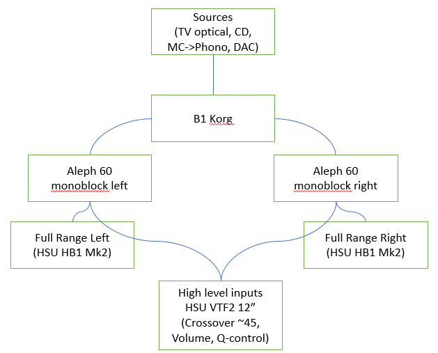

Here's the chain casa Toadroller:
Fortunately my nearest is easily 100 yards away.
I can and do sing the praises of HSU's directivity-controlled horn bookshelf speakers, still available new for $400 a pair, an utter bargain until I someday get the itch to look into the open baffle conversations on other parts of this site. They're so smooth, image like mad, timbre is so real, and don't get shrill as the volume knob goes up. Same family subwoofer, tweaked by the tiniest of increments over months to what sounds best to me.
Music is the spectrum of rock and pop you'd expect of someone into his fifties, and a not insubstantial amount of classical jazz (e.g. Monk) because I can't get enough of hearing the instruments and studios on recordings from the 40s, 50s, 60s.

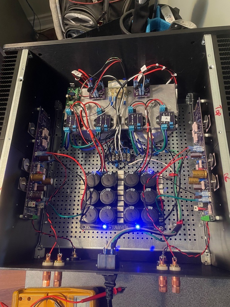

Aleph 30 initial startup. No smoke this time! DC offset 37/39. Warming up nicely!
Many thanks to Randy.

For those of you wondering what power supply @dantwomey is using... It's a new one called the "W12 - Continental". It's 2 CRCRC's on one board. It is for dual donuts using a 6 pack of caps per channel in CRCRC configuration. V6+V6=W12 The goal was to go for dual CRCRC on a more compact footprint than a pair of the V8 CRCRC boards. Once again using the rectangular 5W resistors.
Dan is the first to try this one. I'll put putting one into a ZenMod XA252 soon, and I'll also start a thread at some point.
You saw it here first.

Cool. That looks like a neat setup. Is the small transformer and the green board for some kind of relay setup?
Yup, it's the standard AMB Labs setup to use a Bulgin switch. The ε24 power switch driver circuit

I'm not quite sure what you mean. The toroids are mounted with the standard rubber gaskets and top plate supplied by Antek. The only thing I've done here is add a piece of 1/4" aluminum plate on top to mount a number of components.

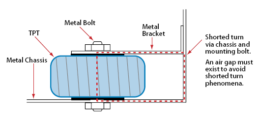

The two toroid bolts along with the top and bottom plates could form a shorted turn through the two toroids.
@dantwomey
You want to make sure that the bottom perforated plate and your top aluminum plate connecting across the centers of the two toroids is not causing a shorted turn.
Insulate the toroid mounting bolts on both bottom and top of each toroid.
The concern is, if you were to test with a DMM, you could have a direct connection (ie. Short, 0 ohms on DMM) between the top bolt of one toroid across to the bottom bolt of next toroid. That would confirm a shorted turn.
