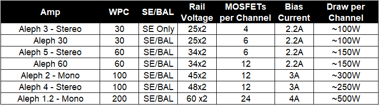

Randall, do you think a 5U400 case would handle your main board with all 4 output mosfet pairs filled and a higher single trafo DC PSU, like 30 to 40 Volts?
https://www.diyaudio.com/community/threads/store-heat-sinks-thermal-numbers.392902/
I looked at Nelson's post here. Looks like a 5U400 is good for 158W per heatsink. Call it ~300W dissipation per chassis.
Back to post #1 on this thread there's this:
5U/400 could take the heat of an Aleph 60 or Aleph 5 Stereo / Dual Mono.
Of course the Aleph 2 Mono works nicely in a 5U/400, too. That's been proven a few times. I built a pair, and a few others have, too.
