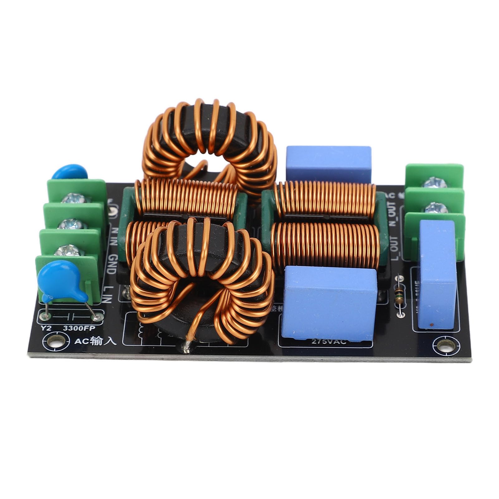

I have my linear on a separate power strip , my digital (with SMPS's -PC) connects optically. Cheap SMPS's can turn the whole power strip into a transmitter.
Yes , filter my linear strip (below). Power company Sine is still distorted by all the scamerica cheap China SMPS's through out the building.
Here in "scamerica" , SMPS china junk can infiltrate despite having "CE" and other loosely regulated safeguards , which are overlooked to make more profit.
I like EU , they actually adhere to rules. Internet is the same in "scamerica"....
OS
