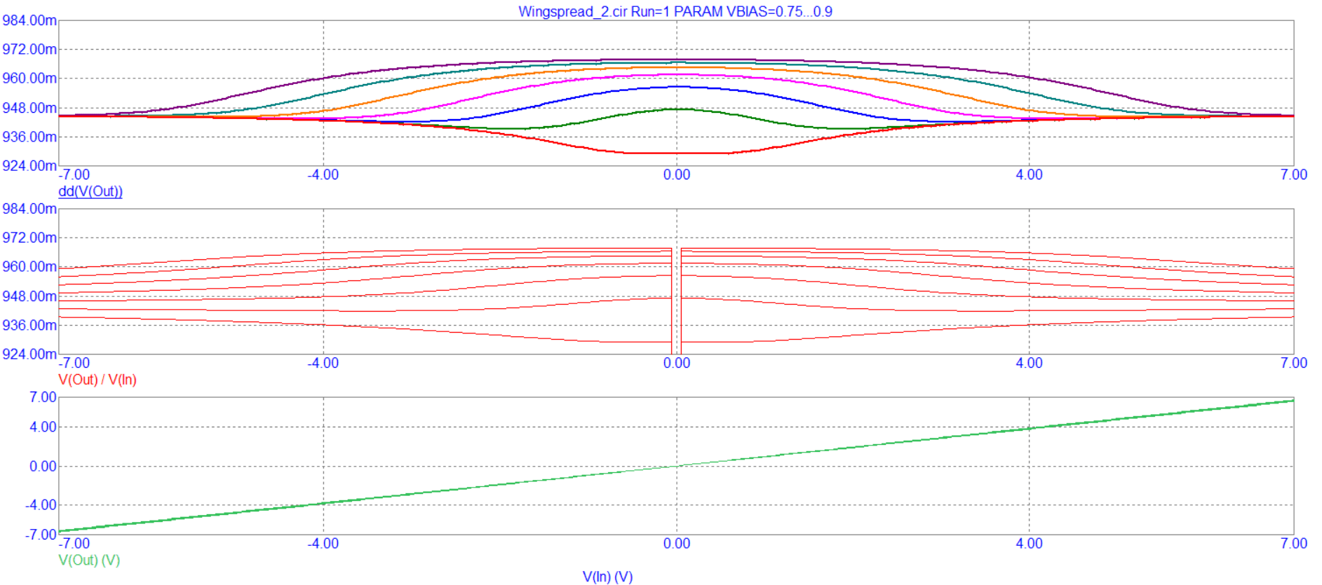

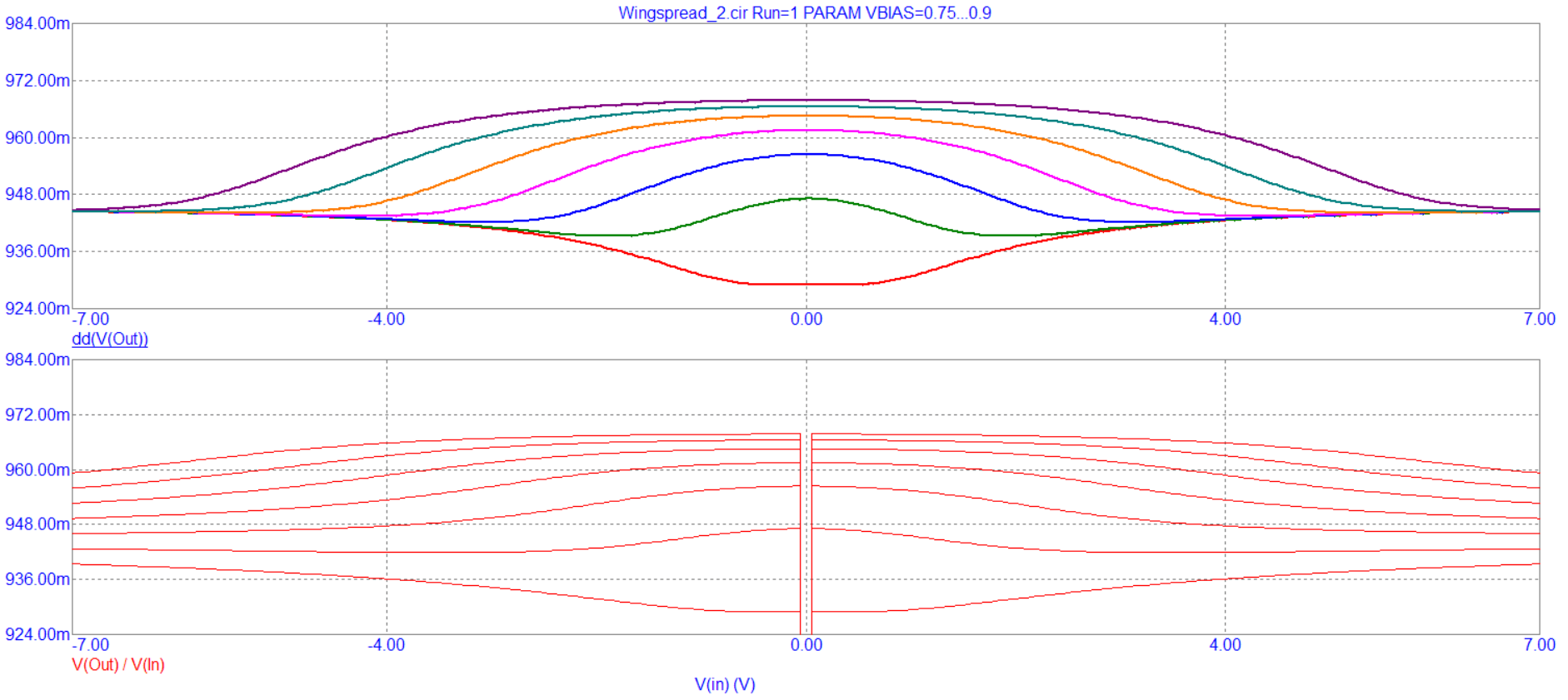

Yes, the DC gain (which for EF is slightly less than 1.0) across a range of DC input voltages. Often, many diagrams, corresponding to various bias currents, are shown together:
(source)
Note that AC behavior, and in particular frequency dependent AC behavior, may be different.

my quick play with MC12 has confirmed (in my optimization view; while keeping the perhaps strange-looking parallel circuit) the most favorable result with Douglas Self's optimal bias diction: clearly Class B!
THD_1k is steadily falling and less than 0.04% at the beginning at mW.

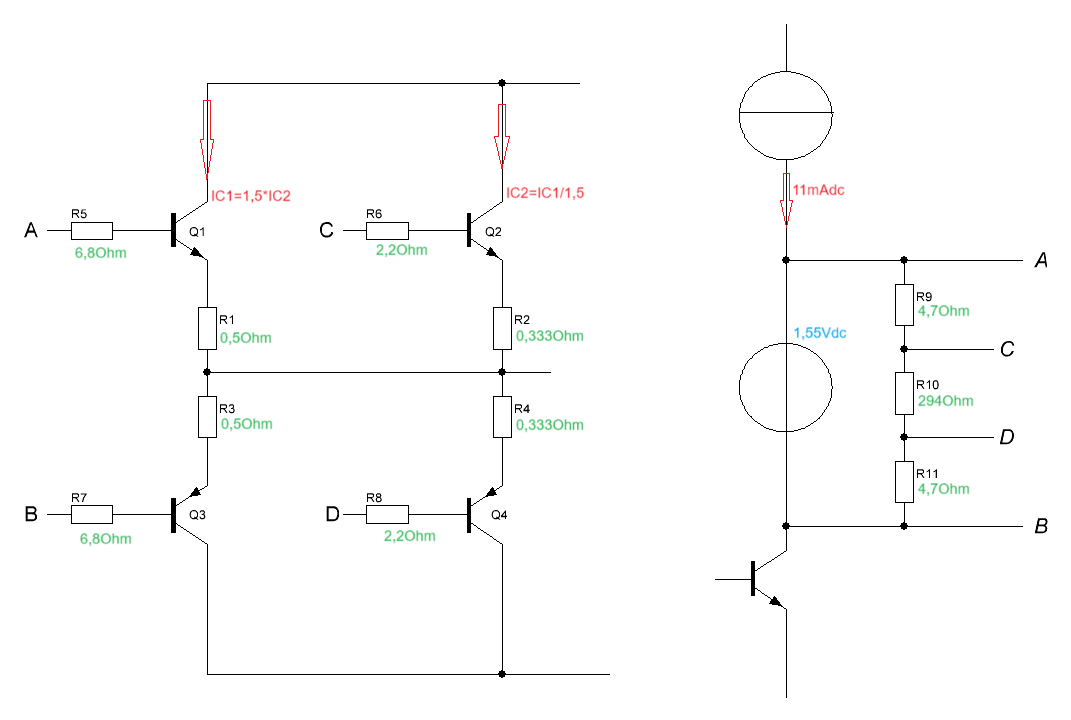

You are absolutely right - and this is the key ...
Thanks Ed,
that's why I wrote: “I think, or rather suspect, that even this short fragment is not helpful in understanding the dynamic output resistance (EF with maximum local negative feedback through the load resistor).”
m(x, param bias)
Nevertheless, we should explain the dynamic internal resistance of “the source” - or the output resistance of “the EF”.
This brings us much closer to the term gm-doubling.
But once again to the equation systems to be solved - the zero is the problem!

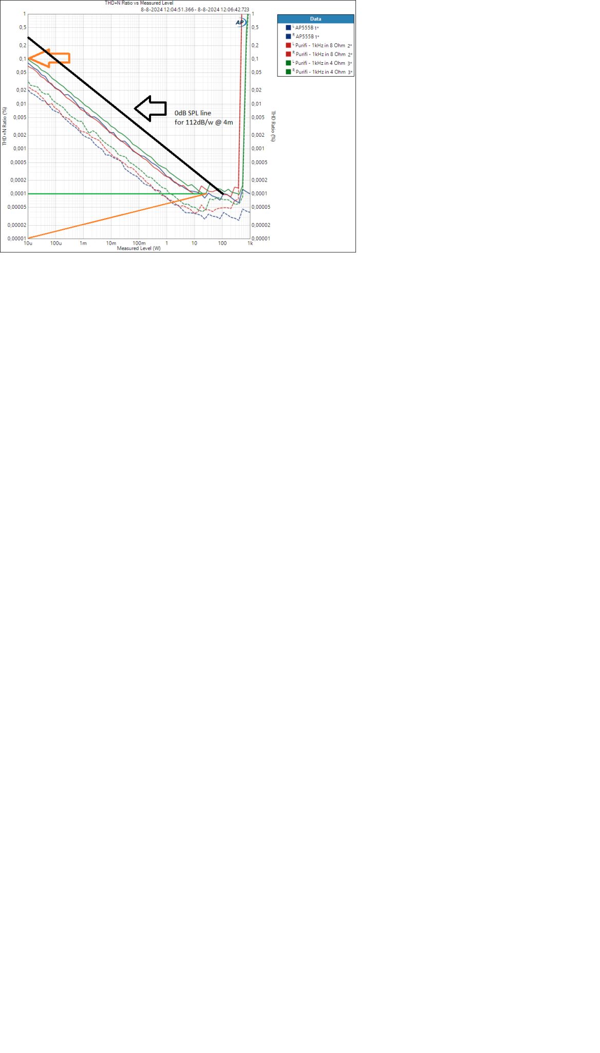

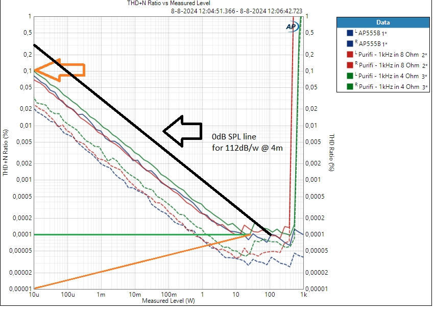

yes I did noticed that , but again at 1mW measured THD&N is 0,01% (still nothing special), anyway IMHO it will be much better amp if THD vs output power characteristic is flat (green line) , or is inverse to actual measured data (orange line) ,
btw , do you have any information what is the output level of generated RF signals at full output power ?
can you also plot the hearing threshold line for lets say 112db/w speakers at listening distance of 4m?

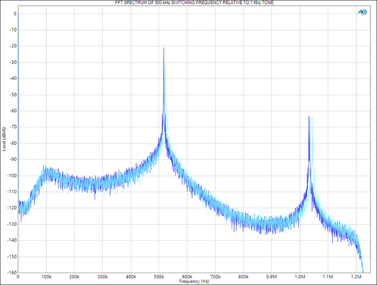

When it comes to electromagnetical pollution this Purifi amp doesnt really deserve its name,
in some way those class D amps are a disaster, i mean, at 100W/8R there s 2.8V RMS of 500Khz residual,
so the distorsion is somewhat transfered at very high frequency where it is supposed to not matter,
set apart that it create a huge pollution of the AM radio band.

Is this a measurement where the 1KHz is at max power? It does not say in the picture or review...
The signal is on the y axys, it s at 0dB, the residual is at about -20dB in respect of whatever power.
