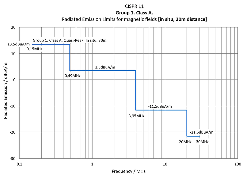

Actually, radiated magnetic emissions are allowed to be 10dB higher below 490kHz, so Hypex would have more room to operate withing compliance. But AFAIK, for both the switching frequency is not fixed, rather it is modulated by the signal, and of course there will be harmonics anyway that are within the more restricted range.They define the allowed emissions within used frequencies, FI the Hypex switch at 460KHz while the Purifi is at 520KHz,
this way their EM pollution occur outside of the official AM range, so it s clear that the switching frequencies were not
chosen randomly as if these were within the AM range then the amps would be deemed as non conform,
that s how they manage to be within the emisions requirements.
Bottom line, I would assume both do not only comply to the limits, they also are below the AM range limit at all frequencies. So it is quite possibly not correct to imply they -- Hypex, that is -- only passed EMC test because the switching frequency fundamental might be in the less restricted range below 490kHz.
These allowed emissions amount to 200uV/m and 70uV/m for the two first plateau asuming that the recipient is a tuned antenna,
notice that the distance is 30m, much more than the distance between two apartments in a same flat.
Obviously that s quite loosy standards, and that will be the case only if the speakers cables are short enough,
according to Maxim semiconductors it should be no more than 2m if the device want to pass the EM validation,
not sure that all Class D users are aware of this fact.
