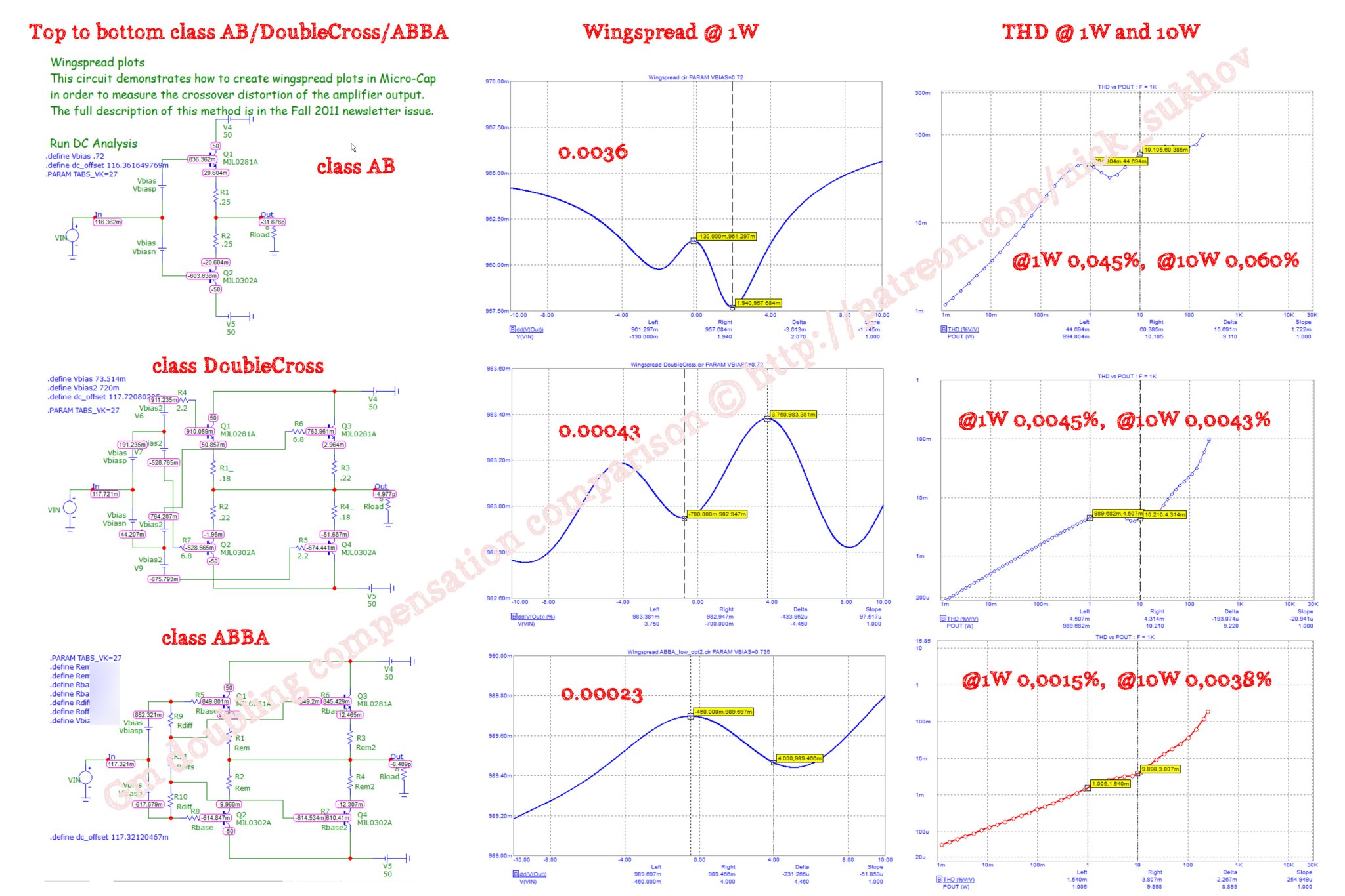

Oliver and Locanthi gave us the correct version of Class AB in the last century. However, many have succumbed to ear-damaging Class D in the new century. This is while it's been several years since the improved versions of the old good Class AB were introduced. One of those are DoubleCross by Cordell/Hegglun that is at least order of THD better. Another one is my patented Class ABBA that is 30 times better than plain vanilla Class AB. The hardware costs for those improvements are negligible -- for Class ABBA it is just a pair of additional low power resistors. The detailed schematic description, PCB gerbers, BOM, and datasheets for my amplifier are all here:
https://www.patreon.com/posts/umzch-vv-xxi-v-81828557
The screenshots of AB/DoubleCross/ABBA simulation in easy-to-compare side-by-side layout are attached. The simulation was made using Microcap 12 that is probably the best simulator for audio circuitry. Endless thanks to its creator, Andy Thompson.

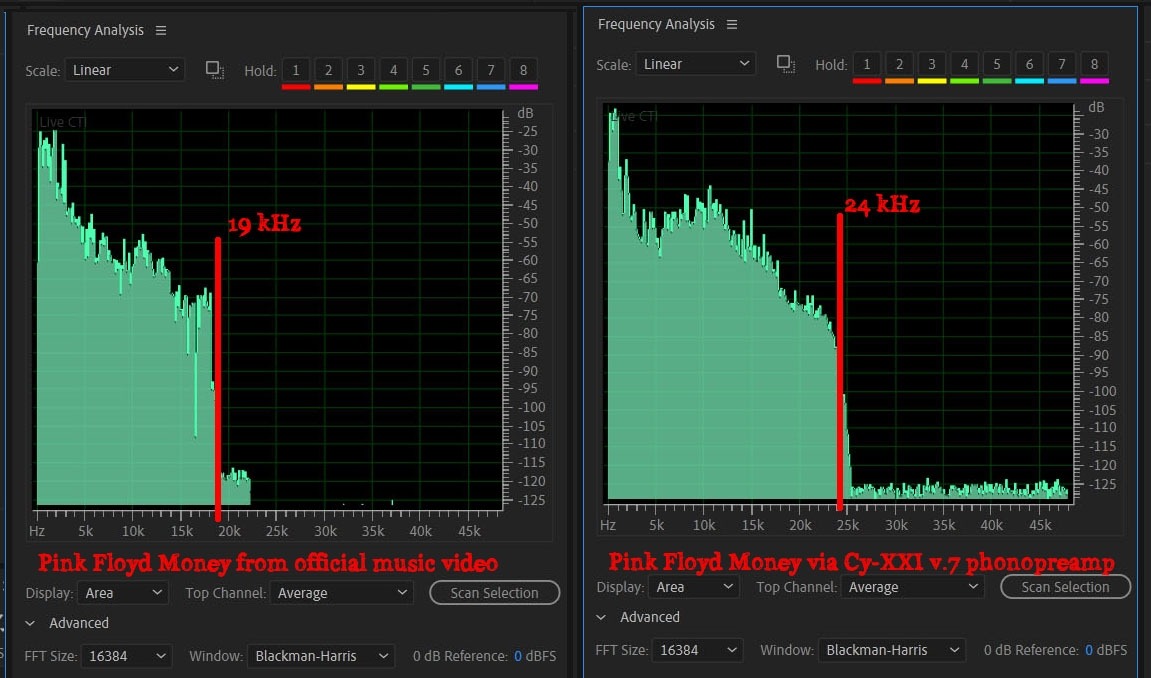

PPS to Jan - about your "1948" - compare this vinyl with digital master (attached), wich is better? - https://www.patreon.com/posts/naskolko-pink-i-105175659vias_.jpg

- about your "1948" - compare this vinyl with digital master (attached), wich is better? - https://www.patreon.com/posts/naskolko-pink-i-105175659 vias_.jpg
Come on, how can anyone judge which sounds 'better' looking at those graphs?
Maybe you can mention a preference, for instance if you like a boosted mid/range range. But better?

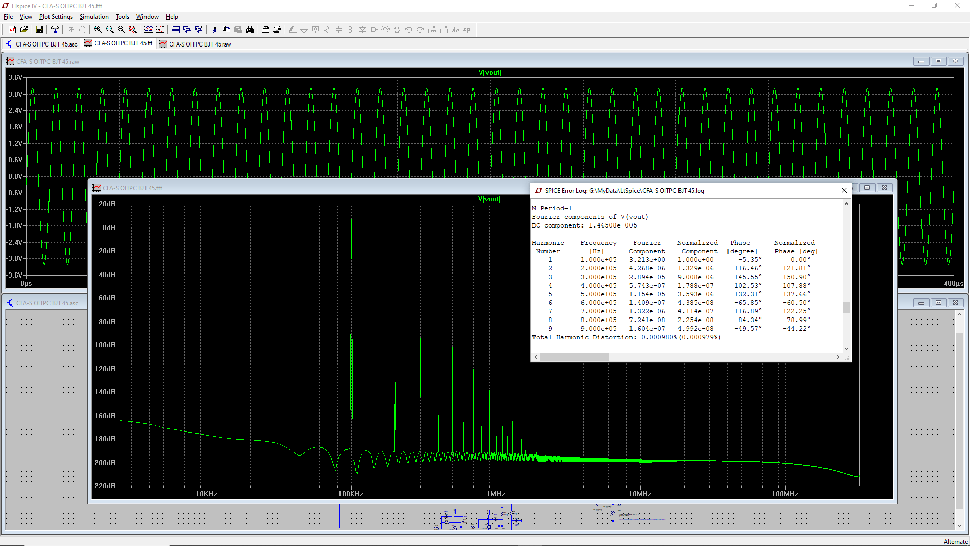

I fear the cancellation will become worse and worse at higher frequencies due to switching distortion - alas this is the regime where GNFB starts to tail off and can't help much.
It would be interesting to see measurements of physical output stages, as real devices often confound expectations gleaned from simulation. I have a suspicion that poorly matched output devices could provide some cancellation and perform better than well-matched devices (at least for cross-over artifacts - large-signal distortion less so?)

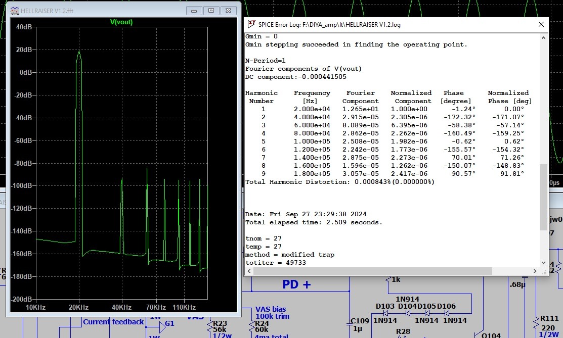

CFA is the worst of all possible, and your screenshot is of amp with NFB loop. My thread is about output stage without feedback loop. Add 78View attachment 1361222 dB of loop gain @ 20 kHz to my 0.0015% and then compare.

CFA is not "bad"(below 1). Being so fast that it can actually correct the Xover "glitch". My design stays 5-8 PPM 20-70mA Re.
VFA's need to optimally biased @ 80mA. Deviation from this really kills the specs.
