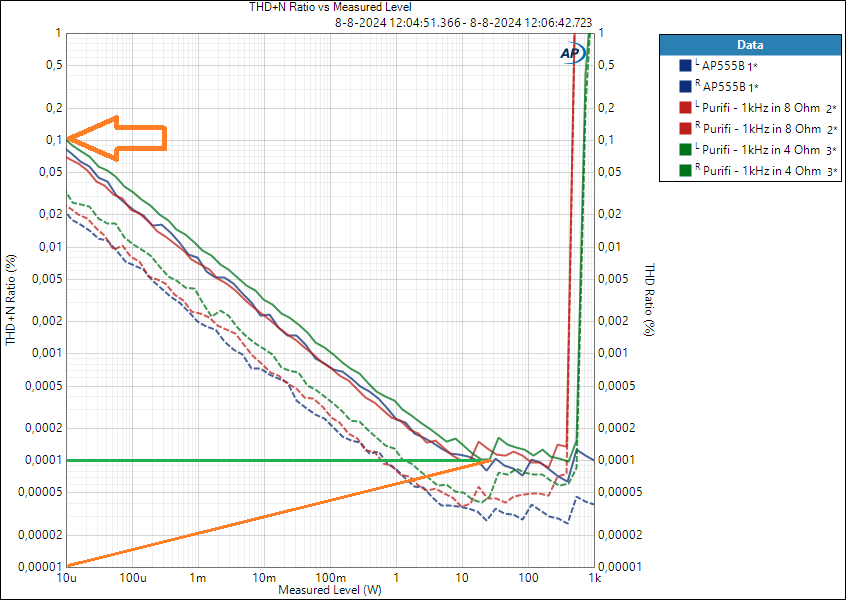

That graph shows me typical class D amps imperfection ,I consider such class D amp that have 0,1% THD&N characteristic (which is nothing special IMHO) , regardless that in range between 1W and up to full power THD&N is much lower , also I will be interested to see what is the real level of output RF noise spectrum at full output power near to clipping or even at clipping point .
You misunderstand. What you point to is close to the residual of the 555B. So it is impossible to say what the class D contributes, other than it is similar to the AP.

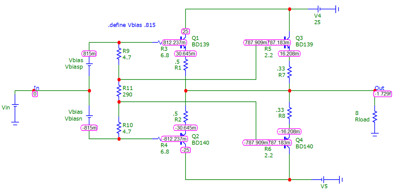

I tested the DoubleCross circuit in my simulator. I made the following observations:
* Using two pairs of output transistors reduces distortion because each transistor handles only half of the load current. For fair comparison, the baseline class AB circuit should also have two pairs of output transistors.
* Reducing the value of the emitter resistors reduces distortion, especially in case of overbias. The downside of smaller resistors is that the amplifier has less margin against thermal runaway.
When I apply both techniques to the class AB amplifier, I see similar THD as the DoubleCross amplifier.
Ed

Did you notice that 0.1% THD+N is for 10 uW output level?
Essentially, it’s just noise at extremely low level. Not even Benchmark AHB2 or Topping B200/B100 are close.
yes I did noticed that , but again at 1mW measured THD&N is 0,01% (still nothing special), anyway IMHO it will be much better amp if THD vs output power characteristic is flat (green line) , or is inverse to actual measured data (orange line) ,
Green line is impossible for THD+N as noise becomes larger part of combined THD+N at low levels, but it could be possible for THD alone.

Again, you don't understand. At 1mW it is only noise, no distorrtion.

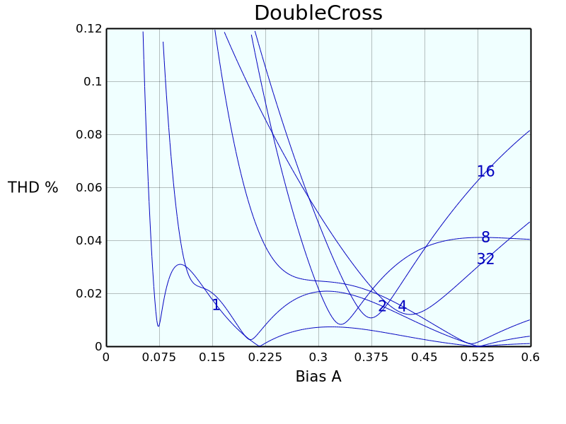

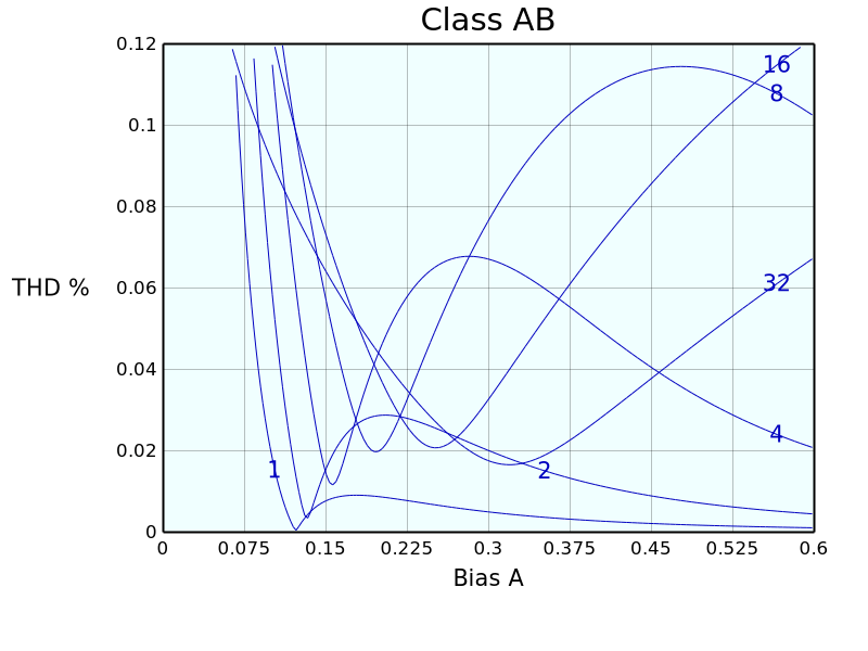

Here are some graphs from my simulator. These show the open-loop THD versus total bias current for a range of signal amplitudes (in peak volts).
Both amplifiers have two pairs of output transistors, 0.22ohm emitter resistors, and 4 ohm loads.
The Class AB amplifier has an optimum bias current of 200mA. We'll assume that the bias may drift up to 400mA with good thermal control. The rated THD would be 0.12% divided by the loop gain.
The DoubleCross amplifier has 150mV offset between the two pairs of transistors. The optimum bias current is 300mA which we'll assume may drift up to 600mA with good thermal control. The rated THD would be 0.08% divided by the loop gain.
It is cool to see the additional cancellation points in the DoubleCross amplifier. So, thanks for that!
The DoubleCross amplifier has less margin against runaway since the bias current is higher and largely flows through one pair of transistors.
The graphs illustrate the difficulty in relying on cancellation. I think that a 2:1 variation in bias current with temperature is quite good for discrete transistors.
Ed
Reactions: hbtaudio

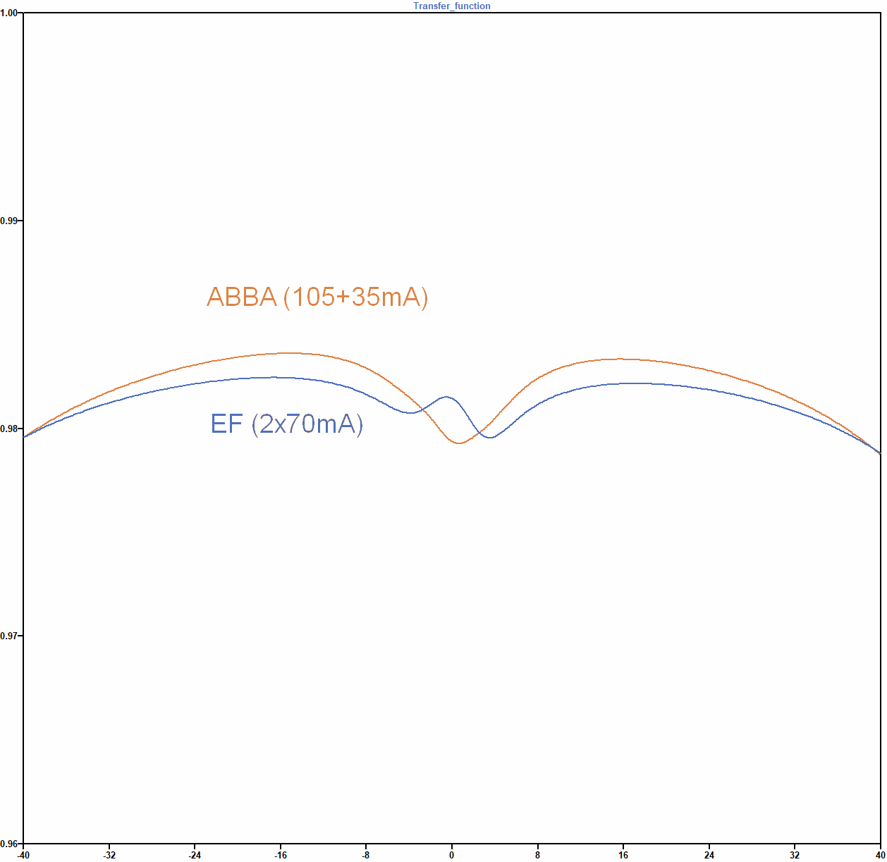

Compared to equal emitter resistors, using 25% larger resistors in the pair with lower bias results in less distortion at low amplitudes and more distortion at high amplitudes.

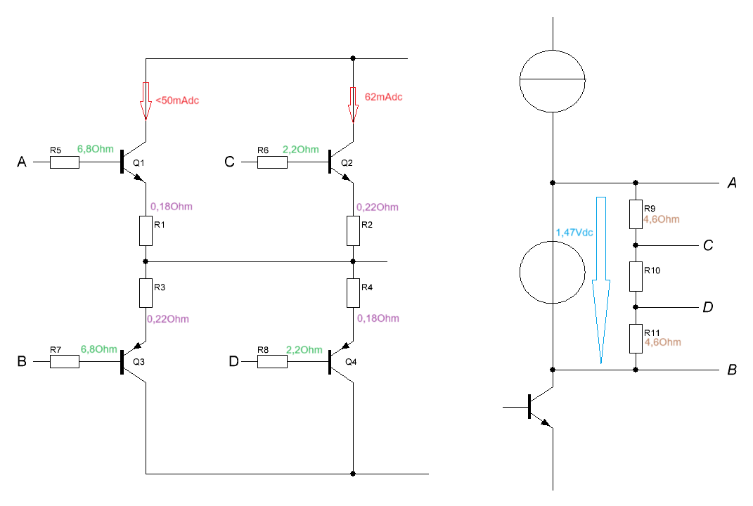

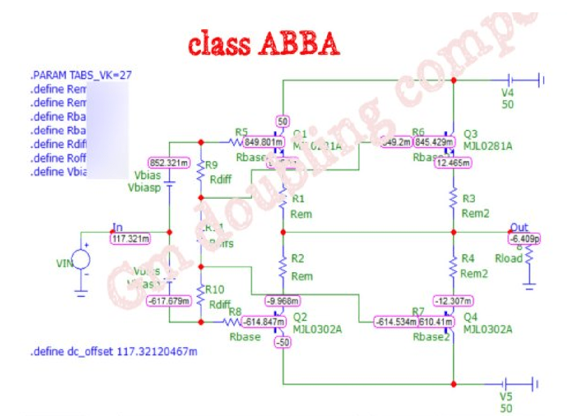

Ok, I get / understand it.

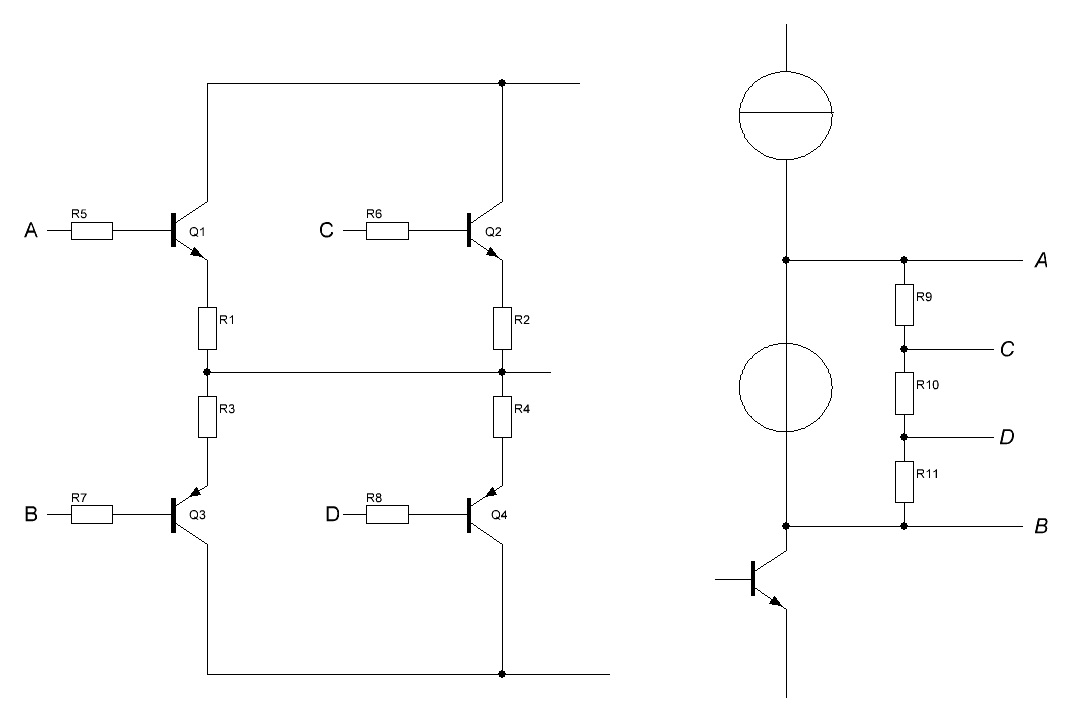

If I interpret Nick correctly, then Q1 and Q2 are not necessarily identical types in his circuit (nor are Q3 and Q4) ... without really thinking (please forgive me for this), I intuitively wrote a few values from Nick's comparison of the three published variants on the sketch! What value would R10 have to assume in order for the assumed ratio of the currents to be possible and in which decisive parameters would Q1 and Q2 have to differ?
I apologize in advance for any possible goofs in my own brainstorming.
Somehow I still can't really grasp Nick's AB-BA, while in contrast Yamaha's M2 immediately makes sense to me.
kind regards,
HBt.

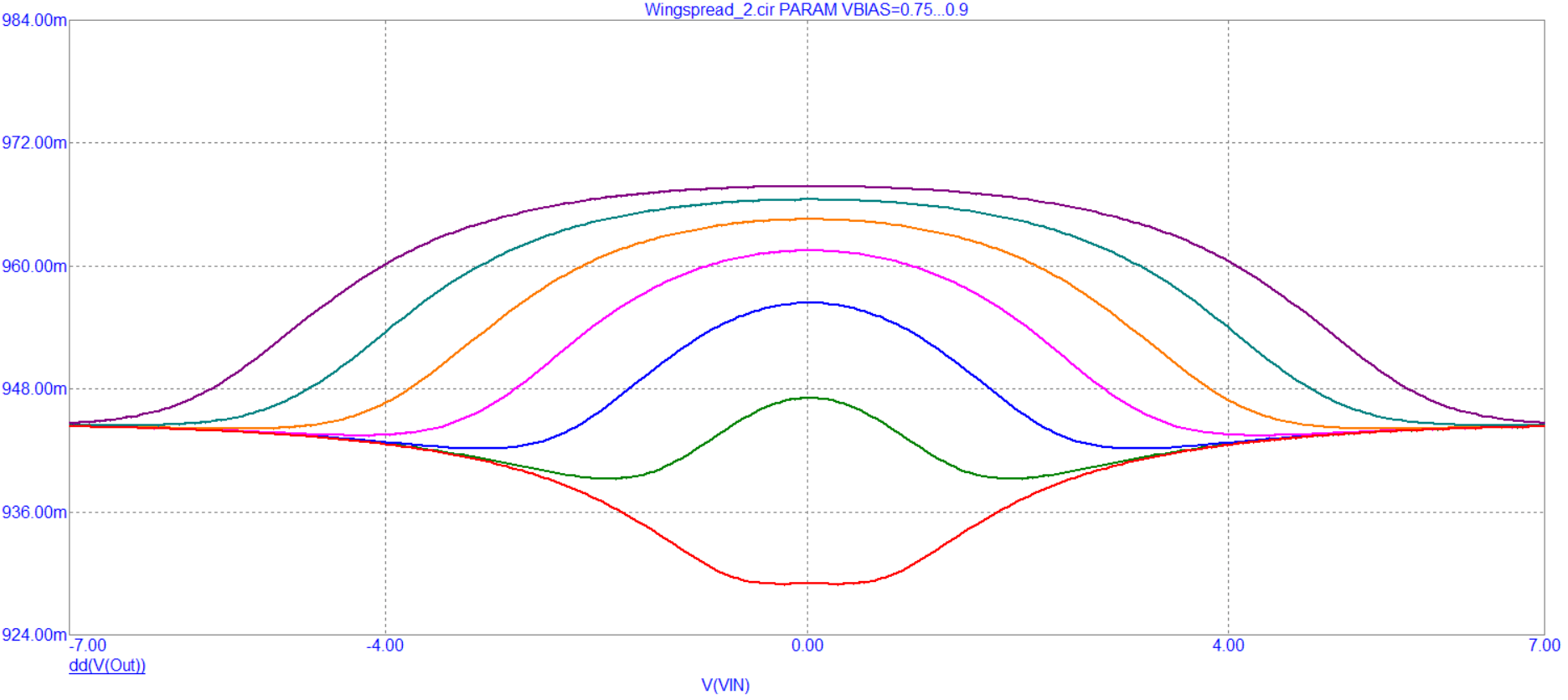

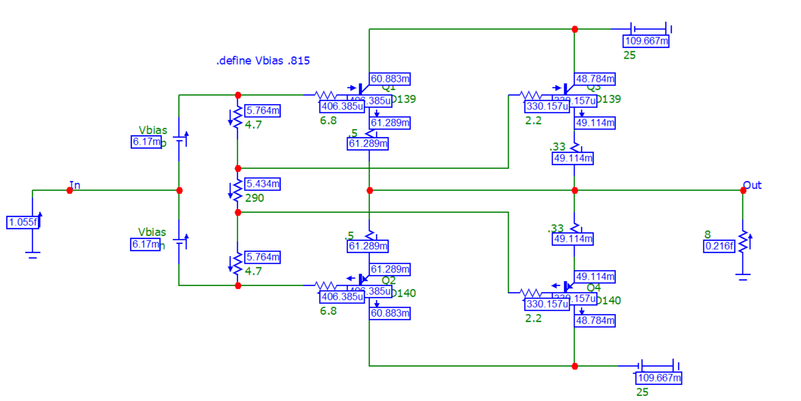

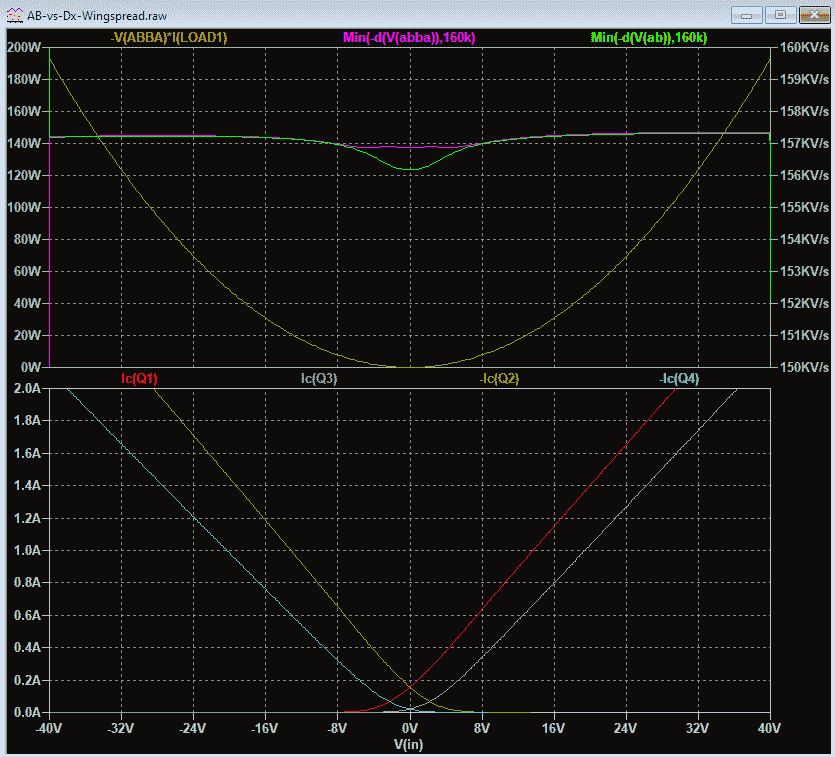

Attached 'alexcp' sim, but manually optimised for 0.22 Ohm and 0.18 Ohm emitter resistors - see the purple wingspread plot at 160mA and 21mA idle currents below (green is a standard dual stage):
The wider linear Class-A region extends to about 4 watts peak. The dual standard bias can be optimised for a flat low distortion region, but it extends to only 160mW for similar value emitter resistors. Clearly the Double Cross method has extended Class-A region of low distortion before global feedback.
But this linear region is tricky to bias and depends to some extent on optimised values for the two sets of emitter resistors. Also it assumes the optimum bias conditions can be maintained over varying temperatures of the power transistors. As far as I am aware this aspect has not been published. I was waiting for Bob Codel to do some more tests using his BC-1 (see link below), but noting so far.
I developed a spreadsheet to optimise the Double Cross and it is mentioned here https://www.diyaudio.com/community/threads/bob-cordells-power-amplifier-book.171159/post-6554056 also mentioned on my site here with the latest spreadsheet download here. It uses a solver algorithm.
I have not built a Double Cross output stage, instead I am developing an autobias amp, found here that appears to overcomes the wandering bias point of the power transistors with temperature from power output variations.
Reactions: alexcp and hbtaudio

Perhaps we should first explain exactly what a WingSpread-Diagram is. I think some users don't know that.
y(x) = m * x + b
b=0
m = constant = 1
[y = x]
or also like V2/V1 of (V1)
---> but we take the 1st derivative and expect a constant gradient factor, i.e. a horizontal straight line parallel to the x-axis (the modulation, or the input voltage).
In our case, m is always less than 1 and distorted in the transfer area -> to the right and left, one wing each, which looks like a bird in flight (as a child's line drawing).
I think, or rather suspect, that even this short fragment is not helpful in terms of DIY or an understanding of the dynamic output resistance (EF with maximum local negative feedback through the load resistor).
How do we linearize the crossover (or overlap region) and reduce the distortion (signal deformation) that typically occurs here?
What does (later) our global negative feedback do for us?
