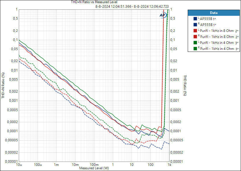

When someone has a speaker system that when this amp is connected and outputting 0,2mW (milli watts) can detect 0,005% THD+N, I will eat my old hat.
If the speaker system produces 100dB/W/m the sound pressure at 3 meter, receiving 0,2mW, will be: 56,5dB - a very low level - like a normal conversation. Now, the distortion components being 0,005% would lie a further -86 dB down.... i.e. completely ridiculously low absolute level and about 45 dB under any noise floor of a very quiet room. And surely way below any human hearing capability - even for the golden 1 ppm of the population. Even Mk4 could not hear this 😉
The same speaker system will require 150W to produce the level (@3m) of an orchestra crescendo at 3 row center which hits about 115dB.
But please show it also not only for 1kHz but also for higher frequencies and what could be revealed is perhaps not so much THD but rather perhaps N - this would adress the "mushy hash" comment above... and why not multitone...?
CompareCome on, how can anyone judge which sounds 'better' looking at those graphs?
Maybe you can mention a preference,

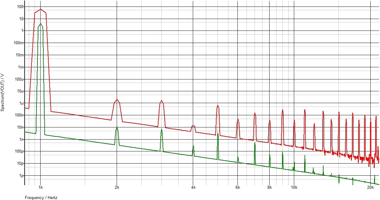

You can see in that graph that the THD+N basically follows the THD+N of the 555B. So the famous mush doesn't really seem to be there.But please show it also not only for 1kHz but also for higher frequencies and what could be revealed is perhaps not so much THD but rather perhaps N - this would adress the "mushy hash" comment above... and why not multitone...?
I have more graphs but these will be part of my review for aX.

That graph shows me typical class D amps imperfection ,I consider such class D amp that have 0,1% THD&N characteristic (which is nothing special IMHO) , regardless that in range between 1W and up to full power THD&N is much lower , also I will be interested to see what is the real level of output RF noise spectrum at full output power near to clipping or even at clipping point .
Cool - but isn't it time to leave the 1 tone analysis.. or at least complement it with multitone?You can s

That said at 1kHz things are very easy, see below for 200W in red and 1W RMS in green on 8R.

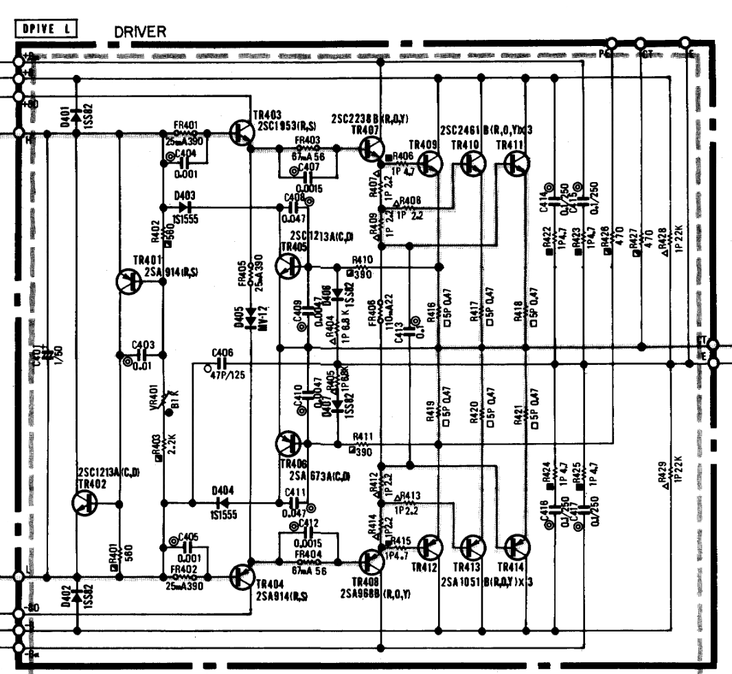

Nick's patented ABBA is but a new name for Yamaha's Linear Transfer Bias from late 1970s. The basic idea is to run several pairs of output devices at different quiescent currents. Here is an implementation example (Yamaha M-2):would be nice if you would release your schematic here
Nick uses modern transistors, and some resistors are different.
BTW there is no such thing as Gm doubling. There is a nice, if a bit math-heavy, note on this topic by Marshall Leach (attached). TL;DR, the "doubling" idea is based on an incorrect assumption that the emitter current in each transistor in an output pair is independent from the other transistor.

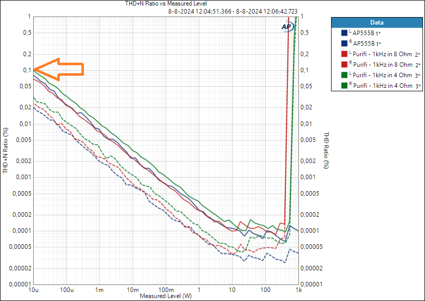

Did you notice that 0.1% THD+N is for 10 uW output level?That graph shows me typical class D amps imperfection ,I consider such class D amp that have 0,1% THD&N characteristic (which is nothing special IMHO)
Essentially, it’s just noise at extremely low level. Not even Benchmark AHB2 or Topping B200/B100 are close.

So to end the discussion maybe we should do a focus and put the microscope on the Purifi in the 0,01W-1W region... and not only talk about 1/5/200W performance...?
