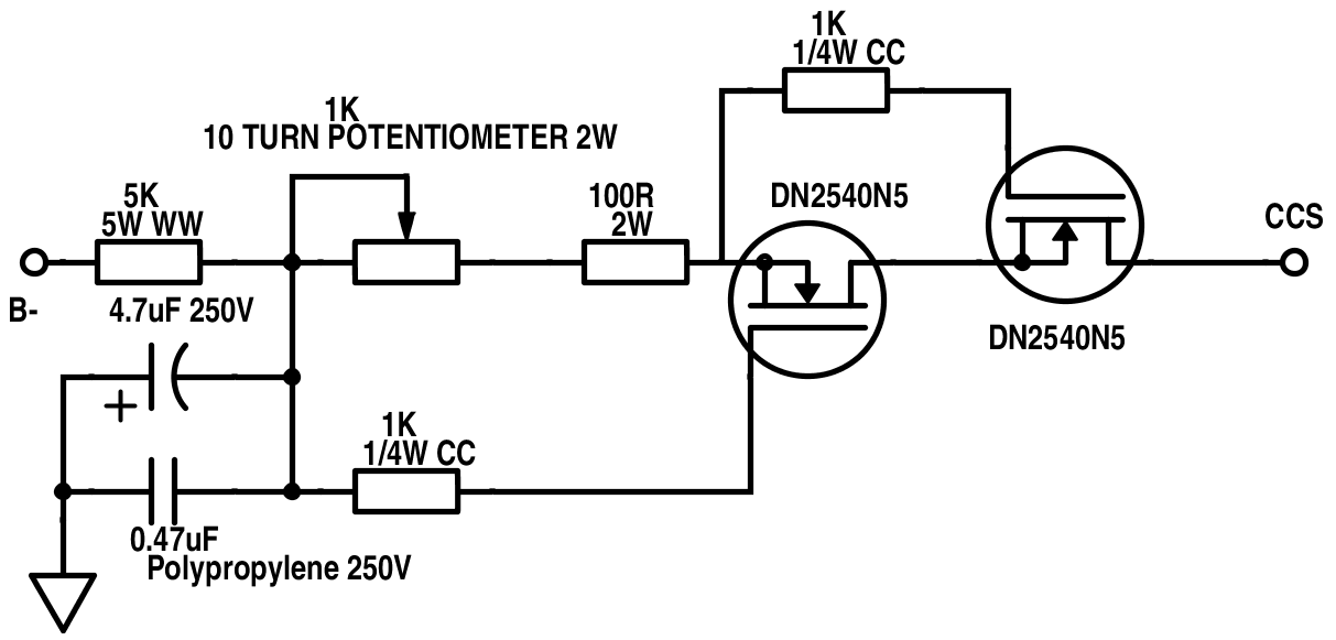

Well, half of the message exceeds my english skill 😀 I understood the Patience, but nothing more 😀

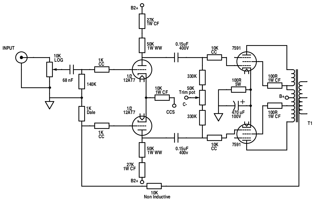

Eli is saying that the CCSs will total 6-7 mA, or 3 - 3.5 mA per section of the 12AT7. So the 100 ohm set resistor in the CCS will read 0.6 to 0.7 VDC across it, using the variable 10-turn pot to set it once it's up and running in the breadboarded amp.
Eli is saying (I think) that I was wrong to think you might want to run more current through the 12AT7. He's right.
The other part is about the voltage drop calculations that will be an estimate, not a final guarantee, of the voltages on the plates for the output valves and the 12AT7. You just won't know how the voltages will hold up under load until you have the thing wired up. Breadboarding means building the amp on the workbench with ample access to change things in and out while measuring. In other words, don't build this amp directly into a chassis yet. There are many things still pending, and you may need to change resistors, transformers, and other configurations. Many people use perforated pegboard.
For what it's worth, I think the El Cheapo CCS B- supply as shown in the schematic yields about -110 Volts under load into the two CCSs. Your build will be different if you use other transformers and a different mains voltage.
Also, if you are paralleling secondaries, it isn't really clear how you're hooking those up. Once you get the Antek transformer, you can redo the schematice to show the lead colors.

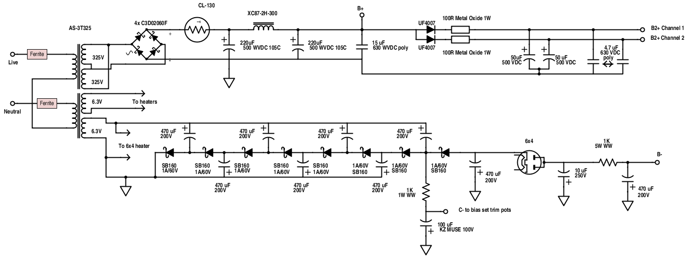

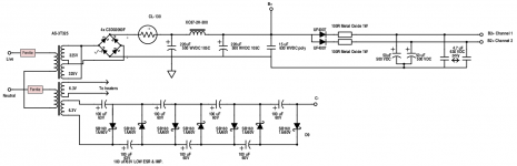

Using Schottky diodes, my guestimate is 7.5 V. per stage in a 1/2 wave parallel voltage multiplier that's energized by a 6.3 VAC winding. The bias (C-) supply should be capable of completely cutting the O/P tubes off. 7 stages should do the job. An additional Schottky stage works towards the B- rail. The final B- stage is a 6X4/EZ90 vacuum rectifier. That tube's heater is fed by the same 6.3 VAC winding as the voltage multiplier is fed.
50 PIV/1 A. Schottky diodes are definitely tough enough and few volts lower in the PIV rating is OK. 1/2 wave parallel multipliers are reasonably efficient. Everything has its price and here the WVDC rating of each multiplier stage's cap. has to increase. 100 muF. caps. in each Schottky stage should work out quite well, as that value is probably overkill. A 10 muF. cap. is used in the 6X4 stage

Now if Rongon will do some simulations of the multiplier stuff, we can begin to think about "breadboarding".
Well, I do understood the C- part, but not the B- part. what should be the plate voltage? 6.3V? I made the voltage multiplier for the C-, you can see it here.
Eli, if you would be so kind to explain the B- rail please, it would be perfect! 🙂
This is what I got:
This is what I got:

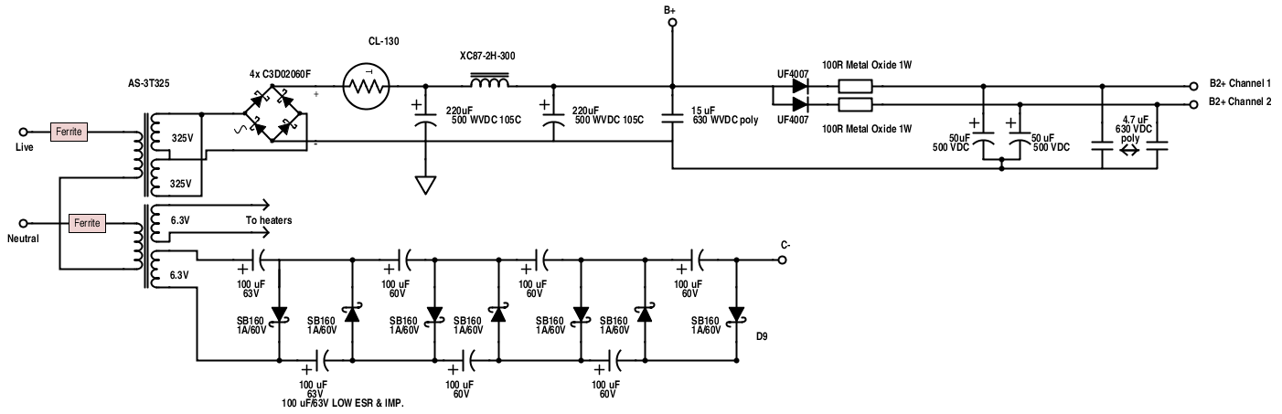

You're using the 6.3V winding for a voltage multiplier? Way cool. I'll see if I can get it to sim in LTspice...
This is the one, right? (On the 6.3V secondary at the bottom of the drawing)
http://www.diyaudio.com/forums/atta...sing-tube-amplifier-build-help-needed-psu.png
Forgive me if I'm missing something obvious, but where does this connect to 0V or ground?
I also have to put a load on the supply. What's the target? 6mA of current, or its equivalent resistance? Also, what's the target voltage for C-?
I'll be using an NXP PMEG6010AED as the Schottky diode, because it was the first 60V 1A Schottky model I found. I don't think there will be that much difference between different makes of diodes, do you?

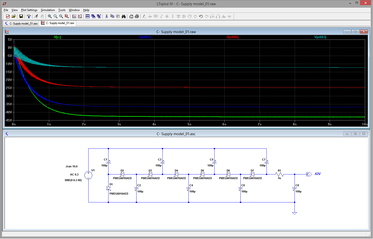

OK, here's a screenshot of the sim of the C- supply.
Unloaded (as shown), I get -42V DC, with about 300mV of ripple, peak-to-peak. That's about 100mV RMS?
I then put a 3k ohm load from C- to ground, to try to simulate a 12mA current draw (the cathode current of two 12AT7 LTP's, four triode sections). That puts the voltage at C- to -25.2V DC. Is that what you were aiming for?

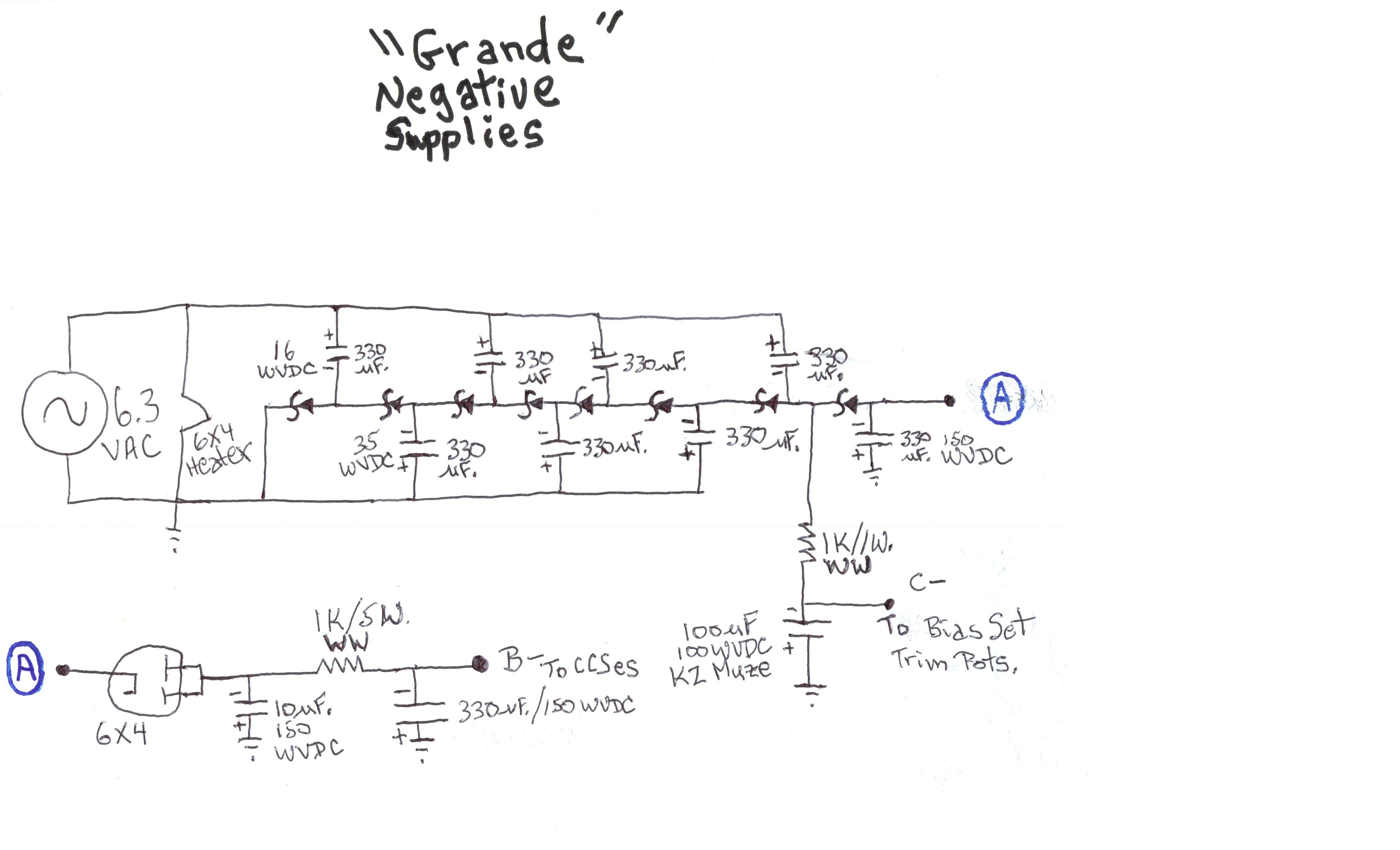

I've revised my thinking regarding the negative supplies. Remember, I upload "hen scratches", not pretty pictures.
In this version, the vacuum rectifier only serves to slow B- rise. It is not part of the multiplier. I want to be absolutely certain that the 'T7 grids never become positive, with respect to the cathodes. Small signal triodes are most definitely not rated for a positive grid current regime.
OTOH, "instant" on is a GOOD thing in a bias (C-) supply.
Notice that the WVDC of each multiplier stage's cap. increases. The stress on the diodes is identical, but the stress on the caps. rises.
I don't think that 7.5 V. per multiplier stage is an unrealistic expectation. Yet larger caps., such as 470 or even 680 μF., in the multiplier could be a good thing. Use 105o C. rated parts that also have the highest allowable ripple current rating.

I like your thinking on the C- and B- supplies. I'll throw it into LTspice this evening, to see what the program has to say about it.
I like the easy/simple way you get a slow start for the B- to the 12AT7 tail CCS's, while keeping a quick-start for the C- bias supply. I wish I had thought of that.

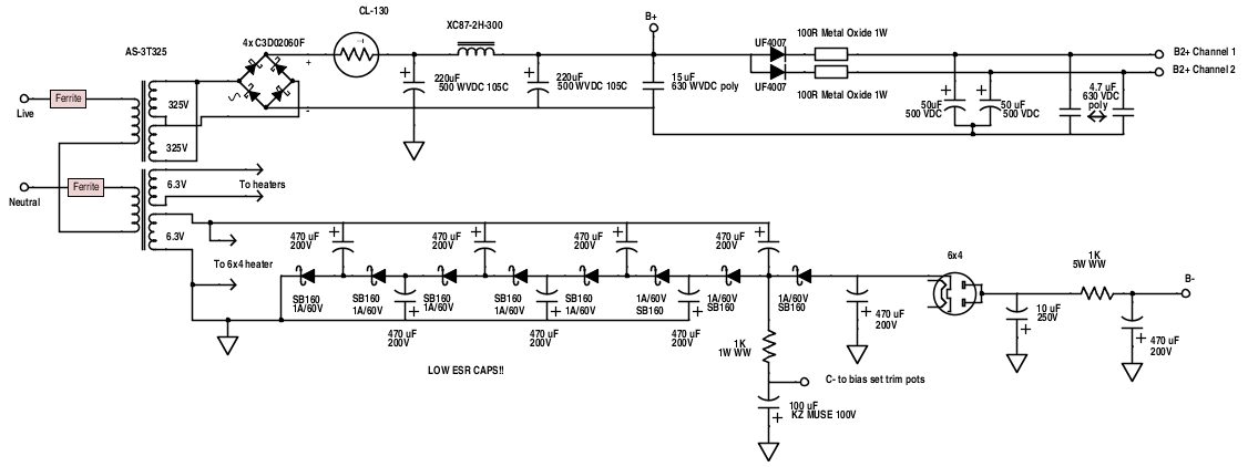

Well I made it to make the schematic, altough I have some questions:
Wouldn't the diodes voltage rating rise as well as the capacitor ratings?
Only the 100 uF capacitor has to be KZ Muse type capacitor?
I don't see any trimpots near C-... where should it be?
Is the B- cathode voltage has 8 stages of multiplying before it? Is that correct?
I made something differend though:
I used only 200V caps in the voltage multiplier, as it is really cheap here in Hungary, I can use a lot of them.

Sebastian,
It certainly is OK to use 'lytics whose WVDC is greater than a situation requires. However, there are items of concern. High WVDC parts occupy more physical space. What is the temperature rating of the parts? 105o C. parts will last longer in the heat of a tubed amp. What is the equivalent series resistance (ESR) of the parts? I said look for high ripple current rated parts, as that goes hand in hand with a highly desirable low ESR.
Even if you build with overrated parts, please put the "correct" values in the schematics. Other, future, builders will see accurate information.
Nichicon KZ series (Muse) electrolytic caps. have repeatedly demonstrated good performance, when in the signal path. The reservoir cap. of a bias supply is (you guessed it) in the signal path.
I leave it to the experts at VMI to explain the ins and outs of voltage multiplier operation.
I don't want to speak out of turn or stand in for Eli, here, but I have recently worked with a similar supply. You put the trim pots between the C- output on the supply and the 330KOhm grid resistors on the amp schematic (where you have labeled C- between the output tubes).
If you have matched pairs of 7591s, you can do one trim pot per channel, as I just described. If you want super control over matching the currents for each PP pair, you can put a trim pot at each grid for all four tubes. That may be overkill here unless you are not getting matched pairs.
Since there is little to no current at the grid, you will need to figure out the most likely value for the trim pot total resistance. You will want to strike a useful range of output voltage on the wiper of the pot. You'll want some room on the "ends" of the pot, with the wiper in the middle range for actual use. You know that the B- section at "A" in Eli's drawing will draw about 12 -14 mA plus a little for losses, and you have a 1KOhm final resistor in front of the C- takeoff point. Once you know the preferred bias voltage for the 7591A (16-18V or so on each grid for this hybrid bias scheme??), and the actual voltage at C- with the B- loaded, you can start to calculate the pot as a voltage divider.
This may sound complex, but you can get close enough fairly easily. You can breadboard these C- and B- supplies and load the B- with enough resistance to simulate 12-14 mA and then go from there to figure a good middle value for the pots, using the actual output voltage at C-. You will want to build a loop through the bias pots that returns to ground, passing a small value of current (1 - 2 mA). The wiper becomes the voltage divider and runs to the grid resistors. Use high wattage resistors for loading the B- supply, since they will get warm! You can parallel or series what resistors you have on hand to configure this bench test. For starters, if you aim for about 25VDC at 15 mA, you get about 1.8K for a load resistance, less if the goal is higher voltage.
Regarding the diodes, as long as they are rated well over the output voltage, just use the same ones throughout the C- supply. I would think that 50-100V PIV Schottkys would do fine if we're looking at a 30-40 VDC supply. Eli mentioned 50V PIV earlier in the thread.
Oh, and for the bias pot loops, note that since you're returning to ground, the pots will be in parallel with respect to the C- output and ground. Consider than when sizing them for a given current choice in the loops and your desired voltage range.
25 PIV diodes would probably be quite fine in the multiplier. (6.3) (21/2) = 9.3, which does not look threatening to me.
Only a single trim pot. is needed in each channel, for this combination biased setup. The RC bias network each PP pair "stands" on compensates for minor cathode current imbalance. PP O/P tube pairs MUST be closely matched in the gm dept., but biasing arrangements impact on how closely cathode current needs to matched.
The total B- draw is 12 mA. If C- draw reaches 4 mA., it will be a surprise. A 50 V. rail and a 50 Kohm trim pot. works out to 1 mA. 😉

Also, I modified the El Cheapo Grande Schematic in a way that the trim pot is now inside that!
See everything you guys made up until now! If there is something, please let me know, in terms of capacitors.
